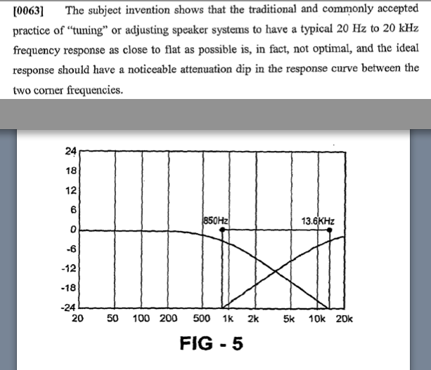

As far as I can see based on this thread (I haven't had chance to look elsewhere), it seems to be an advocating taking a 1st order HP / LP & pulling them apart by x amount to introduce a large dip in the midband FR / power response. Shades of the so-called Solen-split variation on 1st order, where they've put the XO at the -6dB rather than the -3dB frequency, except there the object isn't really to cause a dip & what there is is relatively small, all other things being equal ~1.5dB.
Check out Mr. Knight's UK patent # 2445695 for a detailed explanation. I found the patent as written was dissapointing. How can one make a claim on a decades old method of calculating the mH valued on a woofer coil? How can an examiner award a patent when no utility is demonstrated? The only novelty (and that's a stretch) I found was a modified formula for calculating a tweeter's uF value included "CM" - a factor for adjusting the spread of the xover slopes.
I had a few spare minutes, so I looked through the UK & US patent / applications. So, correct me if I'm wrong here, but essentially what we're dealing with is an extension of what Solen-popularised. Regular 1st order Butterworth has the XO at -3dB. Solen's 1st order variation (presumably also done by other people before them too, but a convenient handle) crosses at -6dB. And this one is at -12dB.
Quite easily re the patent grant etc. I've seen things that are a far greater stretch being patented. US Patents No. 6486750 and 6025810 for e.g. Or any patent produced by a hifi wire company come to think of it. 😉 I can't say the design philosophy advoctated here of deliberately creating an enormous hole in the midband frequency / power / amplitude / whatever response appeals to me, but live & let live.
Ahh, but Mr. Knight's contention is the dip counteracts the rise in our normal hearing profile shown to increase in the 1-3 kHz (typical 2-way xo) range by Flethcher and Munson. Other claims of lower distortion in the xo region caused by the Basilar 'beating' effect go unproven other than subjective assertions. The problem is - where's the test data to proove any of his claims of sonic improvements? No doubt the method claims to produce the dip are defensible, but the rest..... not so much!

If the goal of a speaker designer is to make a speaker that reproduces recorded music accurately, the last thing one would want to do is put a 12 dB response dip at the ear's most sensitive frequency.Ahh, but Mr. Knight's contention is the dip counteracts the rise in our normal hearing profile shown to increase in the 1-3 kHz (typical 2-way xo) range by Flethcher and Munson. Other claims of lower distortion in the xo region caused by the Basilar 'beating' effect go unproven other than subjective assertions. The problem is - where's the test data to proove any of his claims of sonic improvements? No doubt the method claims to produce the dip are defensible, but the rest..... not so much!
It will be interesting to see how Ian defends his assertion that flat frequency response is not optimal.
Flat where, tho? At 1M, at the ears, at a mic? Somewhere in the room? As we know, it gets complicated.
flat on axis in a semi-reverberant field is not the best. I read the patent too, well, there are a lot of subjective assertions there, it's dissapointing. Proofs, any? Also it says in case of a 3 way, same crossover applies. Really? Another dip in the mid-bass? I guess people who have active crossover facilities can try and report.. but I am far from being convinced!

The patent's text starts with an IMHO completely wrong assumption: They suggest that one should have a hole in the frequency response in the area where the ear has increased sensitivity due ear canal resonance.
Well - we are used to hear like that ! We hear all unamplified and natural sounds including this hump in the ear's response. It is nothing more than natural. It simply doesn't make sense to "iron it out" in an artificial reproduction.
Maybe only 6 if the phase is just right😀
There was a BBC reference that showed that a continuous treble rolloff was preferable to flat response with a hole at the crossover. A large dip at crossover magnifies the impression of a divide betweeen the elements.

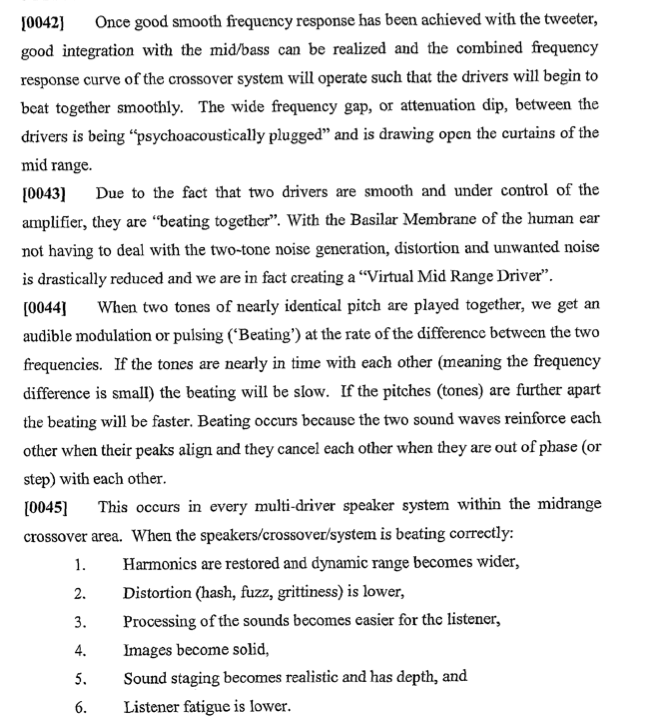

I fished the patent out of my trash so others won't have to bother down loading Ian Knight's masterwork.
"With the Basilar Membrane not having to deal with the two-tone noise generation...."
It is a good laugh, don't drink anything while you read it 🙂.

Thanks for that Art. Pure BS to think that crossover impacts beating. As long as the frequencies are preserved (of course they would be) gain is equal for both tones (brought into question with his design) then the beating rate and depth can not change. Even phase shift will only shift the "phase" of the generated beat.
Still no connection to the Basilar membrane that I can see. A good example of technical obfuscation, it sounds plausible and tech-ish.

It's got plenty of company on that score, alas. 🙄 I mean, I've no problem with people having a huge hole in the midrange response of their speakers; fair enough if that's what they like. But now I've gone through the two patents etc., I was struggling not to laugh out loud.
