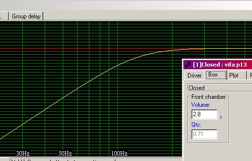

Hi Rob,
I initially planned to use sealed boxes for the midrange. However, after running some simulations I found out that the mid would start falling off at around 200Hz, this is a little high in my opinion. I really did not want to crossover the sub this high as it would cause problems with the stereo imaging etc.
Hence, I went along with the vented mid option.

Vifa P13, sealed box sim:
F3 is ~130Hz Add another 12dB slope at 130 to make 6dB down, will match with 24dB Linkwitz Reilley on the sub.
Rob
Rob
Hi Rob,
You are completely right. My simulations were exactly the same. I did however go for ported deisgn as I wanted to get a lower x-over freq. When I get my hands on the digital x-over I will try sealing up the boxes and compare sealed vs ported designs.

Ninfendo said:I initially planned to use sealed boxes for the midrange. However, after running some simulations I found out that the mid would start falling off at around 200Hz, this is a little high in my opinion. I really did not want to crossover the sub this high as it would cause problems with the stereo imaging etc.
You have to be careful... even thou the BR may get you a lower F3 it is unlikely to get you lower F10... the aperiodic box gives you a bit lower response than sealed, with less back pressure, but with transient response similar to -- some say better -- than sealed.
And in your case it is close to free to play with stuffing the vent to see what sounds best.

Ninfendo said:You are completely right. My simulations were exactly the same. I did however go for ported deisgn as I wanted to get a lower x-over freq. When I get my hands on the digital x-over I will try sealing up the boxes and compare sealed vs ported designs.
I think you may find that what you lost to get the extended bass response in terms of group delay, and a 4th order roll-off at the bottom means that a higher XO is actually required to get a seemless transition...
I guess i should quit hammering the point... once you try it you can make up your own mind.

Ok, point taken.
Will try with normal ported box, stuffed port and sealed. Will use a 2-nd order filter for all, but at different frequencies of course.
You could always try a linkwitz transform on the mids to squeeze out a half octave if the xo freq is so important. I ~believe~ this will do less harm to group delay etc than a port.
Still going to have trouble keeping up with the jbl though. (max spl will suffer)
Rob
Rob
RobWells said:You could always try a linkwitz transform on the mids to squeeze out a half octave if the xo freq is so important. I ~believe~ this will do less harm to group delay etc than a port.
Rob
Hi Rob,
I'm sorry if I wasn't clear before. The Plan is currently to use two linkwitz for the sub at 80 Hz, this will thus yield a 24 dB/octave falloff.
The midrange is currently tuned to around 75 Hz so they falloff naturally with 12 dB/octave. I will on top of this add another linkwitz highpass filter at 80 Hz. The combined falloff will thus be 24 dB/octave for the midrange. This filter will make it much easier for the poor Vifas to keep up with the JBLs
Hence, both the sub and mid yield a falloff of 24 dB/octave at 80Hz, that's the whole point with my vented midrange.
