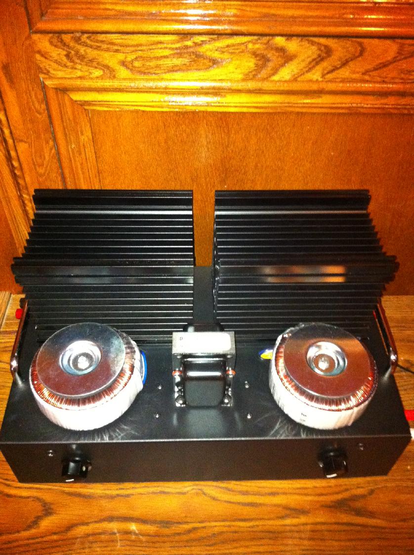

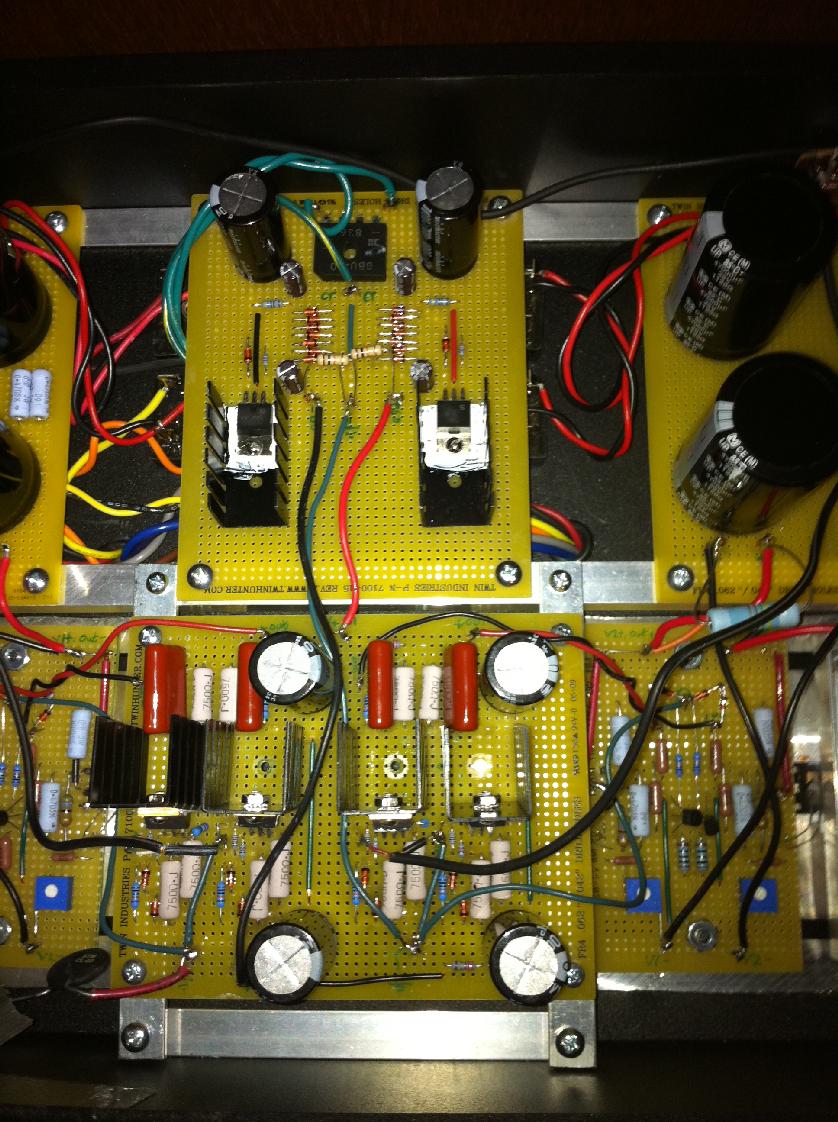

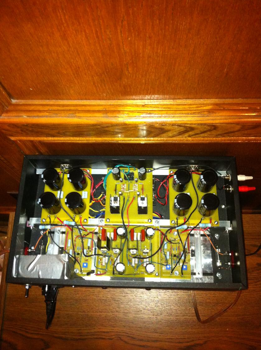

Here are a few pictures. It's a bit of a utilitarian construction, but it works, which is the main thing!Chris,
Can we get some pictures?
Gyuri
Chris

We thank you for the pictures, Chris!
I think it is a very nice job.
Your tube amplifiers were the samples for this work?🙂
Gyuri
Gyuri

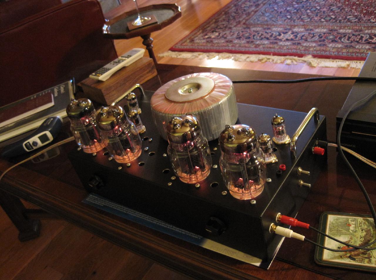

Many thanks for the comment! By the way, I've now determined that the hiss I reported hearing is entirely due to the linestage preamp; the circlotron itself is absolutely silent.I think it looks fantastic.
Gyuri: Well I suppose I did more or less copy the construction style I used for my OTL based on Tim Mellow's design:
Chris

Well, Chris, you're a true artist of DIY.Gyuri: Well I suppose I did more or less copy the construction style I used for my OTL based on Tim Mellow's design:
Chris
