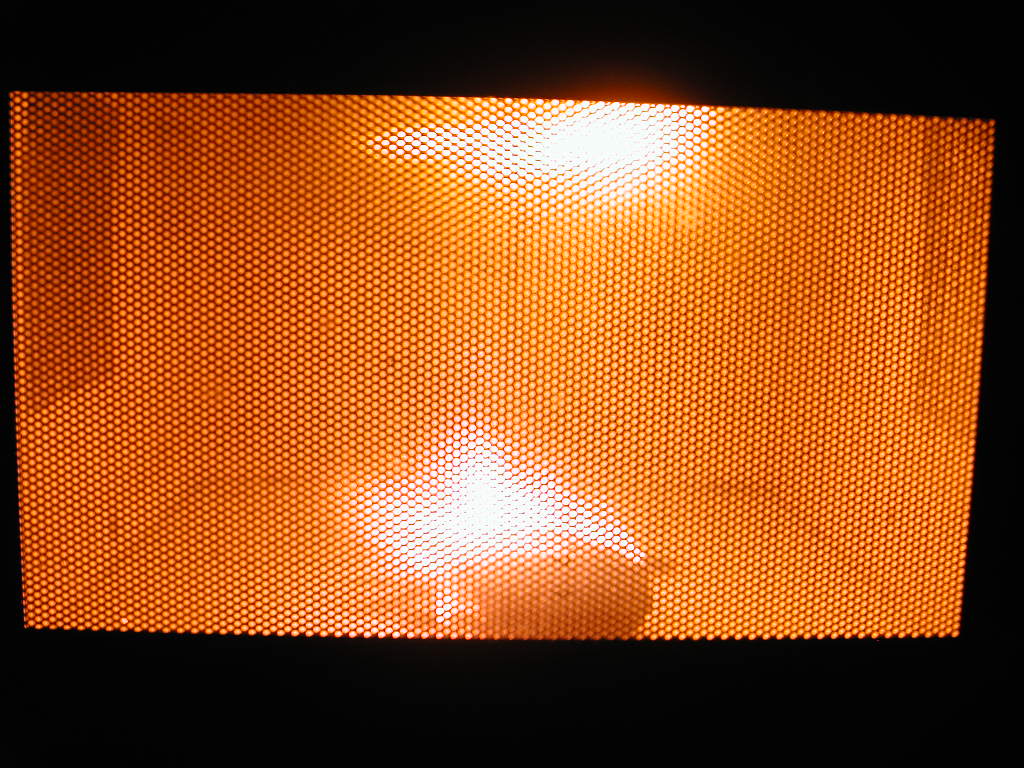

Here is a favorite that upheld my "blow stuff up" reputation.
A high level manager gets a Nextel phone back from Nextel with burn marks on it, and has a mid level engineer open it up for inspection. Upon finding more burnt stuff inside, she shuts down the entire production of ALL Nextel phones until this "serious safety problem" is investigated and rectified. The line shutdown is in it's second or third day when all of engineering is shut down and called upon to solve this issue.
A high level meeting is called at 8 AM for all engineers above a certain pay grade, including me. Some twit that talks a good story but does not understand basic electricity has prepared dozens of slides with everybody's theory of how this could have happened. There are pictured of traces burnt off the board, the flex circuit with similar burnt spots, even a burnt spot in the display. Dozens of schematics with circles and arrows pointing out how a certain combination of coincidental component failures could possibly do this, at which point I cried BS! The battery has an overcurrent safety circuit inside that would not allow enough current to blast runners off the PC board. You could not put enough current into an LCD display to make a black spot inside it.
There was a common thread amongst the burnt stuff, each one was about 30 mm from it's neighbor. This IS the strongest clue. I demanded to see the actual phone that was sent back, so someone fetched it. I took one look and proclaimed that it had been nuked in a microwave oven.
The queen bee who had shut down the factory told me that this was serious business, and I should offer a real opinion as to what caused the failure or shut up. This meeting degenerated into an arguing session, then several chest thumping sessions between different tribes as to which of the popular theories as to what caused the failure was correct. I and a few others had real engineering explanations as to why NONE of them were correct, but they were ignored. A plausible explanation was needed so that production could resume. More and more "experts" were dragged into the meeting, which had gone on well into lunch time with no useful conclusion. Most just added to the chaos, but one agreed with me that it had been nuked. At this point we were both dismissed as not serious and told to leave.
I walked directly to my desk, grabbed an identical phone and a screwdriver, headed to the break room, tossed the phone into the microwave and zapped it. I got some serious looks from the software engineers present in the room. I then went directly back to the meeting, made sure that I was noticed, slapped the phone down on the table and proceeded to take it apart.....a stink of burnt electronics filled the room. My phone had identical burnt marks in nearly the same places, all about 30mm apart.
When someone asked how I did this, I simply replied "20 seconds on defrost." After a lengthy explanation of how a microwave oven is actually a 750 watt radio transmitter on 2450 MHz, and the 30mm spacing of the burnt marks are a quarter wavelength at that frequency. My theory was accepted, the factory was turned back on and most of us went out for pizza.
I would not expect a high level manager to understand this, but I would think that at least more than one out of 35 or so electrical engineers in a company that specializes in RF engineering to understand what happened.

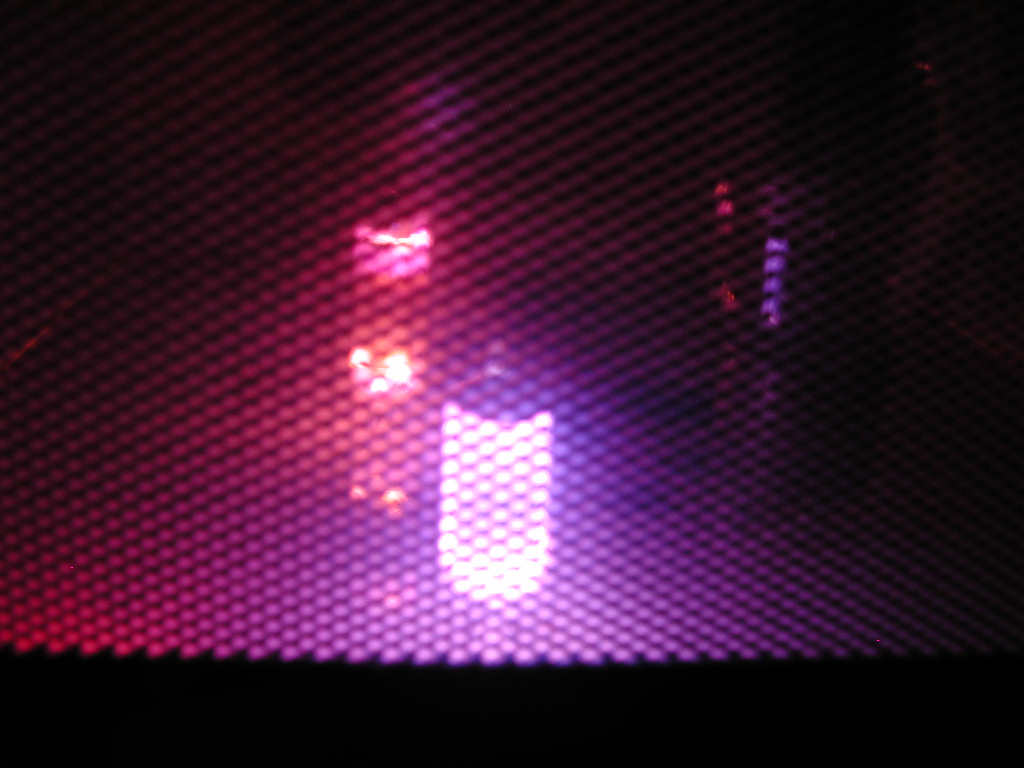

I guess that nobody in that room had ever done this:
