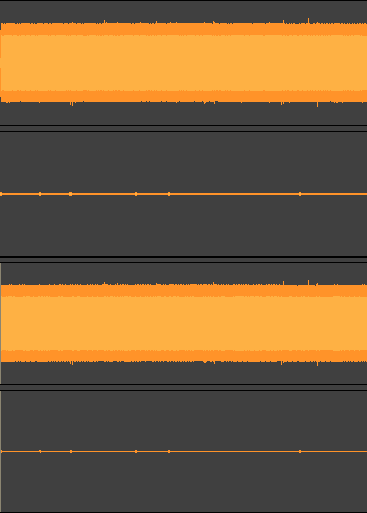

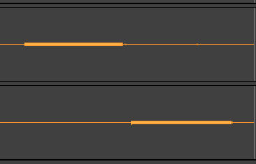

I ran your test track through the ffmpeg declick, then I imported the original and the declicked version into audacity so I could use the "solo" feature to switch between the tracks. What I find really fascinating is that the residual noise (original file subtracted from declicked file) contains only really sharp transients that by themselves actually sound exactly like clicks from an LP. The declicked version sounds softer but is still very listenable. I bet this result can be improved upon by tweaking the algorithm parameters a bit. In the mean time, I'm quite impressed - especially as this is only the default setting.
Original audio and declicked audio
Original audio and clicks deleted by the algorithm
Code:
ffmpeg -i ~/input-file.flac -af adeclick ~/input-file-declick.flac
[Parsed_adeclick_0 @ 0x55c72d7f3b00] Detected clicks in 1952651 of 33147912 samples (5.89072%).

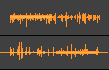

I did some tests now that the Flying Cowboys LP arrived:
The declicker works a lot better on the LP - the residual noise does not contain anything like the faint robot voice that the algo extracted from the CD version. This time it was transients only - but not as many as from the CD. It did get the few clicks that my pressing has.
Too bad that I could not get the declicker to only suppress real clicks and leave the drums alone during the short time I had to test. I changed the threshold and switched between the "overlap-add" and "overlap-save" method. To be honest I'd have to listen again with my IEMs to spot a difference between those two. My laptop speakers gave me no clue.

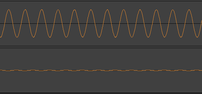

I went back to the file with the residual noise that the filter removed from my Rickie Lee Jones needle drop. Looking closely at the 'false positive' clicks I noticed that they were exactly on the beat of the music.
After some googling the program called aubio came up. Among a lot of other things it does It can take a piece of audio and print out the timecode of every beat. I can even tell it to look specifically at the onset energy :)
This command ...
Code:
aubiotrack -O energy -i rickieleejones.wav
... will do the trick and the timestamps that this command prints out line up perfectly with the false-positive clicks.
Now I need to figure out a way to have the declicker mute itself a few samples around the timestamps that the aubiotrack command detects as the beat. This way the amount of false-positive samples could be greatly reduced on any music with drums.

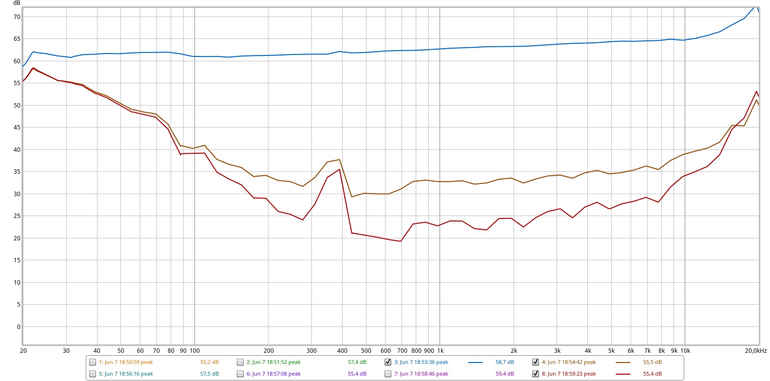

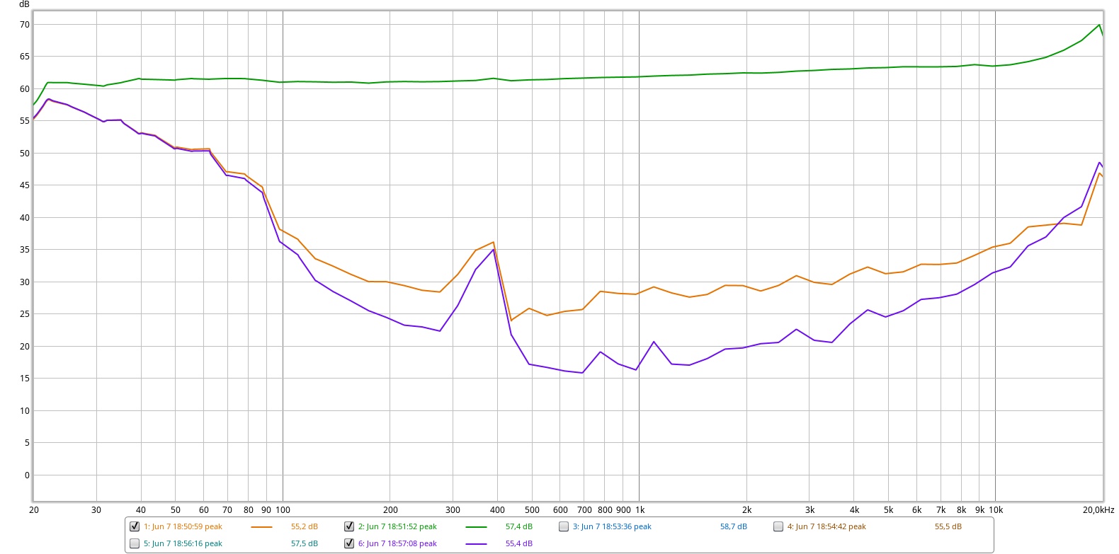

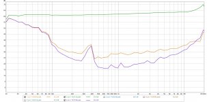

As all the graphs were done with simple peak hold, both graphs show absolute worst case behaviour. Of course K2 looks insanely high but I don't think this aspect has any practical relevance. What I do find interesting is the 80dB difference between the +18dB peak and the noise floor at that same frequency. More than I expected, for sure.
What the graphs I mentioned also show is that with low frequencies the groove noise is barely a few dB louder than the LF noise generated by the amplification in the Realtek chip.
During regular listening this was not as obvious as it was when listening to some needle drops with my IEMs. With the IEMs it was clear that on some records the groove noise was louder and on others the low frequency hiss from the gain stage was louder.

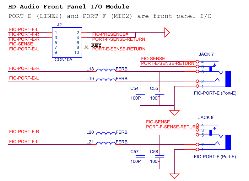

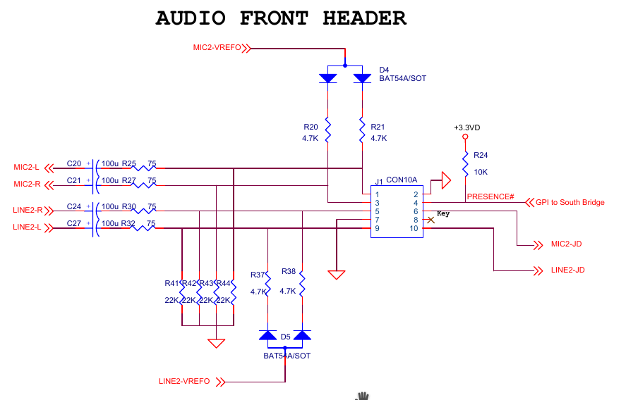

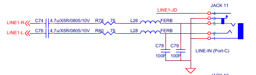

Hi, there. I am starting on electronics and maybe you could help me a bit ? I have soldered an SPDIF output on a Realtek ALC662 microchip. I did not realised I had to put some semiconductors into the wiring but it Its seems ok to do it straight, the driver sees the output. I tried to do the same to get a "line in" imput but it does not work : the driver even don't show it into the software mixer. I have just connected Left and Right channels to pins 23 / 24 and I took the ground from the USB / metal case of the Shuttle mini ITX. Is it not working because I had to put resistors ? Or should I have connected another pin for jack "recognition" ? I attach a part from the chip PDF that shows possible wirings (ignoring what kind of coil are those L things) All help would be much appreciated ! I'm new here .. Thanks !
Very cool that you managed to add SPDIF to the ALC662. Would you mind sharing some more details on this? What motherboard was this? What components did you add?
It might make more sense to do this in a new thread, as this one is pretty old and was originally about vinyl playback through realtek chips.
I think that you are probably on the right track concerning the jack detection feature. The chip would need to know that the port actually exists.
