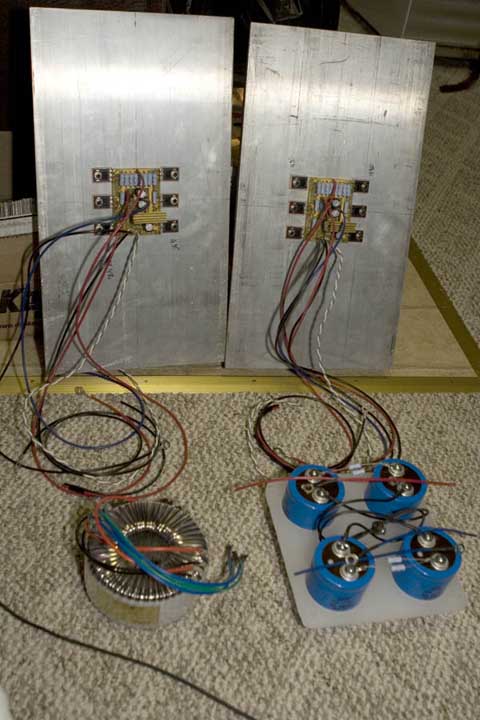

I don't see a problem with wiring only 3 fets with the other 3 soldered directly to the board.
As to the gate resistors, I'm not sure. It may depend on the length of the wires: if they are not too long, leaving them on board should work fine too, I guess.

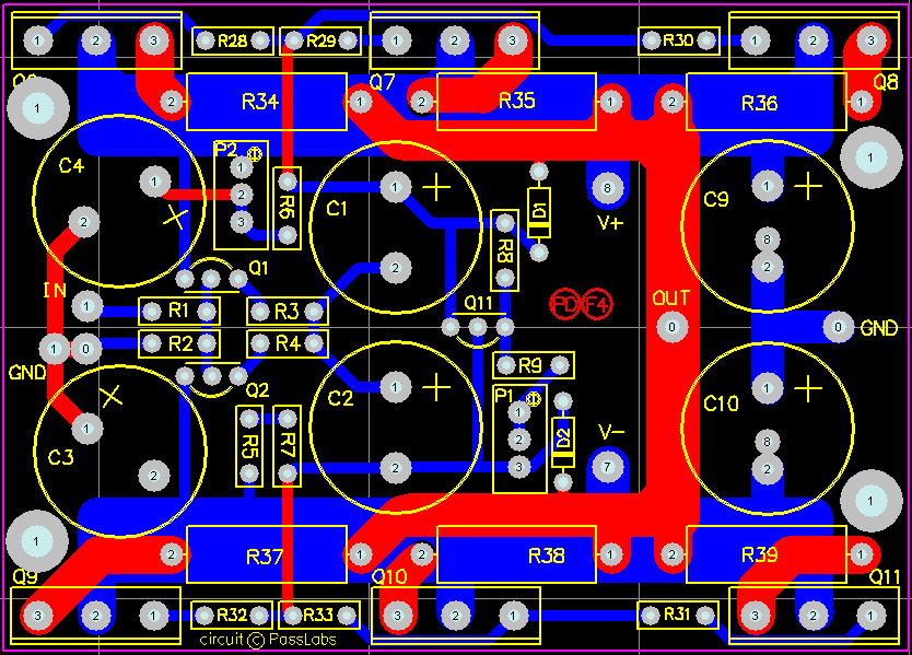

Are the jumpers show in http://www.diyaudio.com/forums/showthread.php?postid=617068#post617068, necessary?
Thank you,
Peter
Thank you,
Peter
Peter,
I mean the jumpers shown on Post 134, with the zero-ohm jumper and the shield wire. The board shows a line for those, are they necessary for normal operation?
Thanks,
Peter
Thanks,
Peter
Yes, those jumpers are neccessary as they connect signal to gates of output mosfets. Without them the amp will not work.
Thanks, Peter!
6 hrs ago, I first applied power to my boards, but it showed that it was drawing more than 2 amps with a short somewhere. Checked once, twice and felt dumb. Never thought of those jumpers, but Peter you saved the day!.

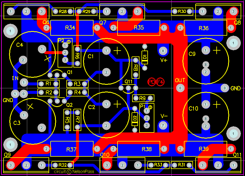

Wow, that looks really small! 😉
Any particular reason for R31 being connected to gate of Q10 or is it just a minor bug?
cviller said:Any particular reason for R31 being connected to gate of Q10 or is it just a minor bug?
It is a minor bug, but thanks for pointing that out. It's 4:30 AM here so I may not be as sharp as usually 😉
The size is small, but that layout worked successfuly with A30 so it should work fine with F4 as well.
Peter Daniel said:
It is a minor bug......
Hi Peter,
It also looks like you forgot to connect the - of C3 to the junction of R7 and R5.
Marcel.
Tarasque said:It also looks like you forgot to connect the - of C3 to the junction of R7 and R5.
Yes indeed, thanks.

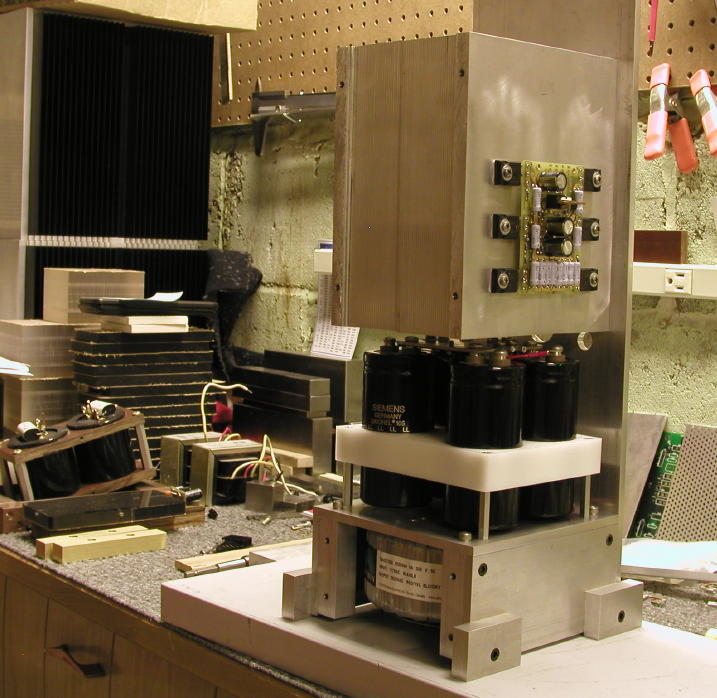

I am very pleased with making the f4 the same foot print ,I am building an A30 on a similar heat sink . I was going to buy some copper blanks to move boards around on it but this will negate the need, thanks. My current A30 has A 600 kva 18V transformer with 4 47,000 uf capacitors and 2 2mh coils (14 gauge) they are running (the chokes) 70 degrees C. Do you think this is to hot?
