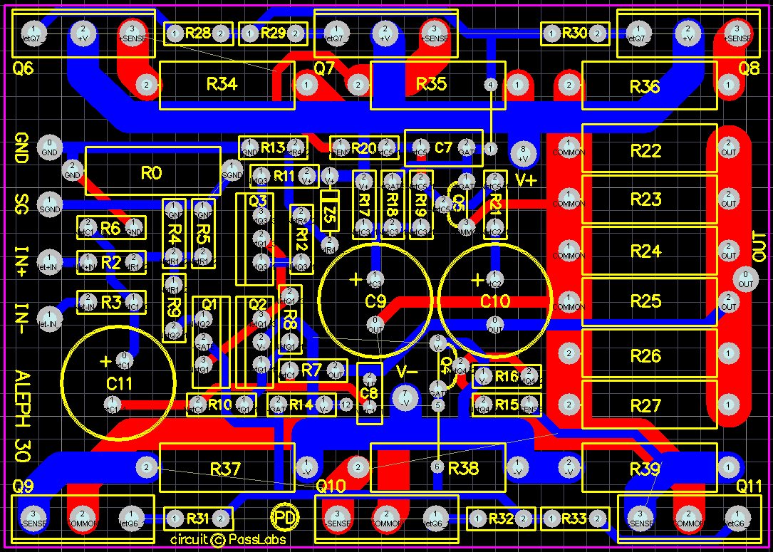

I never thought I would ever come up with Alep layout, but ever since I've read about Pass Shoot Out In Salt Lake City, I somehow got excited about building another Aleph.
Brian was kind enough to send me the library files of his board, and I just couldn't resist the temptation to play with a layout a bit. Of course, I had never mini in mind and was aiming at Aleph 30, on one board, with minimum size.
So here we are, the size is 2.4" x 3.35" with power traces width 140mil, which should be enough for such small board. There are 6 output devices on board, and balanced inputs. All power resistors are 3W Panasonics. There is no protection diodes though.

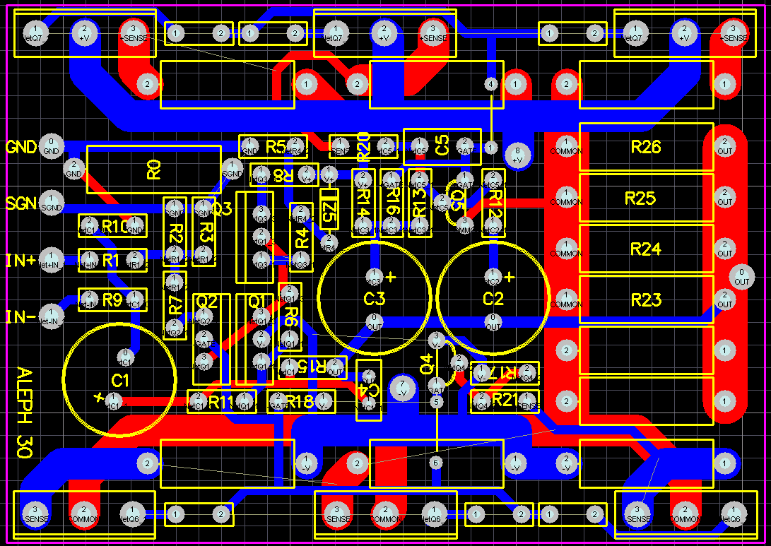

Brian just sent me the components library, something I still don't know how to do myself.
It took me almost 2 full days to come up with that layout. It still needs some fine touches (and checking for errors).

Those lines show nets, since I forced A30 on a Mini schematic, it is normal, as I didn't really go by the nets, and I didn't bother to clean them up. Those lines don't show in PDF printout.
It also shows that I didn't go with autorouter, but optimized traces manually 😉

rabstg said:Correct me if I'm wrong, but it appears that Peter's PCB is for an Aleph 30 and Brains' are for an Mini-A driver board with the "option” to expand to an aleph 30 or....
If that is the case, then Peters PCB should be a separate thread for the "integrated package" amp builders and Brian/Jason's PCB should continue as the versatile build any model thread.

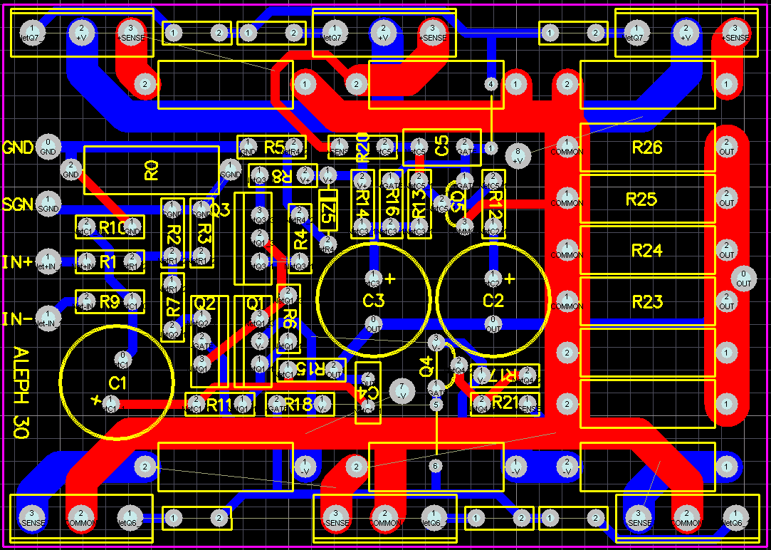

I hate to point that out, but if you mount only one pair of output devices on my board (and 6 less power resistors), you will have Aleph Mini with a board measuring 2.4" x 3.35".
If you mount 3 pairs of output devices and 6 more power resistors, you will have Aleph 30, with a board still measuring 2.4" x 3.35".
If you don't mount any of the output devices (nor any power resistors), you will have front end board, good for any Aleph, with a size still 2.4" x 3.35".
All the power traces are 140mil, and are substantially shorter (in higher power application), as no additional wiring is required. This simplifies not only the assembly, but signal path as well.
If you are concerned that heat distribution might not be sufficient enough because devices are spaced too close together (which I doubt would be a problem with Aleph 30), you can still spread them further apart by attaching pieces of wire.
One additional feature in my layout is thermal coupling of input differential (as they mounted back to back, with their tabs connected), to reduce DC offset drift.

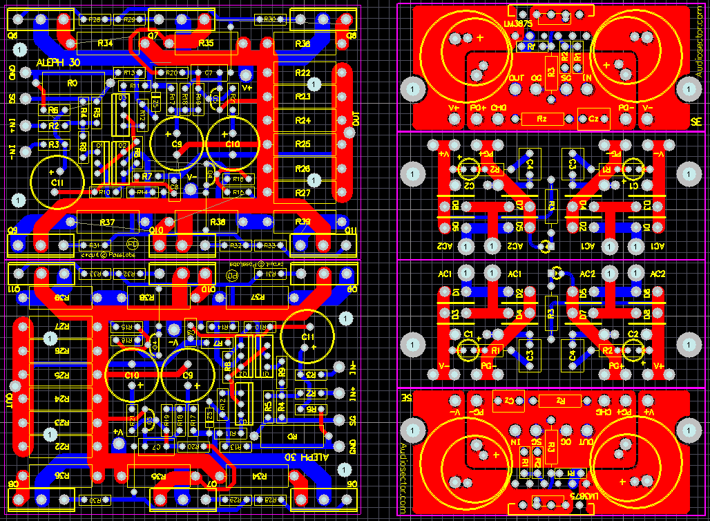

Personally, I don't think Aleph Mini should be priority in this GB. As good as it might seem, it's still very low in power, and recent Salt Lake City shootout indicates superiority of Aleph 30.

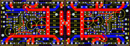

Now, what I'm trying to present here, is two channels of Aleph 30 in a package similar to LM3875 kit board. Of course PS is not on board (in case of Aleph), but only because of different requirements.
Building this Aleph shouldn't be any different than building a GC, as only one board is used, no additional wiring (that might complicate things), and small size allows variety of applications, with heatsinks being less of a limiting factor (as one can use smaller heatsinks with fan).
This brings PassLabs design into new territory, and I myself, would be very eager to try this Aleph. I made few Alephs before, but because of bigger boards, large number of devices, and complicated interface between devices and main board, I had a feeling I couldn't really reach full potential with those amps. I hope this board, with minimalistic approach to routing, where each connection and trace is short as can be, might make a very good sounding amp, an amp that could satisfy everybody who so far was not convinced about a GC.😉

There is still more possibilities. If one uses two of those boards in parallel (with front end components on one of them only), we are getting into Aleph 2. All you have to do is connect together gate and source bus lines (on both boards), while PS wires would be run separately and outputs tied together. Pretty sleek isn't it? 😉

Actually, the pcb layout that I started and provided Peter the schematic files is exactly the same, except that the output devices are wired onto the main pcb, rather than on output boards. The idea was a scalable Aleph, rather than sticking to one particular one. Peter's A30 board is also scalable now and also can accept driver boards now.
Brian
Yes, it is true.
I can also ad that I would never touch it, if Brian didn't send me the schematic files. Having those, I got excited by the idea of creating a new Aleph pcb layout, a layout so compact that it would reflect GC approach. I simply couldn't help it and spend two days working o that layout.
