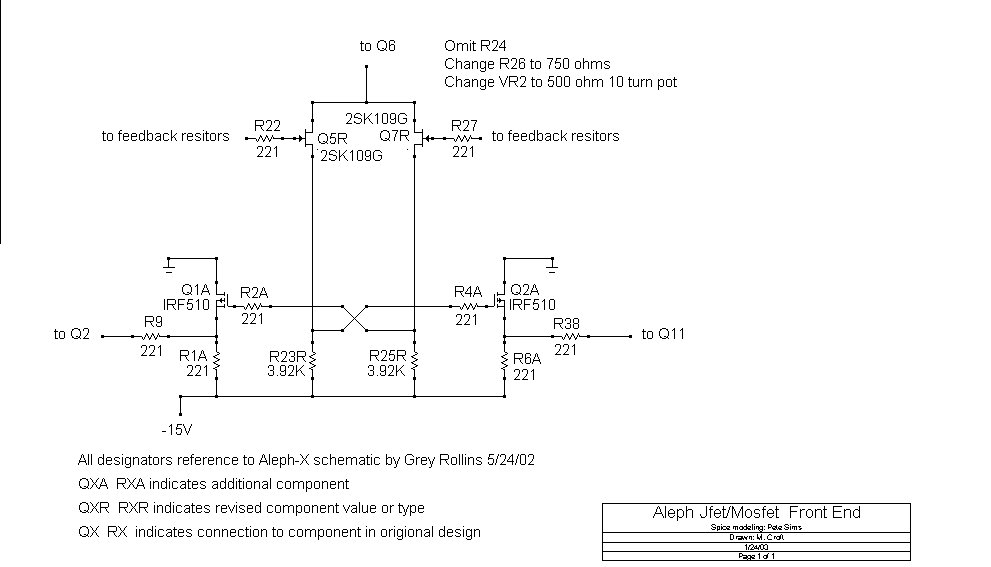

Hi all Guys!
Just to know if someone measured the output impedance of the AlephX as Grey posted originally.
In my simulation it's pretty high, but I don't know if it's real or not...
I know that you can say me: "Hey, build it and measure it by your own from real" but I'm still on the way to build an AlephX so... :clown:
TIA
Fabrizio

Re: Re: Output impedance
Nelson Pass said:
What figure did you get?
Hi Nelson!
I got 0,75 ohm with 2 couples of out devices
Obviuosly if I add devices the impedance goes down to almost 0,25 with 6 couples of devices.
It seems strange to te, as I measured the out impedance of another Amp I built (but with bjt) and with 3 couples of devices the impedance was almost not measurable.
I don't know if this is a problem with the simulation with mosfets instead of BJT, that's why I asked the forum.
Bye! Fabrizio

I recall the output impediance of the amp can in fact be measured electronically. It sort of like seeing if the amp is a perfect voltage source.
I did this with my 1st class a amp the JLH , the damping factor for 8 ohms was 30, I then used this to calculate T/L tuning of the speakers, then I found the Aleph...the rest is history.
My memory is a bit scratchy, but I think you measure the ac output with a sine wave accurately, then add the load and re measure and take note of the incrumental voltage drop across the load.
From here with simple formula you can calculate the Xdcr of the amp, like the voltage drop across a normal resister.
You may need to take a reasonable sample of measaurements then average them to get a reliable reading.

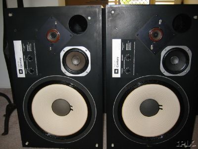

Of a more practical matter regarding listening tests and to followup on my post 1817 my puppies (JBL L100 Century) arrived last night:
I figure this has some relevance as I propose to trial the X Aleph if it behaves it self on theses monitors
"On opening the tea chests I was greeted to a pair for JBL Century L100's in mint condition, the cabinets have hardly a mark on them, the drivers absolutely mint, and the seller included a spare tweeter as one tweeter was poked a little at one point, but sound is not affected apparently!"
Okay, the exciting part........all I can say is audio bliss, these babes are a perfect match for the Mr Pass's heritage and work of art, the Aleph 2. I can't wait to play the X A.........
For a speaker design now over 25 years old the sound makes the jaw drop. How could this be!!!! I mean Hello...... . . . .
There is a clarity, a snap and life a like character to the sound which suggests these are not just a great loudspeaker but a very good monitoring transducer period............
So clean, accurate, and a snappy imaging with precision and a bite that makes you think Mark Knoppler is in front of you here ...now..
In reference to the Rushmore, Mr Pass really has something here:
My hypothesis is that hi end engineering of drivers and system has been around us or a long time, and true to his credit as Mr Pass suggests in the Rushmore literature this came and when with a surge before marketing took over in the 80's and 90's.
I think its also true to say they did not know how a good a speaker(s) they had at the time with amp technology as it was, particularly solid state amps back then. If only Mr Pass was around 15 years earlier...... .
By the way, on the technical side the woofers in the Century run full range, no low pass network , they must have mechanical rolloff in breakup mode, but well damped, on the mid only a 1st order high pass cap, no low pass either, and the tweeter only a cap again.
Can we conclude 1st order crossover adds to impoved sound?
