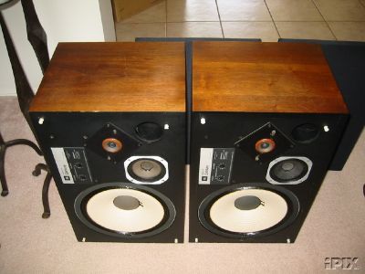

On a happier note I am please to report My X Aleph is up and going 1st pop.
Inital measurements are 500mv across the 0.22 source resisters all round, 66 mv dc offset and after tweeking I got about 27mv absolute Dc offset. (Is this the correct Bias level?)
I have not checked anything else yet but assume all is well.
The diff pair were match to within 5mv Vgs @3.63 volts and the 240's within 100mv @4.33, although this was at 1.00 amp (for the Aleph 5)
So I feel lucky, now to make the other channel and make music.
My speakers mids are being reconed so I cannot play it today but I have a nice pair of puppies (Century L100s) on their way to me.
cheers
Ian
