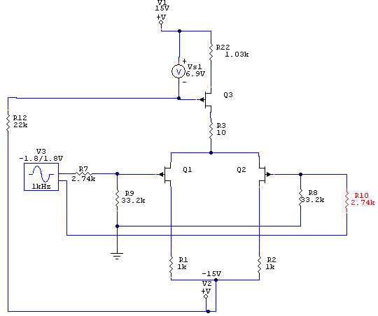

Let's follow this through the circuit and see what happens. To begin with, let's assume a perfect, ideal front end; maybe a 2SK389. Then let's couple this to real world MOSFETs, one with Vgs=3.9V, the other with Vgs=4.0V, just as an example.
Start with, say, 4V DC across each of the load resistors (R23 & R25 on the original schematic back on page 1). The DC offset across R25 serves as the bias at the Gate of Q2, one of the output MOSFETs. Since it's 4V, and lets make this the 3.9V MOSFET, Q2 turns on and begins to conduct. In fact, it conducts a little hard and the -OUT goes a little negative. The feedback loop coming back through R16 carries a fraction of this signal back to Q5, which is the other side of the input differential. Since the voltage is negative, Q5 inverts this and the result is that the output goes a little more positive across R23.
The voltage across R23 is the drive for Q11, the output MOSFET on the other side. Since it was perfectly balanced already at 4V, both DC offset and Vgs, it now begins to conduct a little harder, driving the +OUT more negative. This, in turn, goes back through R30 to Q7, which drives that output positive and causes Q2 to conduct harder.
<i>Voila!</i>
A relative DC offset has become an absolute DC offset.
So is the circuit unstable? After all, that sounds an awful lot like positive feedback.
When the circuit is properly built and adjusted, it is stable. It won't go running away from you. There are enough functioning units in the field now that you don't have to take my word for it any more. However, there have been posts that people had odd results with what they thought were well-matched front end devices. Now you can see why.
The front end devices are not only matched against each other, but against the outputs' Vgs. A slight mismatch in outputs can lead to a perfect front end being a burden rather than a blessing.
This is why it's worthwhile to take a little extra care in matching the outputs across the amp, i.e. Q2 matched to Q11. The more nearly equal they are, the closer you can match your front end.
Ain't science wonderful?

Hey Grey, you mentioned that the gain could be adjusted by changing the values of R23 and R25. Would you mind explaining what a lower value resistance does vs. a higher value? I don't want to hurt my AX by screwing around without some guidance.
Thanks,
John

John,
Your question kinda branches out in several directions.
Let's take the resistors, <i>per se</i>. Imagine a gain device--doesn't matter what kind, for this they're all the same--and put a signal into the grid/gate/base. This signal will control the current that flows through the device in much the same manner that a sluice gate determines how much water a farmer uses to irrigate a field.
Now, for an extreme example, let's say that there's no load resistor (i.e. R23 & R25 removed entirely from the circuit) at all. Effectively, we have a zero ohm resistor, right? In this case, all the current that you've just controlled runs straight back into the rail without doing any useful work. No signal. Bummer.
Okay, so we put a resistor into the circuit. Don't worry about the value for the moment...it's just a resistor. When the varying current we've just created hits that resistor, it creates a varying voltage, i.e. a signal.
Now, we're getting somewhere.
So, Grey, if putting a resistor in there is such a great idea, why not put in an infinite resistor and get infinite signal?
If only it were that simple.
An infinite resistor is an open circuit. No current will flow at all. The gain device would switch off and we'd be back to no signal. Bummer.
So what we need is an in-between value.
Here we start looking at the output MOSFETs for hints as to what to do. Since the MOSFET wants to see something like 4V in order to do its job, and since we've already got a bias current in mind, we're going to go with something around 400 ohms. Well, okay, so there's not a 400 ohm resistor in the catalog...we can go with 392 ohms. Close enough for government work.
Waitaminnit! Whuzzat bias current thingy?
Whenever possible, you'd prefer not to go turning a gain device off and on. It complicates things. It takes time to rev up. So you leave it running all the time if you can--class A. The front end differential in the Aleph-X runs in class A (as do nearly all low level circuits). I mean, might as well, it only draws a watt or two. We're not talking some beastly output stage here.
Since the inputs are on all the time, there's a steady current flowing through the gain devices even when there's no signal. They're warmed up, ready to go.
So we've got this small DC current keeping the front end toasty and warm. Why not let it do double duty and keep the outputs biased, too?
Nothing like killing two birds with one stone, eh?
Now, you could decouple the front end from the outputs with capacitors and let the DC across the load resistors be any old random value. But then you'd have to provide a separate DC bias value at the Gate of the outputs, and that's so inelegant.
So the trick is to play your bias current against the load resistor value to come up with something around four volts. It's not as limiting as it seems. You can drop in JFETs if you want to decrease your gain (they don't have as much transconductance as MOSFETs), or put in bipolar transistors if you want more gain (watch out! easy to get too much gain).
If you want to play with front ends, I'd recommend building a simple differential on your kitchen table and fiddling with it until you get something you like in terms of gain, but still with that 4V offset. Then you can pretty much just patch it in.
For reference purposes, the stock front end has about 20dB of gain and the amp as a whole has about 20dB of gain. If you add 5dB to the front end, the entire amp will have 25dB of gain. If you subtract 5dB from the front end, the whole amp will end up with about 15dB of gain.
Or, for something completely different, you could change the feedback ratio...

ok, if i use high efficiency speakers. Lets say 100 dB/W or so. Wouldn´t it be the best way to use a jfet input stage for i) less noise ii) lower gain ?
Sounds like a good plan to me.
Oh, one other thing. I said 2SK389 above. That's the N one. I should have said 2SJ109--whichever is the P one. I must have a mental block against the 109. Don't know why.

There are some. Motorola has a fair selection of bipolar power transistors that specifically say audio in big, bold letters on the spec sheets. There are others, too. However, we're usually faced with using "low noise" or "general purpose" devices.
If it's any consolation, the same thing's true for tube guys. The 6550 was designed to be the big boy on the block for audio output tubes, but a lot of the other tubes being used in audio were designed for odd things like horizontal deflection in TVs. The 6AS7/6080 power triode was designed to be used as a series pass element in voltage regulators. It didn't take long for it to make its way into the first OTL circuits, though, and it's been a mainstay ever since.
Whatever works. We're a niche market as far as the parts folks are concerned. Generally speaking, not worth the trouble to design for.

Despite the excellent examples, I'm not sure I understand how the 400 ohm resistor value was calculated in order to deliver 4 volts across the FET. If you have a second, it's a lesson I'd enjoy reading.
It sounds like the 400 ohm resistors should remain in place to keep the necessary 4 volts that the existing circuit requires. So, the second idea of replacing the 9610s with 2SJ109s seems to be the solution. I have 110 db horns and I'd trade less gain for more finesse. I don't know how to calculate the correct value for the surrounding circuitry. Is there a chance you could perform this task? Or, even better, teach us how to model this for ourselves? Another thing, do I use the existing 9610 current source, or does this need to be a 2SJ109 as well?

400 ohm resistors are calculated from Ohms Law. For a given current it's easy to calculate the resistors value to get 4V drop. R = U/I where current is about 10 mA if I remember correctly.
Now, the question is, is the sound improves when increasing the current through differential pair? I'm running them slightly higher by using 300 ohns resistors, but didn't perform any comparisons.

How was 10 mA decided upon? Is this a specification from the FET's data sheet?
I assume (please correct me if I'm wrong) Ohm's law say's to divide 4 volts by 0.01amps. This gives me 400, the value of the resistor. What confuses me is how this formula interacts with the rail voltages: With different rail voltages wouldn't the 400 ohm resistor will pass different amounts of voltage and current?

Here is something I was playing around with...
keep in mind that I'm fairly new at all this too. It's just to present the concept. It actually simulated well. I was using 4.75K output to current source "balance" resistors, and 100K feedback resistors. Sensitivity was about +/- 1 volt for full output.
Let the nitpicking/flaming begin!
