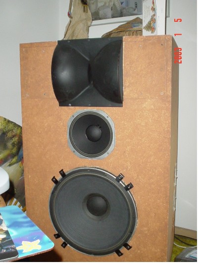

The speakers are run in passive mode at the moment so the mid and horn are cranked back to @ 95-96 dba to match the woofer, but that is still well above the av sensitivity for hifi.
Its the bandwidth from -3db from 32 up that makes it sound loud via the 18" 2245 JBL woofer.
I watched Stark Trek 6 Undiscovered Country last night, my neighbours must of thought there was on earth quake when the Kingons got blown up! MUhhhhhhhhhh.
There is little if any hum and noise from the Aleph 2 so it will be a good becnh mark to develop the X.
