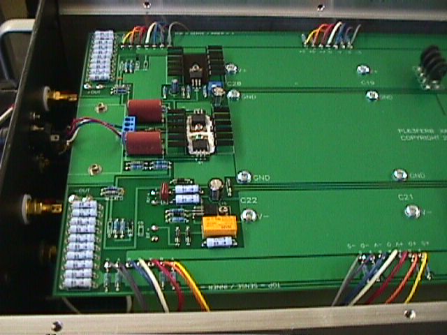

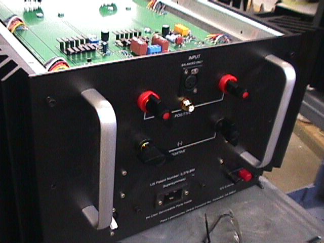

Looking Good
Nelson, styling wise does it really need front handles ? !.
Also, what are those connections at the bottom right of the real panel for ?.
What is the efficiency of these amps, and the lower power versions ?.
Regards, Eric.
Regards, Eric.

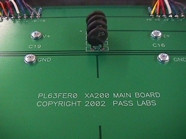

Thanks for the pics, building an Aleph X will be much easier now, no excuses indeed😉

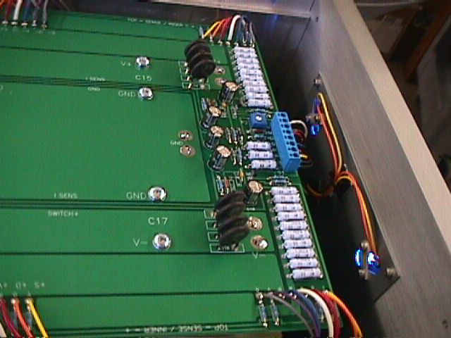

So 4 thermistors in parallel, what would be preferred resistance generated under load?
But you have a weakness for 90 degress traces... Shame!!! hahahahhhahhhaa
Seriously ... Nice design!!!

I think that the discussion about paralleling multiple output devices can now be closed because as you can see on the pics Nelson uses only one input diff pair (and no cascoding).
To answer a couple of questions: The 4 CL60's in parallel
are running about 8 amps and are about .5 ohms each,
for a 1 volt or so drop. The ripple filtering from front to back
of the supply is about 50 to one.
I use very tachyons instead of electrons, 'cause they turn
the right angle corners faster.
The amps draw about 600 watts each, and they clip at 200
into 8.
into 8.

Since I have my A75 open and ready for mods it shouldn't be long. Initially I was thinking about Aleph2, but Aleph X will be a better choice (since I see a single ended input on back panel of your new amp, for some reason X series amps didn't have it)😉 .
So it will be 4 banks of 4 matched devices. If everything goes OK, you can all expected next week.
