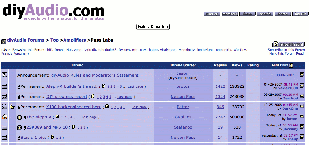

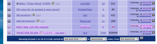

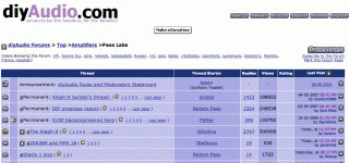

Netlist said:
Top 500.000 hits. I think this is a record, at least here at Pass forum.
The only competition I could find! 🙂
