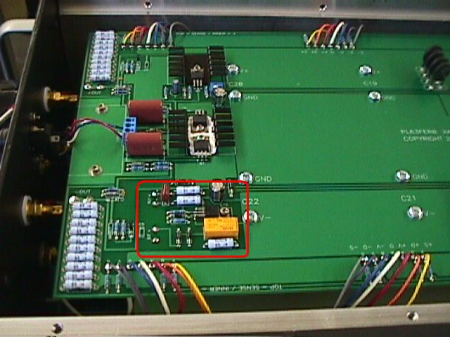

What is the functional of the red erea?
Many thanks Nelson Pass provide the XA200's detail pictures,I look at this again and again and found some special erea,please see attached read area,what's the functional of this erea?cover the unbalance signal to balance signal?
