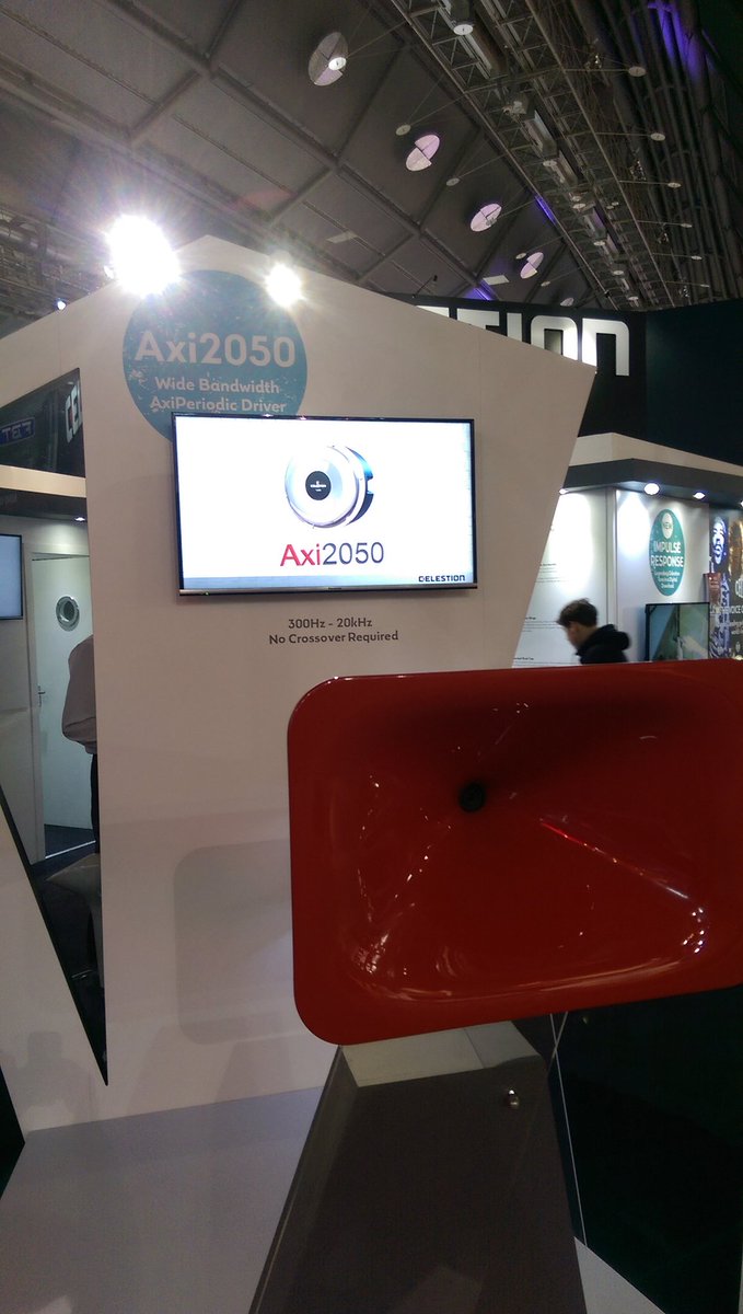

OEM only as yet, but personally I wouldn't bother about either the BMS or the JBL D2, if you could have this for £499.95:
