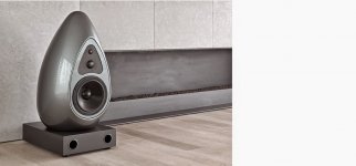

This is a variation of an old idea, and Focal offered an egg-shaped enclosure back in the mid-1980s for a 2-way system.
Sound waves still bend around the enclosure (dependent on frequency of course), so diffraction still occurs, and you can see the 6dB loss at low frequencies. However, round enclosures minimize the frequency response ripples a simple box shape causes.
I'm not sure there would be much of a difference between an egg or a sphere. A sphere might be a simpler shape to produce, and useful for a single driver. I'd guess a slightly different polar response and response step slope to the due to the difference between the long axis and short axis. A sphere might match up better to a simple correction filter to compensate for the 6dB step. But this would b e a very subtle difference.

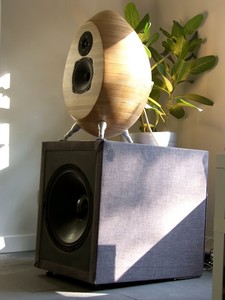

Ah... something I definitely can relate to. This is why I made my enclosure the way I did.
As seen from the top:
Trying to get a seamless shape starting from the cone all the way around the enclosure.
My inspiration? The thread you started with the tennis ball shaped enclosures for tweeters (linking the Orbs) over on DIYMA played a huge part in that. Avoiding sharp corners everywhere was my take on this.

That pic from adason reminds me of another inspiration for my particular setup, the Humble Homemade HiFi (Tony Gee) Mezzo Galactica
attachment.php
The inspiration was the outer shape, his inspiration being the Focal speakers of the mid 80's as mentioned by stevebogus.
Though my inner wavy shape is also similar, my original inspiration for that shape came from another source. That came from the other hated guy over on DIYMA.
That thread made me consider the laminated construction, to be in control over both the inside and outer shape of my enclosure.
It wasn't until I had started the array build that I found the Magico Mini's.
I was already cutting the wood at that time:
Though one could easily be fooled to think that Magico was my main inspiration, it was the build by "the hated guy" combined with Patrick's rant on tweeter diffraction that really made me do what I did. (and thanks to user: koldby for showing how sexy the TC9 could look behind an aluminium baffle)
