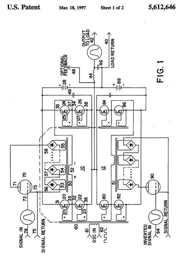

Hello Lampie,i wasn't thinking to a white cathode follower, but at first two tubes parallel wired.
I think that you have a good idea , but first i want to understand this "simple" cathode follower Schematic.
I was thinking to 2 tubes because the current in a 8 Ohm headphone is high.
No problem for these tubes as you need not much power here. Less then 1 Watt (more will blow your ears off your head). So if you do not care of bad efficiency then you should just build it.

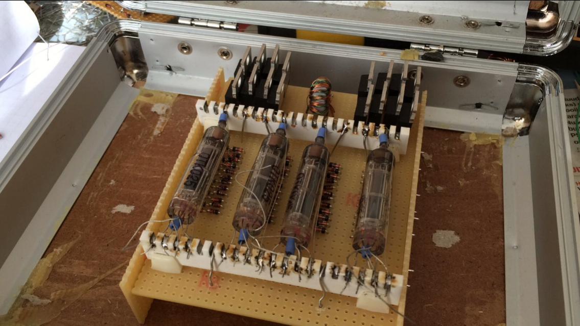

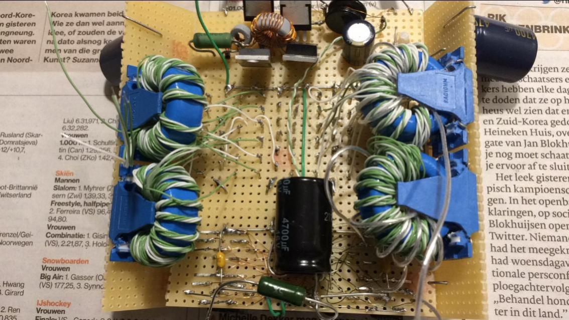

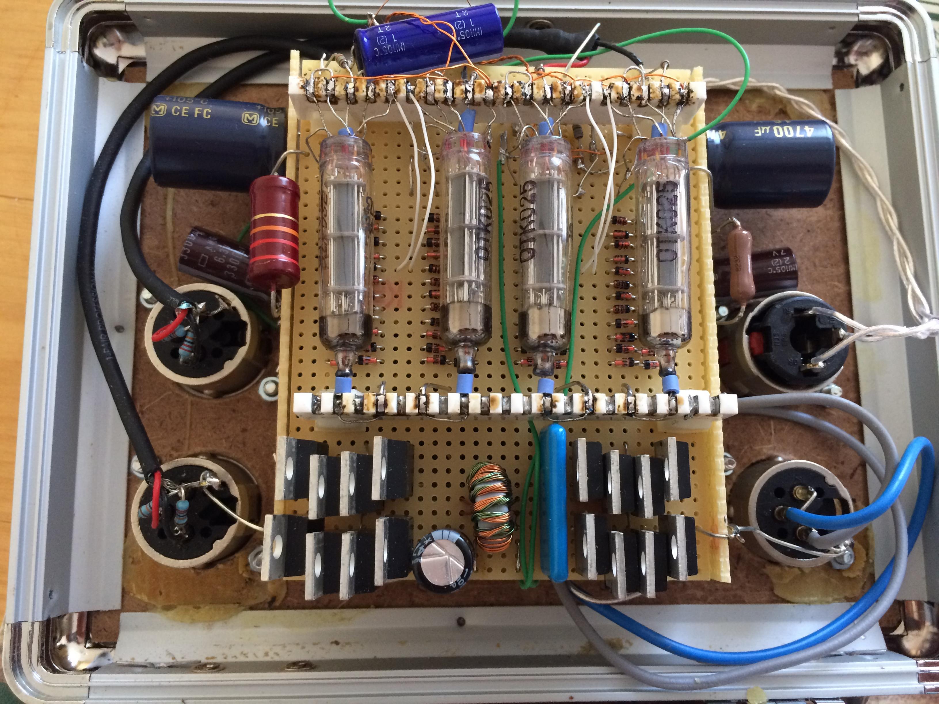

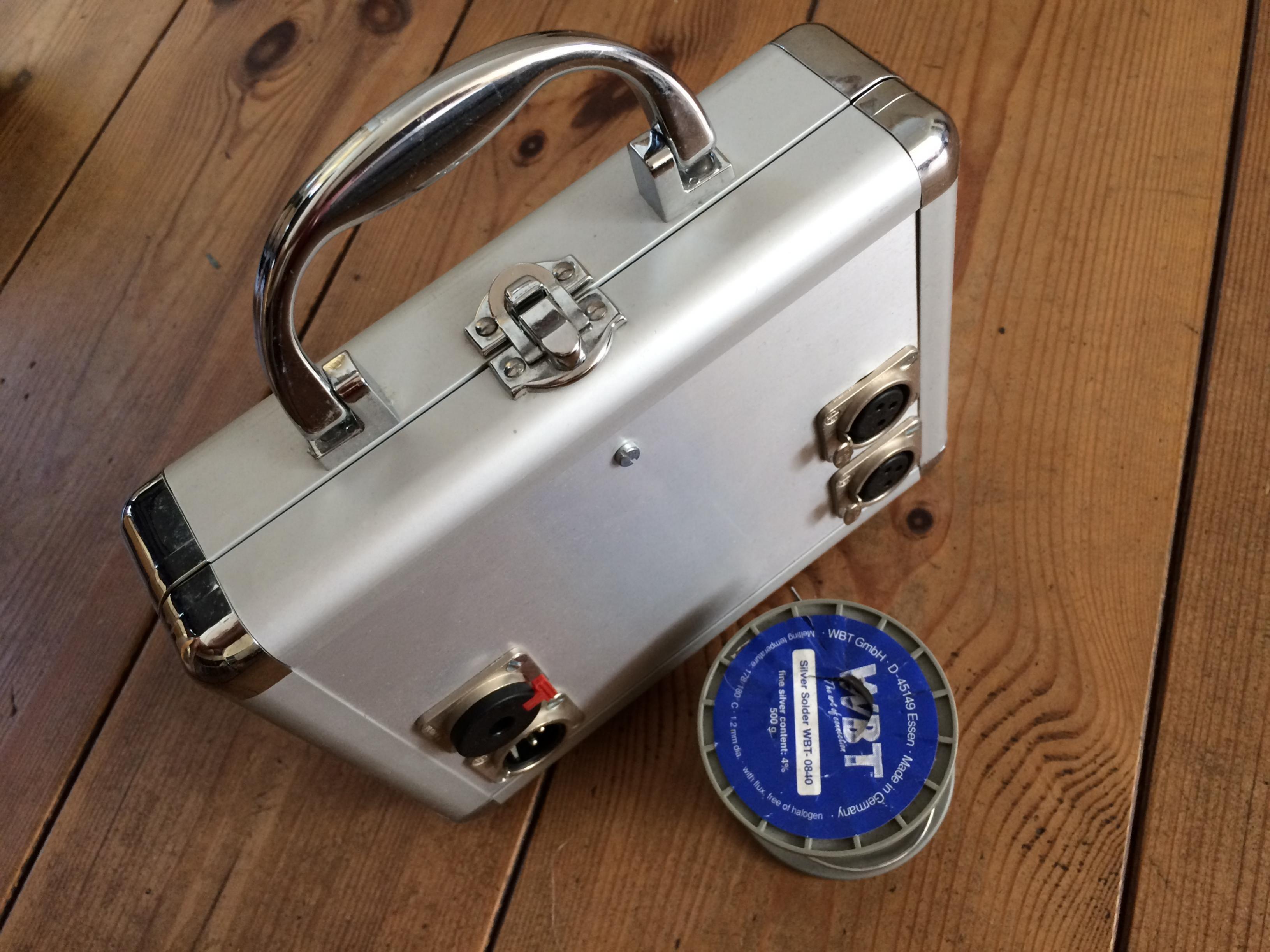

High level suitcase !
Bravo ! You are an artist !
So let's go for a white cathode follower.
