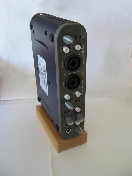

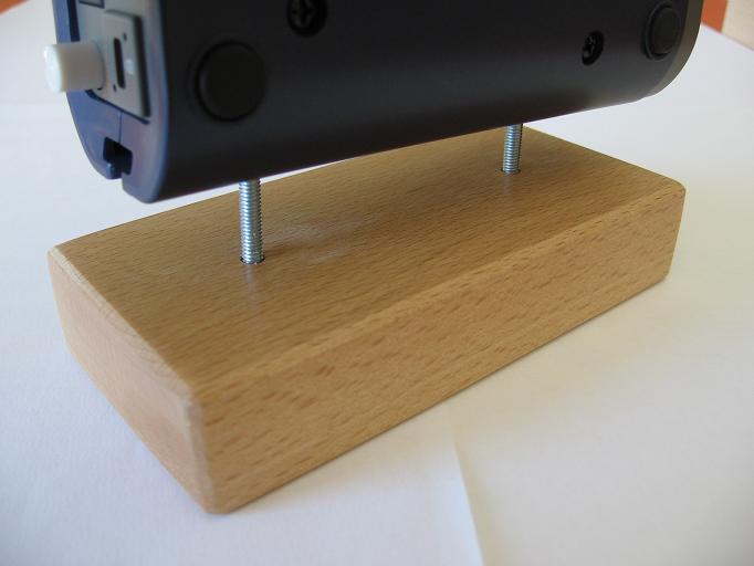

Yes, you need only 5 minutes if you already have at hand:
...and provided that don't care about finishing your stand.

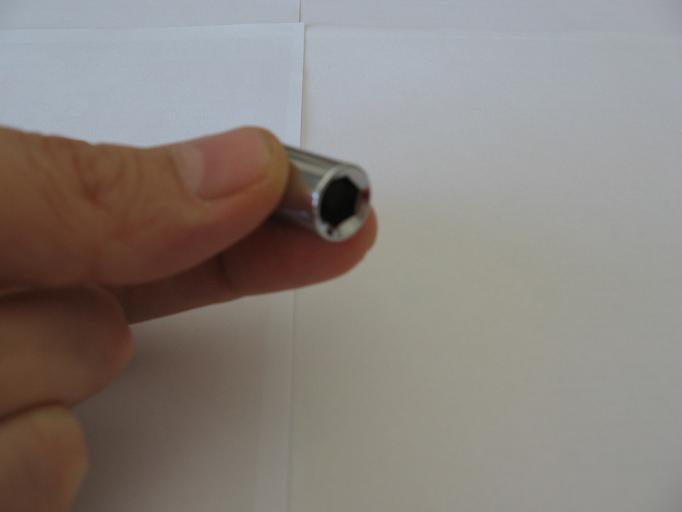

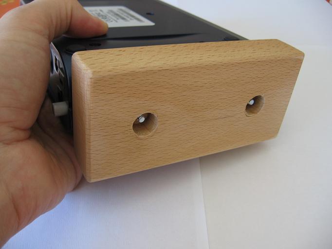

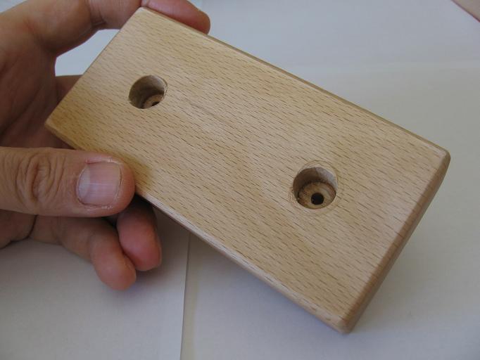

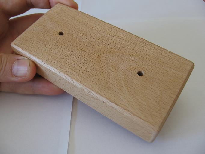

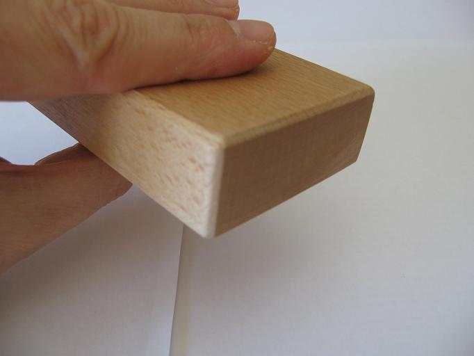

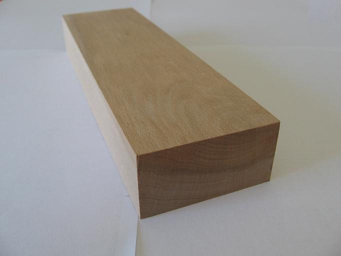

- a suitable block of wood. Perfect (IMHO) size is L 60 x W 125 x H 25mm (but larger/longer blocks and 20 to 30 mm height should be ok).

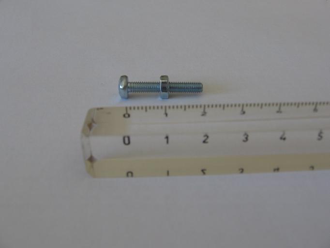

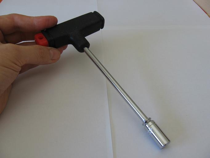

- two screws, thread diameter 4mm, lenght 25 mm.
- a bench drill

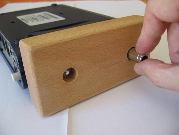

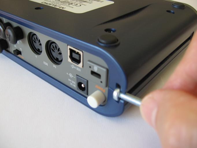

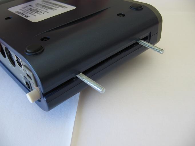

Insert screws in your Fast Track Pro.
I suggest to do that on the side of the headphone and USB jack, likely the most frequently used.
