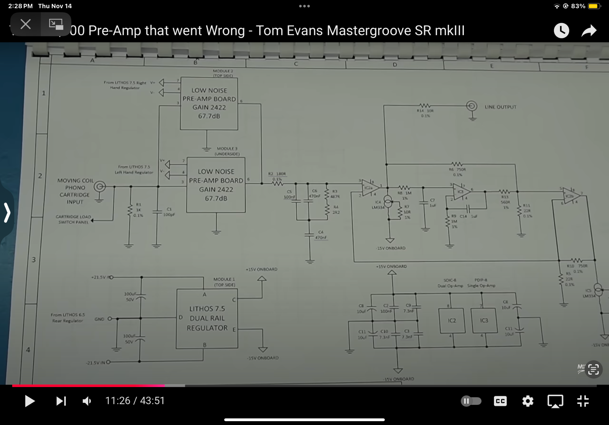

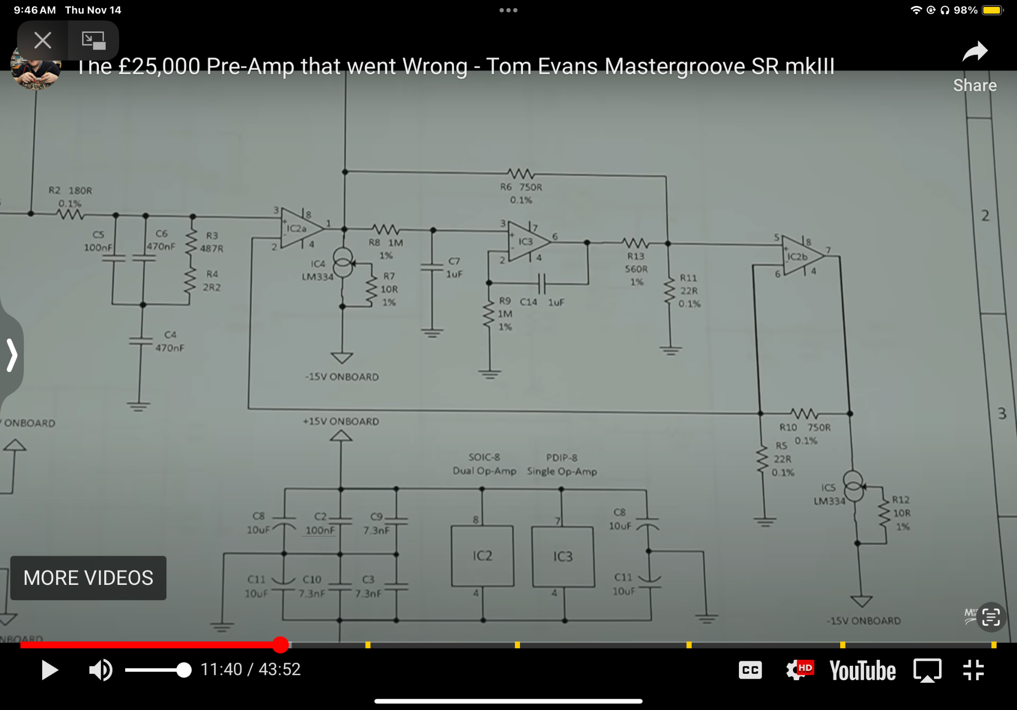

Does anyone know what purpose R6 (750 Ohms) in the line output buffer schematic is serving? IC3 and IC2b are forming a two-stage DC servo amplifier having very high gain at DC. I can’t figure out what is the purpose of R6, though. It seems to be serving as a bypass of IC3, but I don’t know how that would help, seeing as it would forward the output signal into the servo loop. I also note that R6 and R11 have the same values as R10 and R5, all at 0.1%, so form exactly the same divider ratio. Their tight tolerance indicates what must be the importance of their ratios.
Okay, I think I see how it works. Those four resistors determine the AC gain of the closed-loop. Which is equal to the R6,R11 and R10,R5 divider ratios. So, 750/22R = x34 = +30.6dB closed-loop gain.
