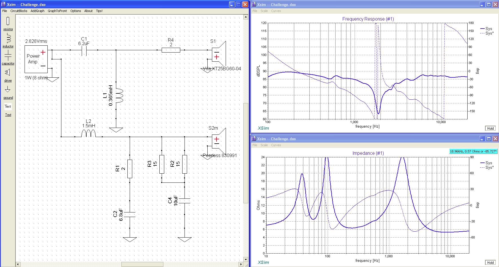

ok all,
First try. Haven't looked at the original link yet (doing that right now). Feel free to pick this apart lol as I don't do passive crossovers. I was worried about R3 and R2 getting warm but they can probably be collapsed into 1 resistor of 7.5R. As you can see vary basic topology. Crossover frequency might be too low, depends on how loud you listen?
This was fun! Cheers!
