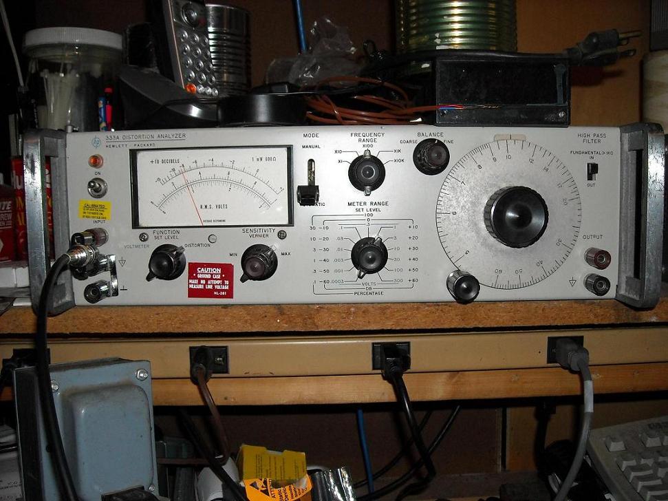

I just fired up a Heath-kit IG-18 my dad gave me. It has probably set 10 years, maybe 20.
At 1Khz, the output was amplitude modulated with all kinds of noise. Finally I got out the manual and went through the cal procedure and it was an instability in the feedback loop that was causing the modulation.
I hooked it up to the HP 333A and got the lowest distortion reading I have seen since I got the DA.
0.029%THD!
So, the HP 333A is good and the IG-18 is good.

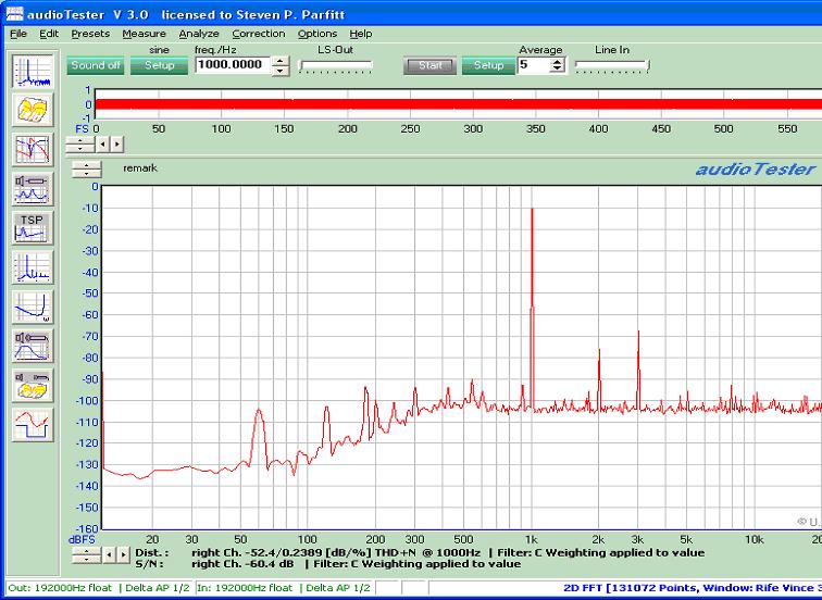

Checking the IG-18 again tonight I got 0.05% thd with the HP333A. I'll start collecting parts to upgrade it.
I tried using audio transformers to couple the diff output of the sound card to the amp UUT, and another to couple from the output of the UUT to the diff input of the sound card.
I also replaced the tube cathode follower with a FET source follower. The FET does not load down as much (lower output impedance) when coupled to the soundcard input.
I'm beginning to think I'm just flogging a dead horse.

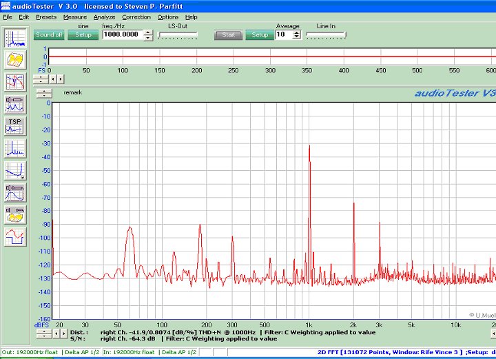

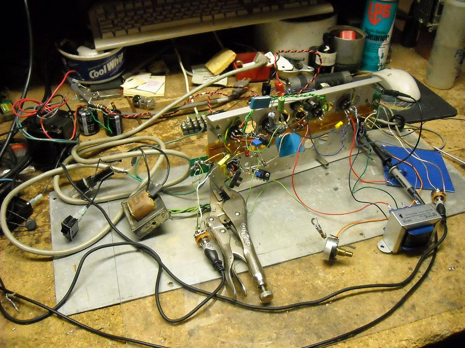

I may finally be starting to get a handle on my distortion setup. I went ahead and set up a ground plane tonight with a sheet of lexan over it (Photo)

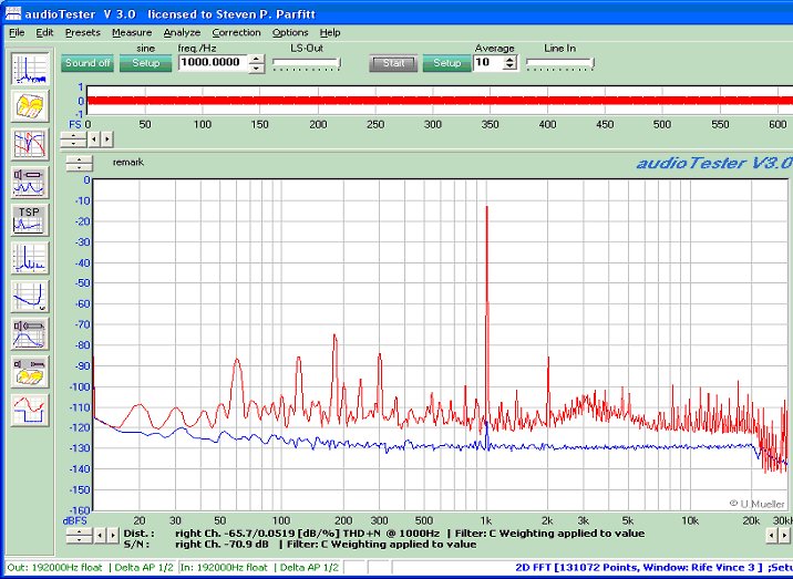

I finally got a FFT of the single ended amp I've been working on (based on the 6N1P for input and 6P1P for output) that the noise floor is starting to look good. 60Hz and it's harmonics are still pretty big though.
I'm going to get some 12" X 66" sections of particle board tomorrow to replace the top of my workbench (it was built in 1981 and needs it). When I do, I'm going to put down a ground-plane under the particle board.
I'm also planning on trying to get a couple more isolation transformers and I'll do a more permanent installation to see if isolating the computer, monitor, etc helps with noise.
Distortion levels are pretty high.

The last plot was taken off a 11:1 divider in the output, so everything shifts up about 3.6dB including the noise floor.
Below 110dB with all the really bad noise gone that I had previously is more acceptable to me.
Hopefully getting a couple more isolation transformers and completing the ground structure will help with the 60Hz and harmonics (especially that thirdand fifth).
Now I can see the IM sidelobes off the 1KHz main, as well as a lot of other related noise.

It's looking much better for sure.
An 11:1 divider would give you 20.8db insertion loss, which is roughly what you see in the FFT plots.
db = 20* log10(Vout/Vin)

I'm reorganizing my bench, and have 48" by 10" of copper sheet that I don't have a use for since I quit home brewing (used to make stuff out of it). So I figure I might as well cut it in half and make a 24" X 20" ground plane under the top surface of the bench. This I'll tie to my star ground.
Next up it the isolation transformers. One has a shield tied to frame (Triad N-54M, 150W). I presume that frame in turn should be tied to green wire ground (earth) of the three prong plug. Currently there is only a two prong plug on it so I suspect I need to change this.
The 600W transformer (UTC R-75) and I'm still trying to find if it has a shield. Statements on the net say it has a shield but I've found no catalog specifying so.
Will a ground loop between monitor and computer make a difference? ie can I power both from one transformer or should I isolate them from each other since they are grounded together through the monitor cable? I guess I could break the ground in the shield at one end to see what happened.
Finally, does it matter if I make the new 3 wire cables to the input of the isolation transformers 6' long vs shorter? Currently they are pretty short (1'). Commercial transformers look like they have 5-6' cords on each end which implies it won't matter.
