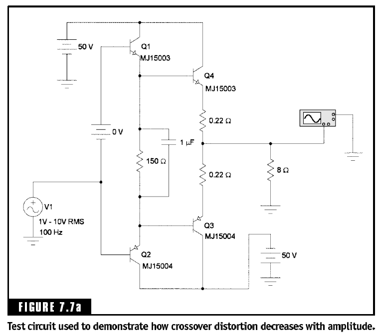

Just have to love this forum and how a basic question on crossover distortion can turn into a discussion on audibility of phase/envelopes and signals below the noise floor. I say this in a good way - I fond it this slightly unstructured approach to discussions interesting and very instructive.
In the section on distortion mechanism in Randy Slone's book on Power Amplifiers he show a test circuit and show some scope pictures together with FFT results. Not sure if they are simulations or actual measurements.
If I am to summarize my interpretation of this section of his book it is as follows.
a) Crossover distortion at low levels (1V RMS with no bias on his test circuit) is dominated by lower order harmonics and because (most) amps have increasing open-loop gain with lower frequencies the feedback mechanism will effectively suppress most of these making THD at low signals levels better than what immediate impression would make one think.
b) Crossover at higher output levels (4V RMS with no bias) tend to generate more of the high-order harmonics. Even with feedback there is typically less open-loop gain to help "combat" these high-order distortion products.
c) The end result is that typical THD percentage at lowest listening levels will be approximately 3 times that of full power (EDIT: assuming proper biasing)
d) The un-linear effect of the crossover distortion will affecting signals up to approximately to about 7 Volts swing (although I can not find proof of this claim)
e) EF stages is better than CF in terms of crossover distortion.
f) crossover distortion should not be confused with switching distortion. Although also appearing in the crossover region this is a different animal that must be mitigated elsewhere in the circuit.
Attached is the circuit he used for reference. He used 0 volt as bias (which I guess is class-C) to maximize the effects of distortion on and the scope traces and FFT plots.
