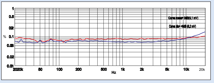

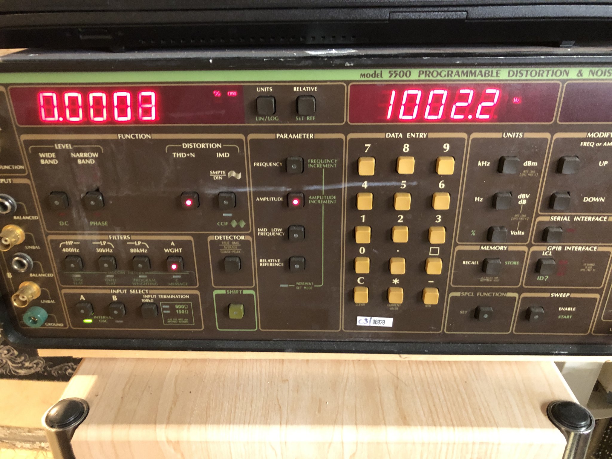

I must admit my 0.05 % was measured with a wideband meter, so it's actually THD+N.
Technically, valve white voltage noise is shot noise with space charge smoothing rather than thermal noise, but the equation for its density is the same as for thermal noise of the reciprocal of its transconductance except for some correction factor.
1/f noise is very important in valve audio designs. It tends to increase with anode current while the white noise decreases, so you get an optimum anode current that depends on the noise weighting. Merlin Blencowe wrote an interesting article about it about a decade ago.

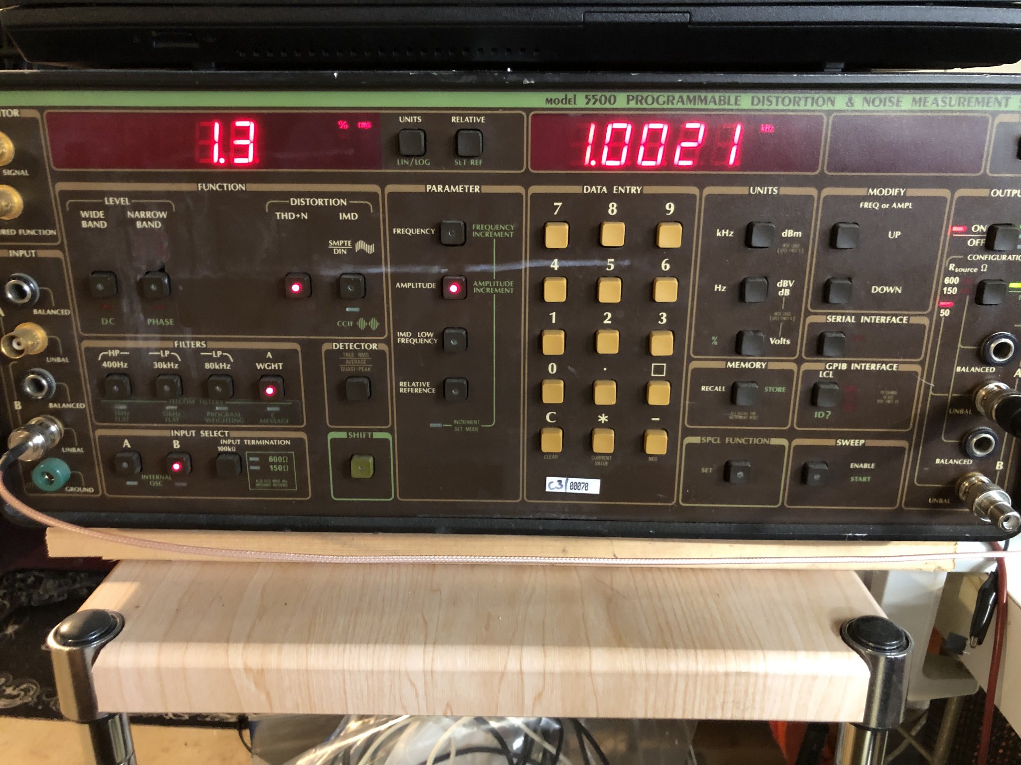

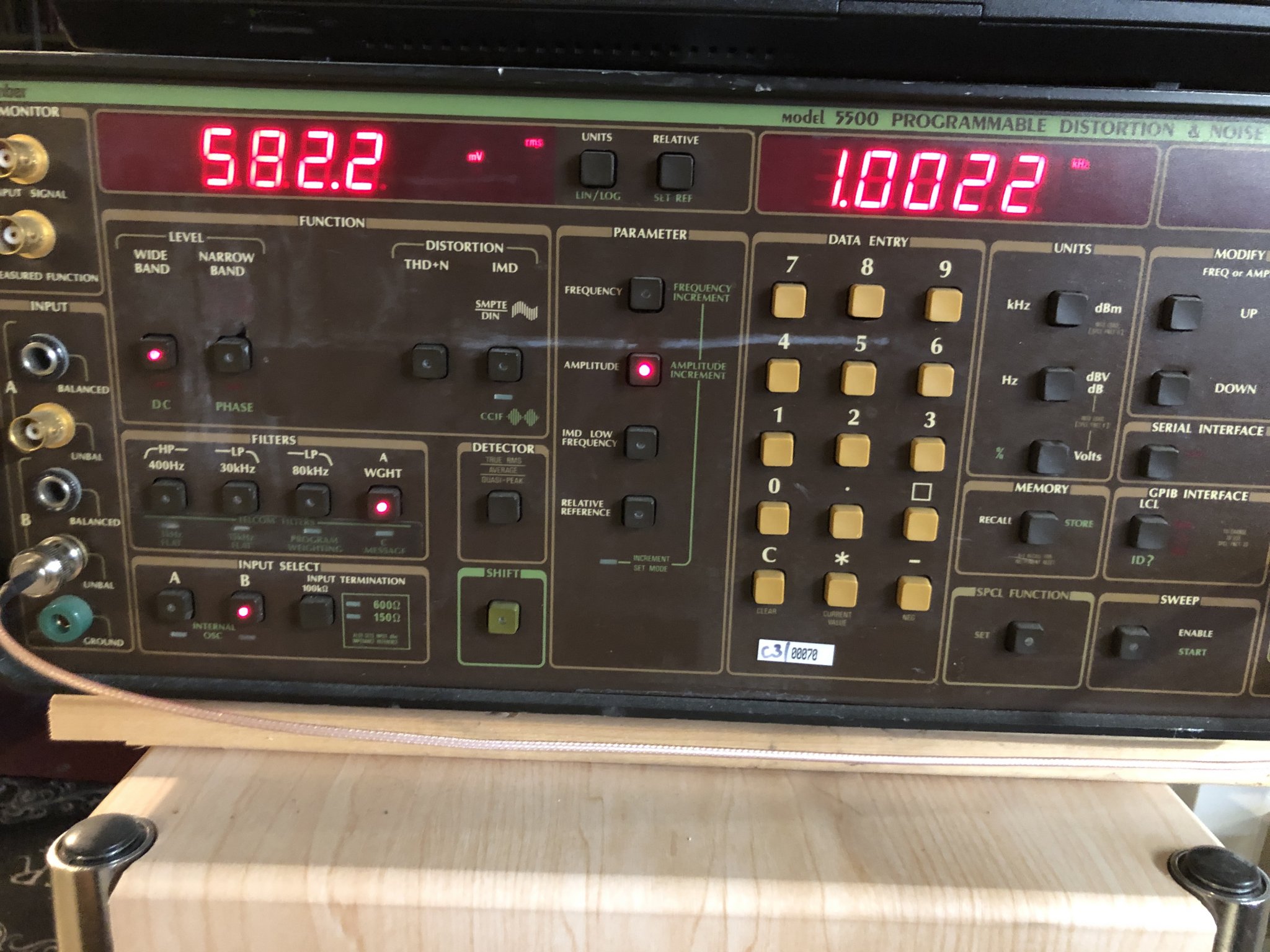

If we take the output of a phono cartridge to be 5mV per channel, requiring 7.07mV horizontal, a very generous definition of 0VU for 5cm/sec (typical numbers might be 6 or 10dB lower) then 0,05% (-66dB) THD+N would be about 2.5uV unweighted. This is a very challenging number to get, and a testament to good design and excellent valve construction re: 1/f noise.
Noise measurements including the phono cartridge can only be worse than the effectively shorted input of a distortion test. Again, noise dominates THD+N, and sometimes (MM/MI) at the highest performance levels, limits further performance gains. The total plateaus.

Fortunately, you're the wrong way up. Typical equalised programme on vinyl peaks to 12dB above 5cm/s (I've measured it). But 1/f noise is definitely a problem for valves. We really shouldn't count hum in as noise as it's a coherent man-made signal rather than the outcome of random processes.If we take the output of a phono cartridge to be 5mV per channel, requiring 7.07mV horizontal, a very generous definition of 0VU for 5cm/sec (typical numbers might be 6 or 10dB lower)
