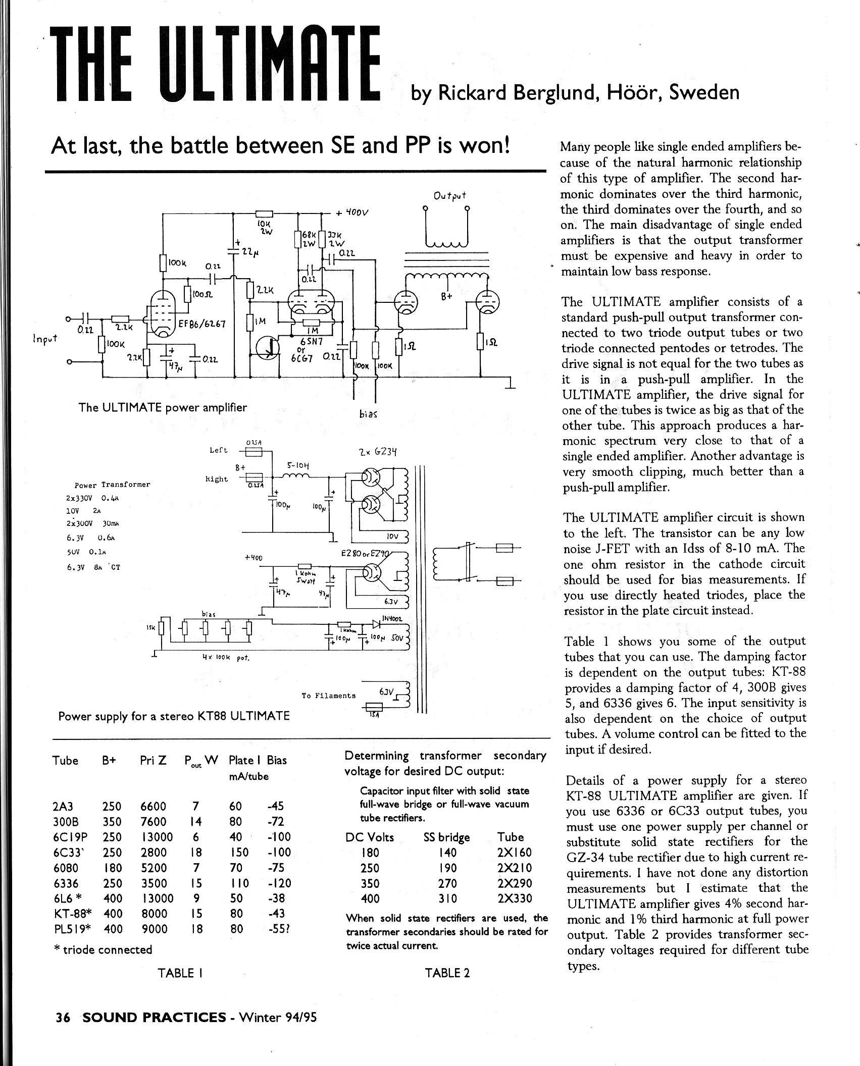

How To Create Many Even Order Harmonics
Then inhibit them with PP output stage.🙂He even puts an NFET tail in the phase splitter to fix a problem he created.🙄
