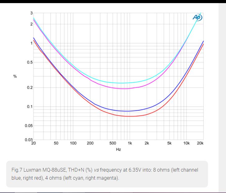

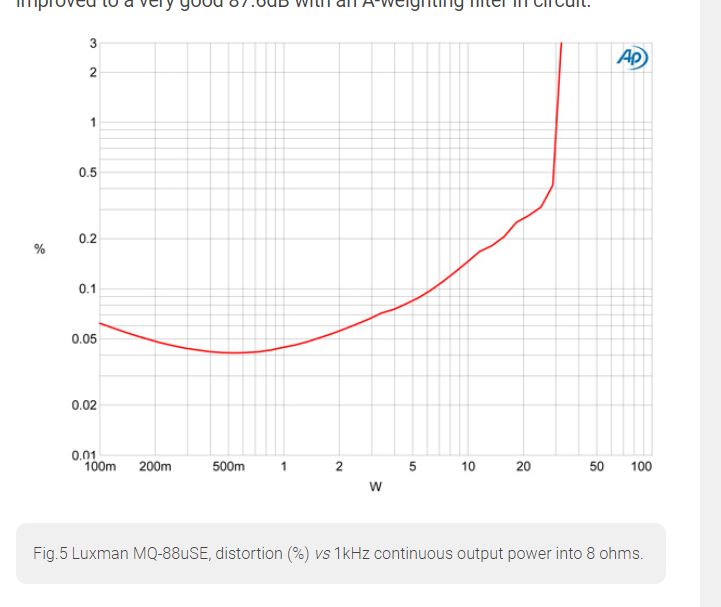

Luxman has a recent tube amp MQ88, a replica of an old circuit but the output triodes are replaced by KT88 wired in triode mode. It is merely 2x25w instead of 2x75w possible with a pair of KT88, for lower distortion? On the contrary for higher distortion of odd harmonics but of opposite phase.
Listening #189: Luxman MQ-88uSE Measurements | Stereophile.com
When you consider S/N of less than 80db, a simple <2$ kit of TDA 2040/LM1875, out performs by far the specs.
