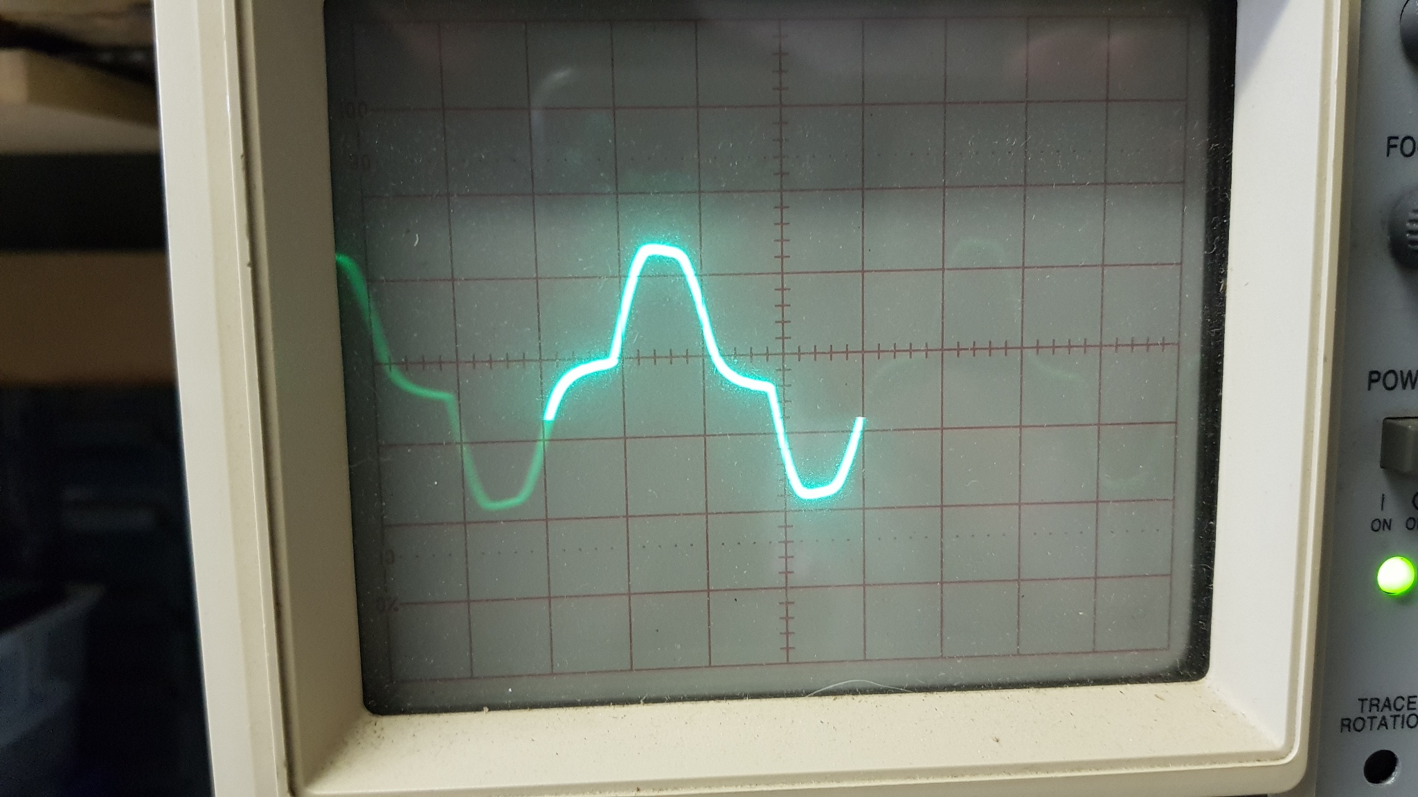

I need to take more measurements when I get a chance and perhaps hook the scope up to the output and see what's going on.

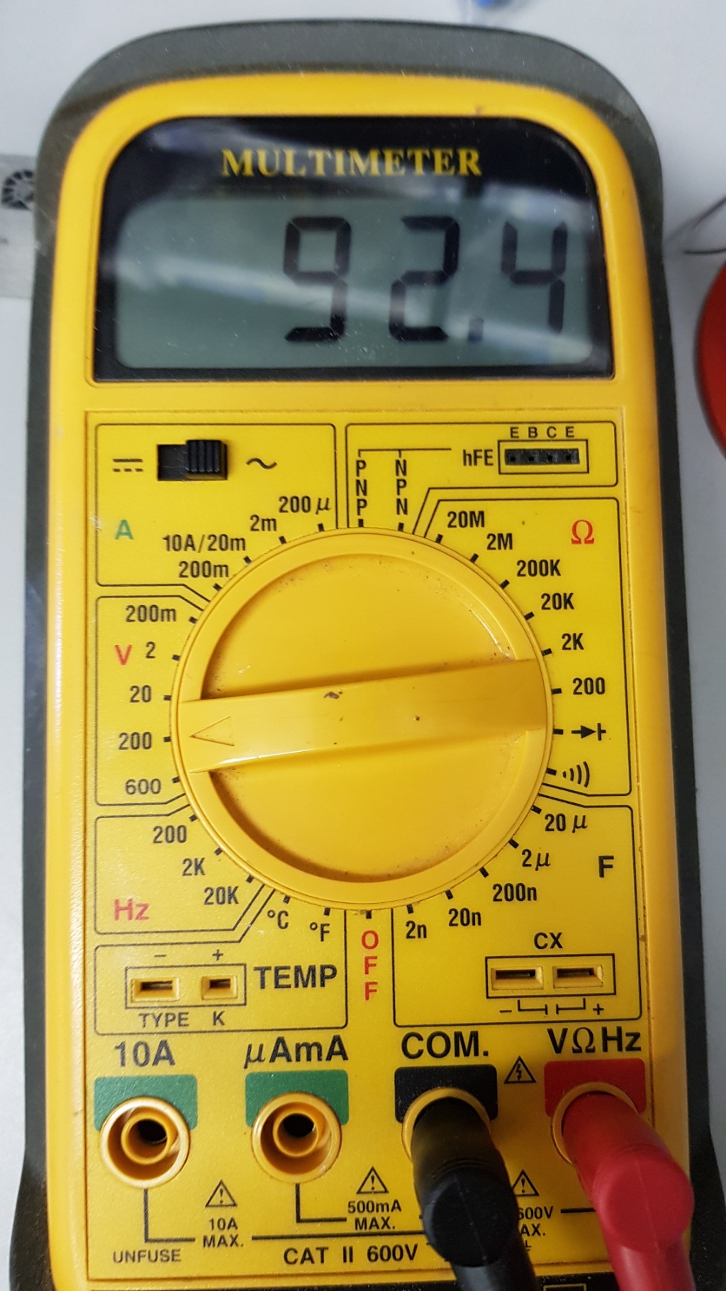

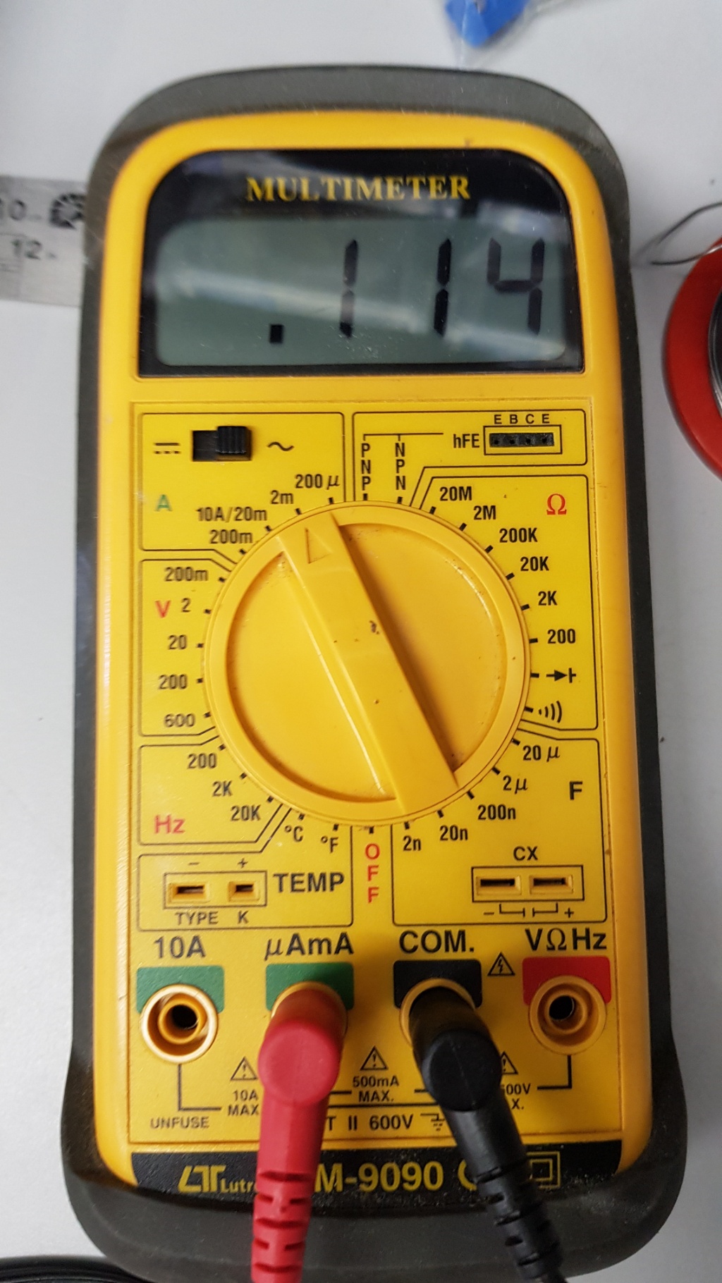

I've attached the metering readings and scope.
The waveform is 20ms period so 50Hz.
The ammeter initially read .212 then when I got camera out and did it again it was around .114.
Voltage this time was higher.

avtech23 said:
I put an ammeter on it previously and had 0.2mA on AC.
This doesn't really match up with the fact that I could feel it and couldn't keep my finger on it for more than a few seconds - that would generally indicate a value closer to 1mA (median threshold of feeling).
I can feel less than 0.5mA. 1mA is the usual limit for an item of equipment.

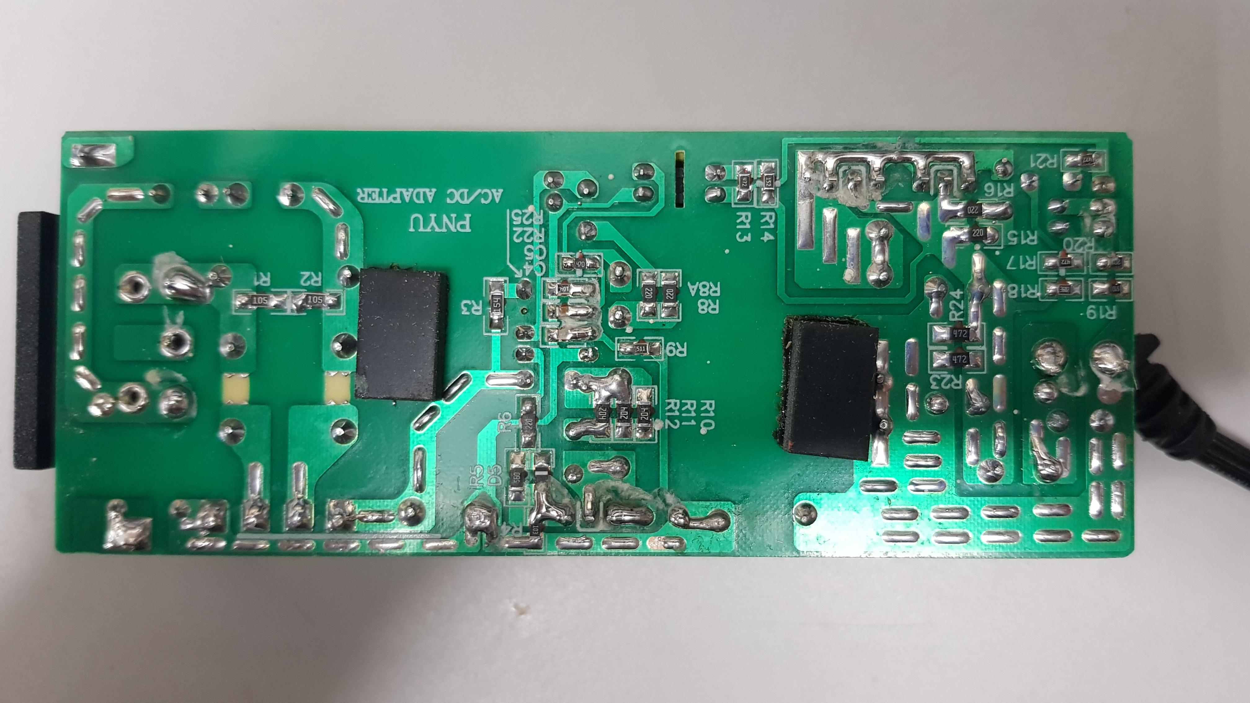

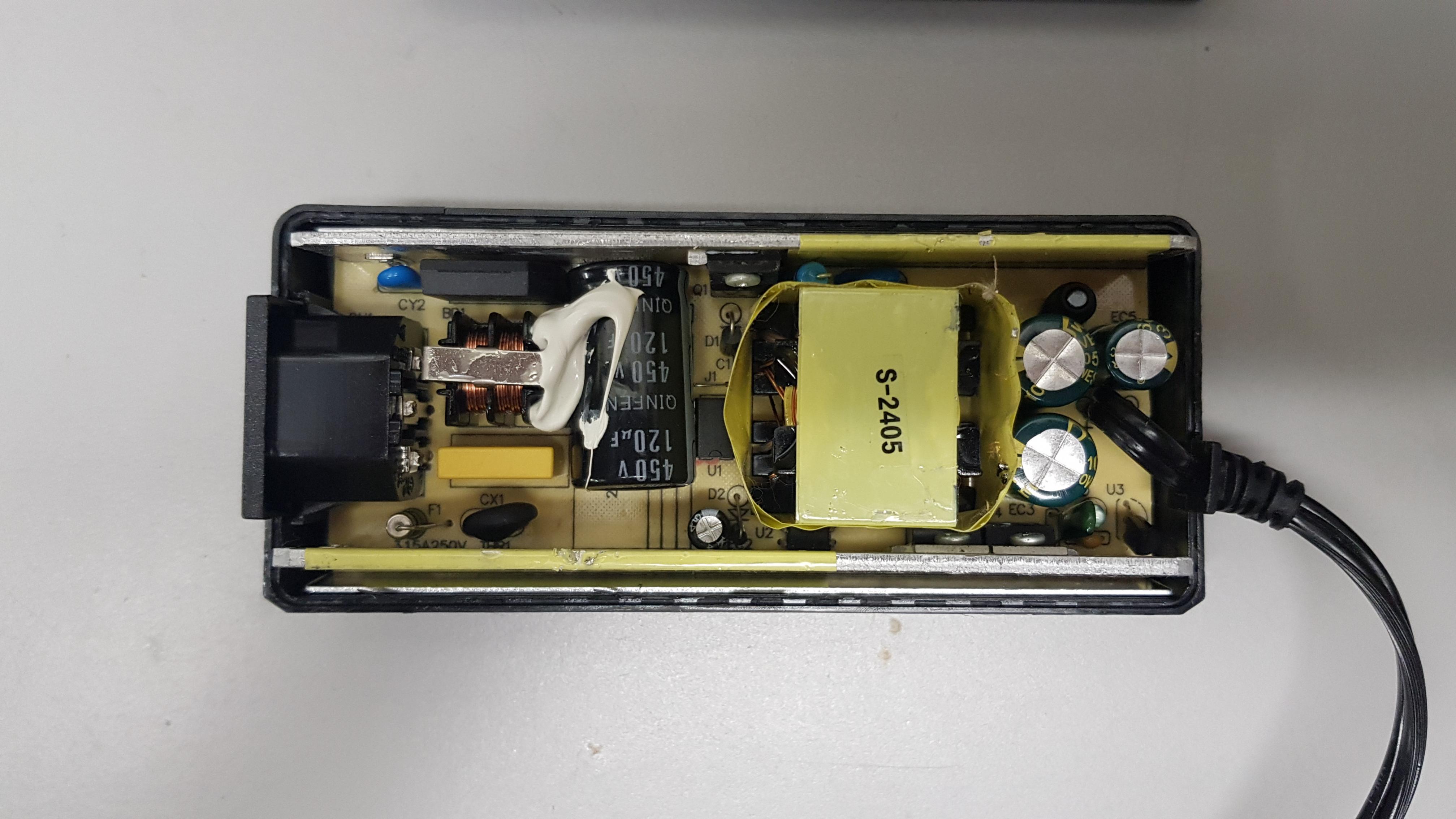

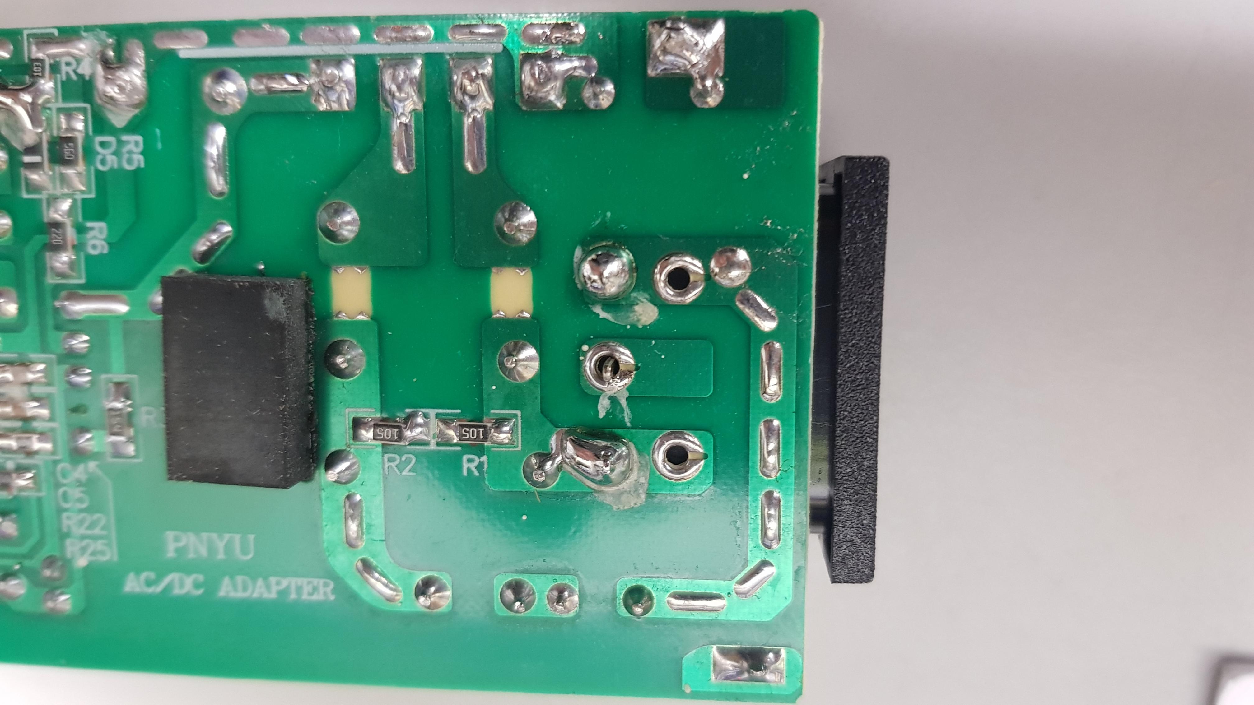

So I decided to crack one open last night.
The earth connection from mains was not connected. There is an X2 cap across the live-neutral. Decent separation between primary and secondary.
I tidied up some of the big globs of solder and ran a heavy, double insulated single core from the earth to negative to dissipate that AC.
I'm a little nervous about bridging the primary-secondary gap with a wire but I routed it clear of everything so should be fine.
