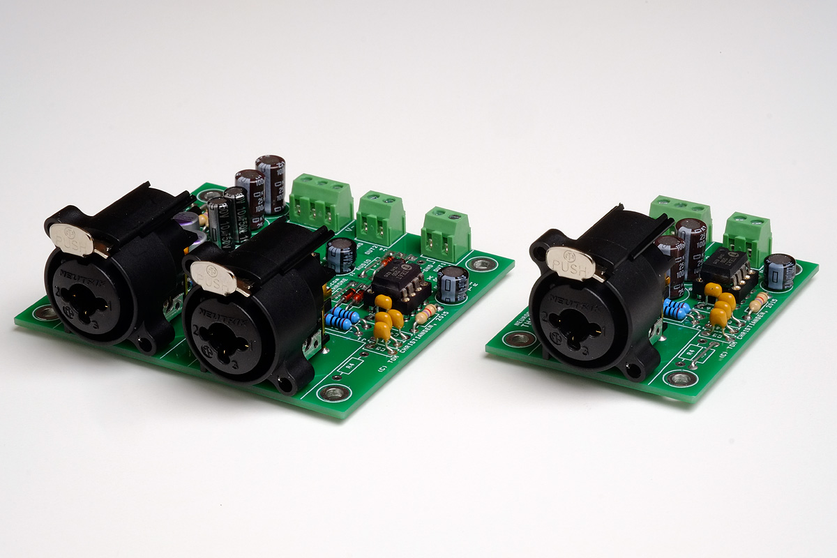

Is there any problem with temporarily running the THAT Driver with a Pseudo-Differential Cable to an amp with a single-ended input? I just want to make sure that shorting pin 1 & 3 won't harm the THAT Driver.
I ask because I think the intent of the cable was to go from a single ended source to an amplifier with XLR inputs. In my case I'd be running the cable backwards, putting the RCA on the male end of the cable.
That'll be fine. In fact, one of the selling points of the THAT1646 is that it will provide high-end performance even if one of the output pins is shorted to ground. The designers at THAT apparently figured that someone would do exactly what you want to do so they made the chip so it'd support that mode of operation. For many differential drivers, that's not the case.

Be careful selling pcb's with components missing.
I have had stuff sent back on ebay because of that despite my protests that it was deliberate !
Confused. Tom is selling blank PCBs and not on ebay.
I meant populated pcb's but with odd components missing.
Still confused. What has that got to do with this thread? No one here is selling populated PCBs.
There was a picture of a partly populated pcb I thought was what he was selling.
Sorry I should have the thread completely.
I don't recall posting a picture of a partially assembled THAT Driver board and I have no plans for selling any partially assembled boards. It'll be either bare boards or assembled boards. No in-between.

I like your idea of using this as a preamp with volume controls. You have suggested a 10k pot. Does a 10k pot have a low enough output impedance for driving the THAT 1646? I ask because a quick glance thru the literature under Applications says "2. Both devices must be driven from a
low-impedance source, preferably directly from
opamp outputs, to maintain the specified performance."
No, not directly. That's why I have a buffer (with gain option) at the input. The input impedance of the THAT Driver board is 100 kΩ set by a resistor. You can crank this up a bit if 100 kΩ doesn't suit your fancy. 🙂
