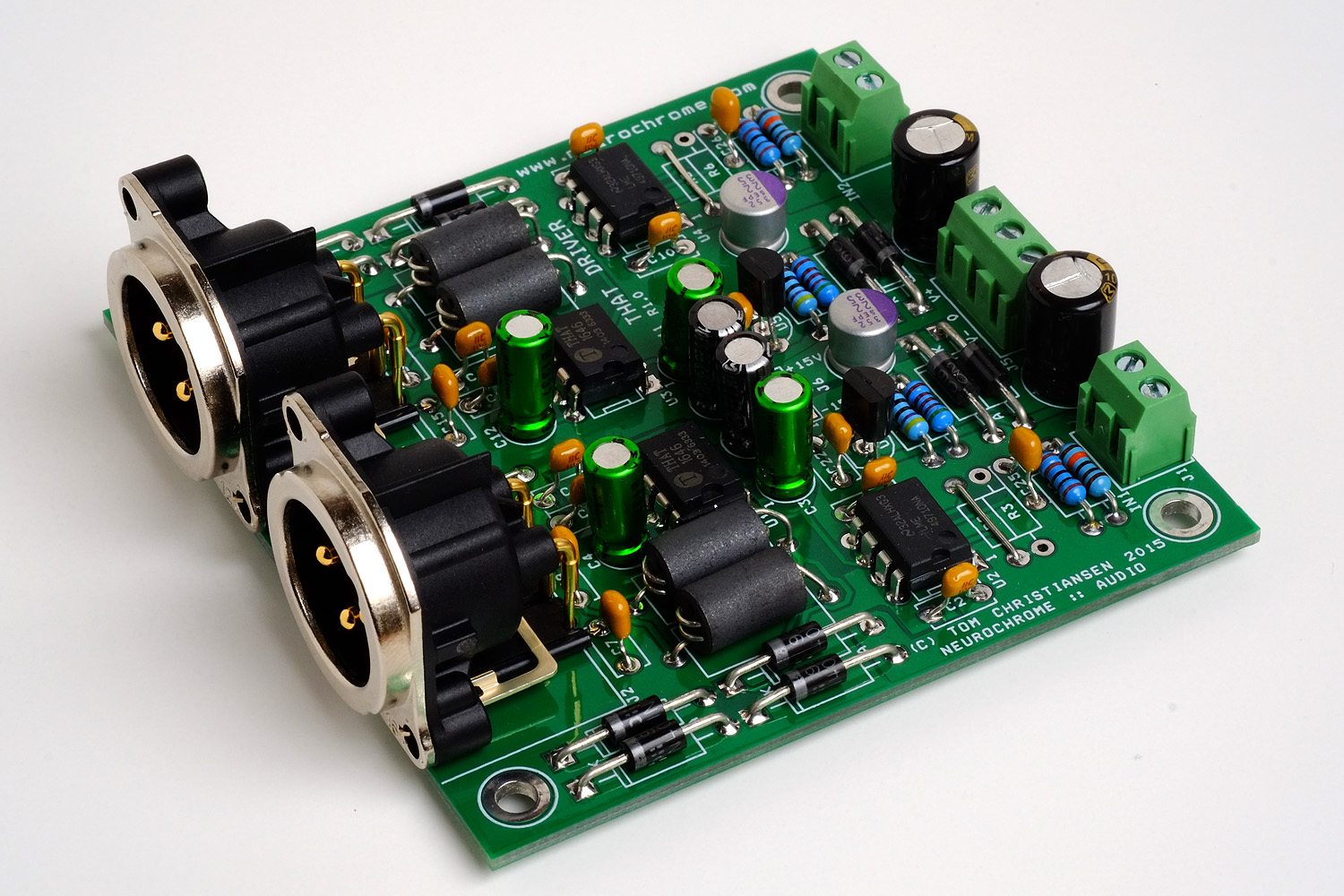

The advantages of differential signalling are well-established in the literature and differential connections are standard in professional audio. However, adoption has been slow in home hifi products. The THAT Driver addresses this. The intent of the THAT Driver circuit is two-fold. The circuit can be used to retrofit a differential output to your single-ended source. If fitted with a volume control, it is also ideally suited as a preamplifier for amplifiers with differential inputs, such as the Modulus-86, Parallel-86, DG300B, etc.
The THAT Driver takes a single-ended (unbalanced) input and provides a differential (balanced) output. Many single-ended systems, even the better ones, appear to operate right at the audible threshold for mains hum. The result is a fuzz in the sound due to the intermodulation between the mains hum and the input signal. Using differential signalling, the THAT driver, greatly improves sound quality by practically eliminating this mains hum.
The THAT Driver provides two identical circuits with a shared on-board low-noise power supply regulator, hence, is ideal for stereo and multi-channel builds.
Circuit boards are available for purchase through my website: THAT Driver: Differential line driver / preamp

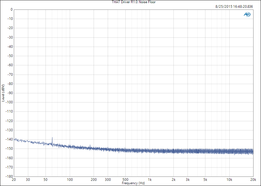

The specifications for the THAT Driver are listed below.
The measurements are shown in the attachments. Note that to measure the THD, a precision oscillator (Victor's 1 kHz) was used. This oscillator does add some spurs at multiples of 30 Hz, hence, they show in the THAT Driver output in this measurement as well.
- Gain: 6.0 dB
- Output Noise Floor: -152 dBV
- Residual Mains Hum: -138 dBV
- THD: 0.000021 % (@ Vout = 2 V RMS)
- THD+N: 0.00032 % (@ 1 kHz, 20 kHz BW)
- THD+N: ≤ 0.0007 % (@ DC – 5 kHz, 60 kHz BW)
- THD+N: ≤ 0.0010 % (@ 20 kHz, 60 kHz BW)
- IMD: SMPTE, 60 Hz + 7 kHz, 4:1: -104 dB
- IMD: 18 kHz + 19 kHz, 1:1: -114 dB
- Gain Flatness: 0.02 dB
- Bandwidth: 5.7 Hz – 320 kHz (-3 dB)
- Power Supply Voltage: ±18 V – ±40 V
- Power Supply Current: 25 mA
- Board Dimensions: 3.0 x 3.0 inches (76 x 76 mm).

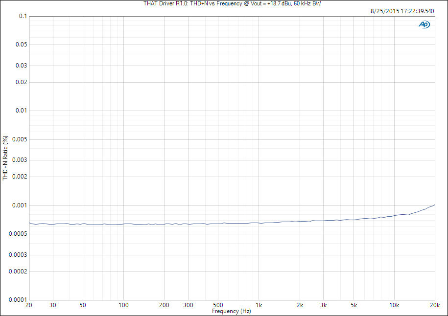

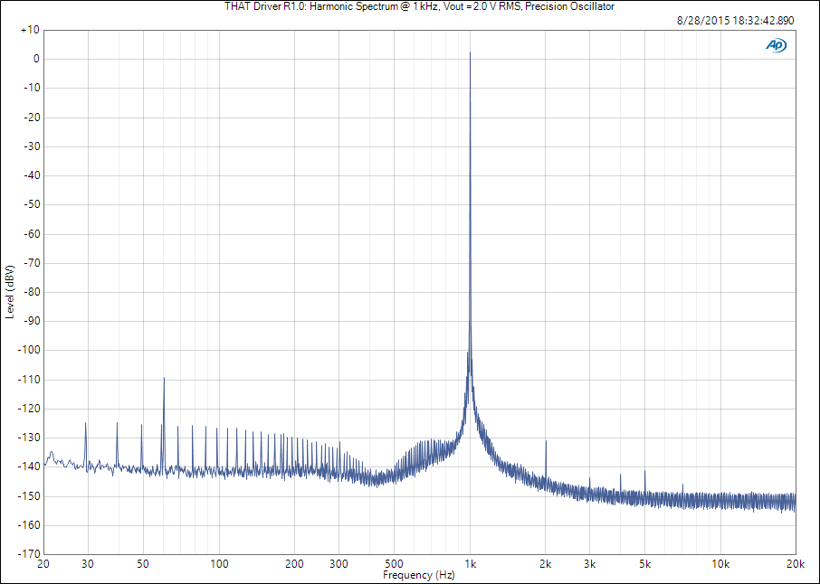

Tom
THAT Driver R1.0_ Harmonic Spectrum @ 1 kHz, Vout = 2.0 V RMS, Precision Oscillator.png47.8 KB · Views: 3,632
THAT Driver R1.0_ THD+N vs Frequency @ Vout = +18.7 dBu, 60 kHz BW.png36.8 KB · Views: 3,490

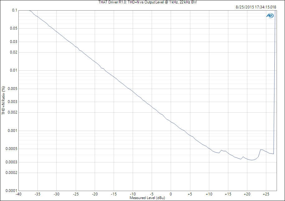

THAT Driver R1.0_ THD+N vs Output Level @ 1 kHz, 22 kHz BW.png28.4 KB · Views: 3,435

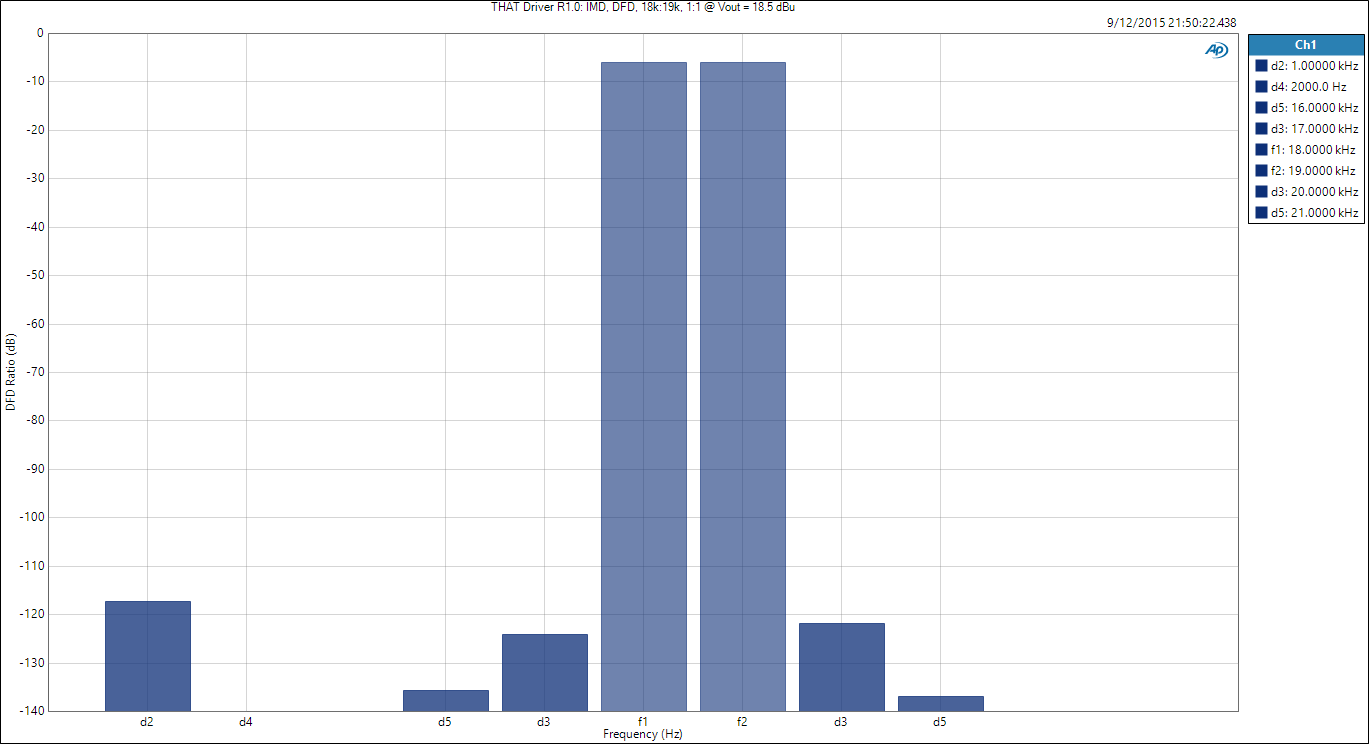

THAT Driver R1.0_ IMD, DFD, 18k_19k, 1_1 @ Vout = 18.5 dBu.png33.6 KB · Views: 352

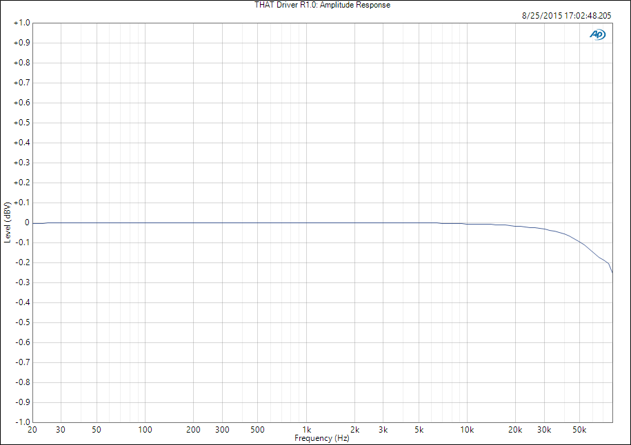

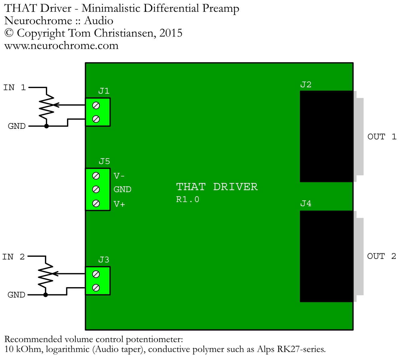

Attached shows how to configure the THAT Driver as a preamp by adding a volume pot.
Tom

On which equipment where these figures confirmed??? As far as I know lab-equipment usually does not measure THD under 0.0001%
Why don't you have a look at Tom's site, he clearly states what test eq is used and how the tests were done, levels, bandwidth etc.....
reliable THD measurement under 0.0001% (< -120db)... come on...Why don't you have a look at Tom's site, he clearly states what test eq is used and how the tests were done, levels, bandwidth etc.....
I use an Audio Precision APx525. The instrument itself is good to -112 dB THD+N. For more zeros on the THD measurements, I use a precision oscillator. Search "Victor Oscillator 1 kHz" on this forum (or on eBay). The noise floor of the FFT analyzer in the APx525 is about -160 dBV (512k FFT length, 32 averages). Victor's oscillator is good down to -140ish dB THD.
Tom
