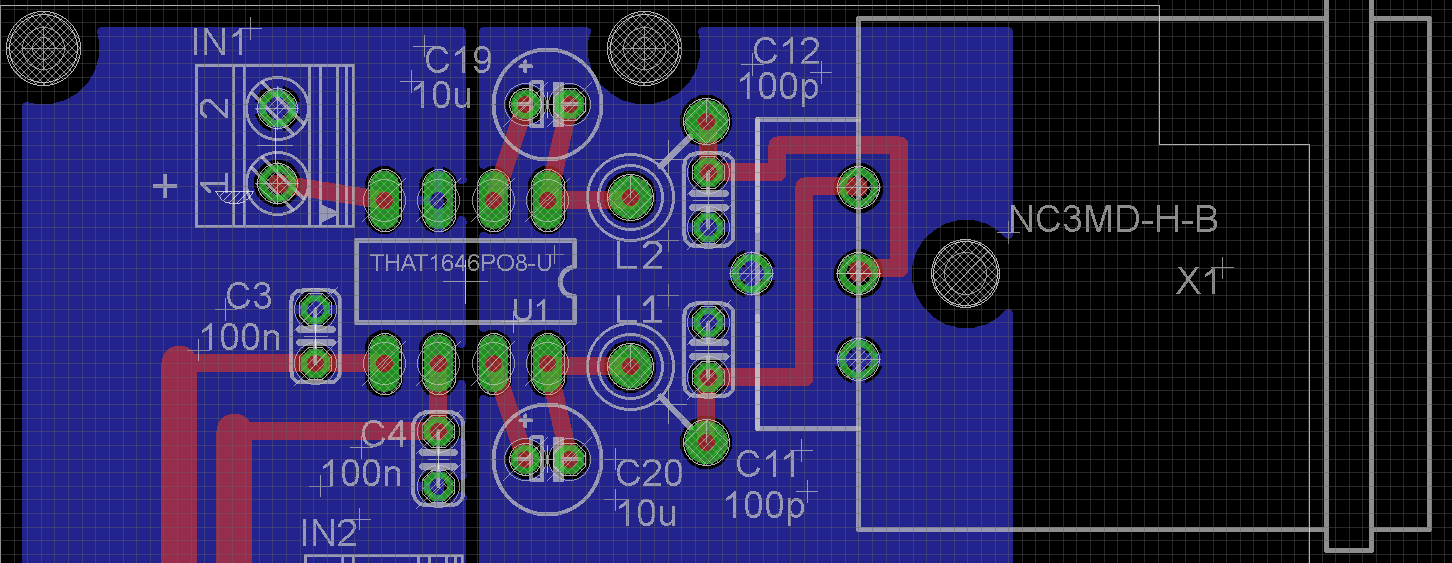

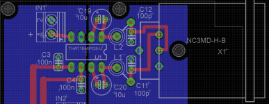

OK, some changes:
1. Reduced the two power caps to 22uf at the advice of DR_EM.
2. Thickened signal traces.
3. Put back the "chassis ground plane", because it made nr 4 easier:
4. Put in the ferrite beads. I´d really like to avoid SMD soldering, so I found a footprint and part in the Adafruit library. I´m using the bead in series after the chips output, and a 100p cap to ground (note: chassis ground) after each bead. I believe this should be correct according to the datasheet, but please correct me if I got it wrong.
5. Increased to 3.5mm connectors, that seems just about right. 🙂
How does this look?
How does this look?

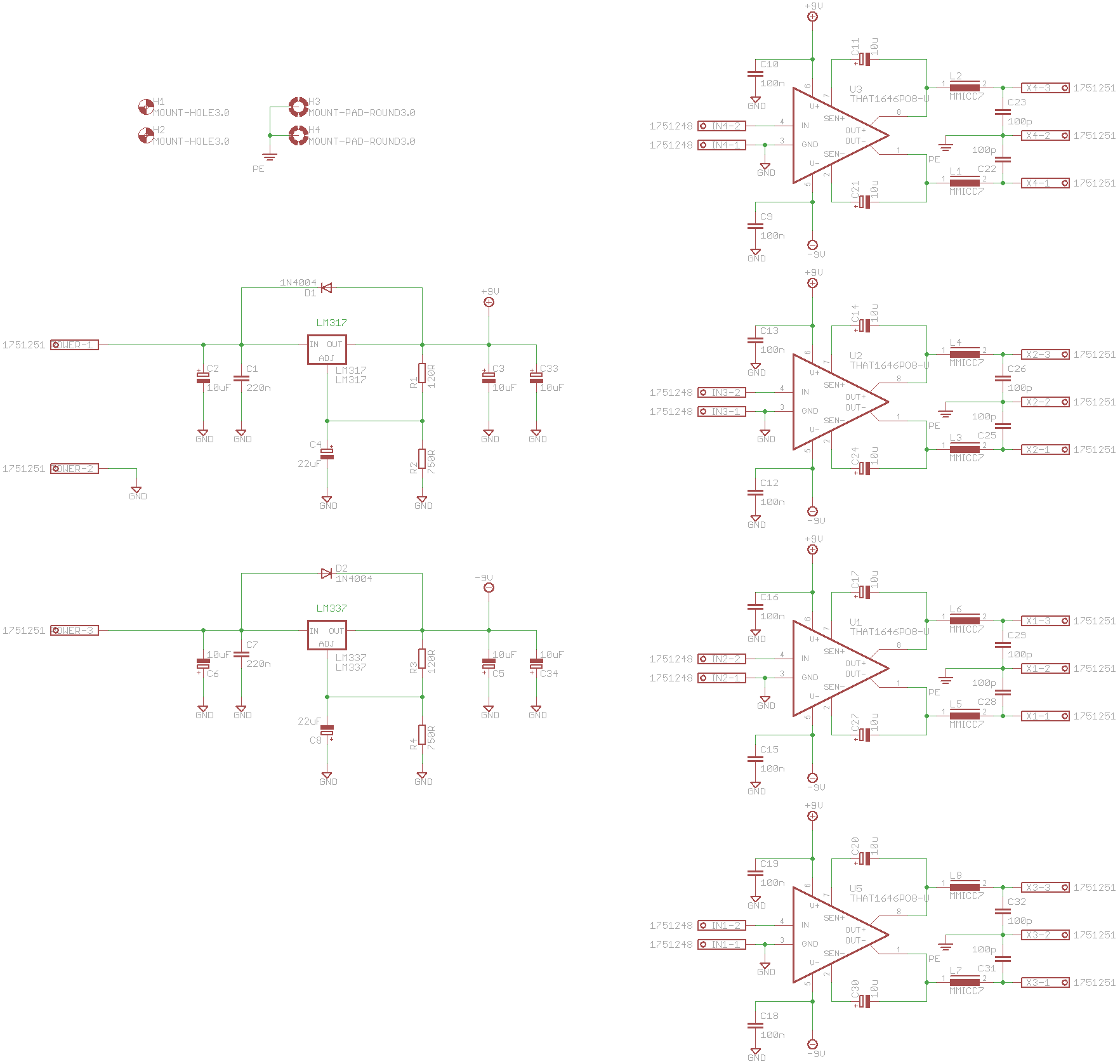

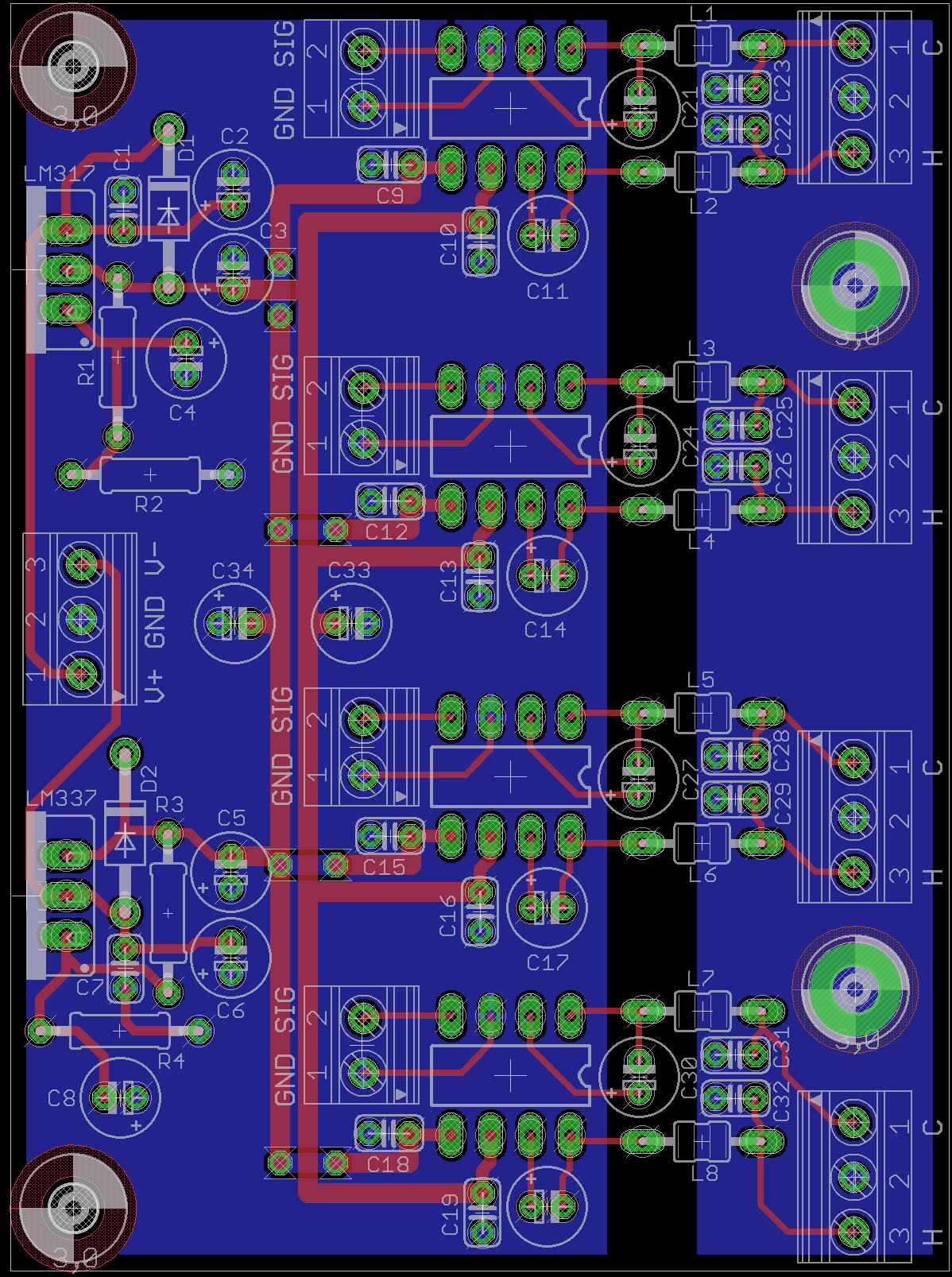

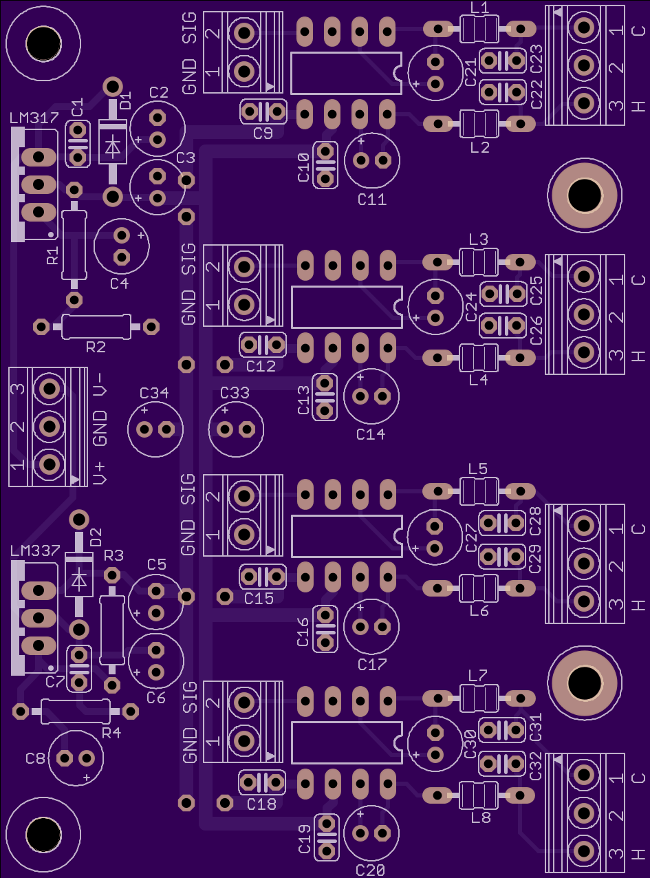

Update: DR_EM helped me complete this design, adding LM337/317 regulators, replacing the beads, and generally cleaning the design up, as well as preparing gerber files for production. Thanks a lot DR_EM and everybody else who have provided comments in this thread, and also thanks to jcga who built similar boards and provided the starting point for me.
The design now looks like this:
Eagle board:
Schematic:
OSH Park rendering (top):
Also included as an attachment to this post is the schematics, board file, bill of materials and gerber files ready for production. I have been looking for such a board for a while, and thought it would be nice if somebody else could just download this one and use it/modify it/make it better etc.
The board is 81x60mm. I have ordered a batch of 3 from OSH Park, but I won´t be able to test it for a while yet (my project is really moving slowly, but piece by piece are falling into place). Will give an update when I do.
