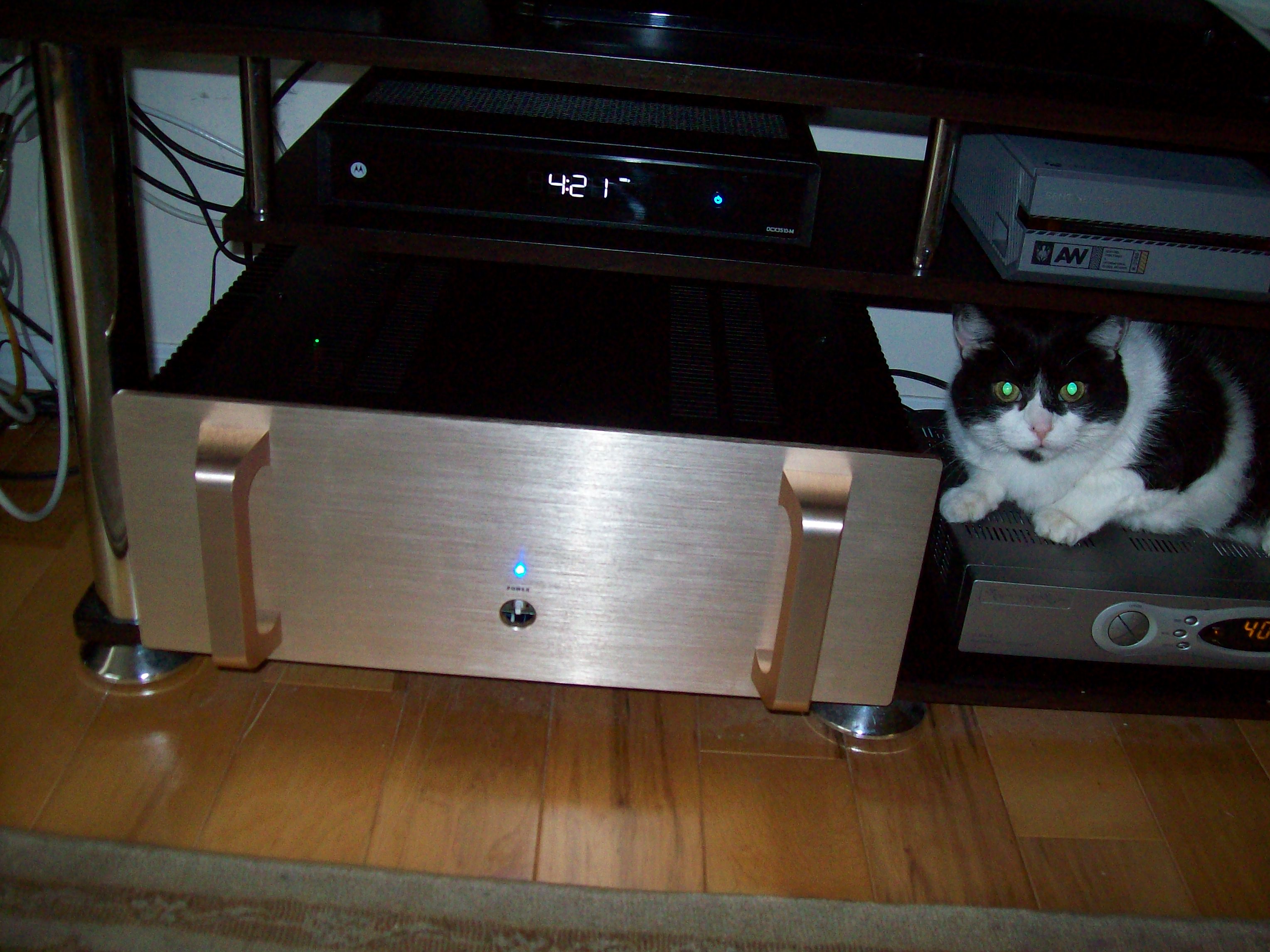

I have just listened to my Aleph J and am stunned. The clarity, punch, soundstage are amazing. In my 61 years I've never heard amplified music like this. All this thru a lowly pair of New Large Advent speakers (with upgraded tweeter).To be able to design a circuit with so few parts that does so much is truly genius work. Sharing this information for us builders to enjoy is sincerely appreciated. Thank you Mr. Pass and all the other folks on DIY that helped me thru my build. For anyone on the fence as I was don't wait, build and you will be rewarded.🙂

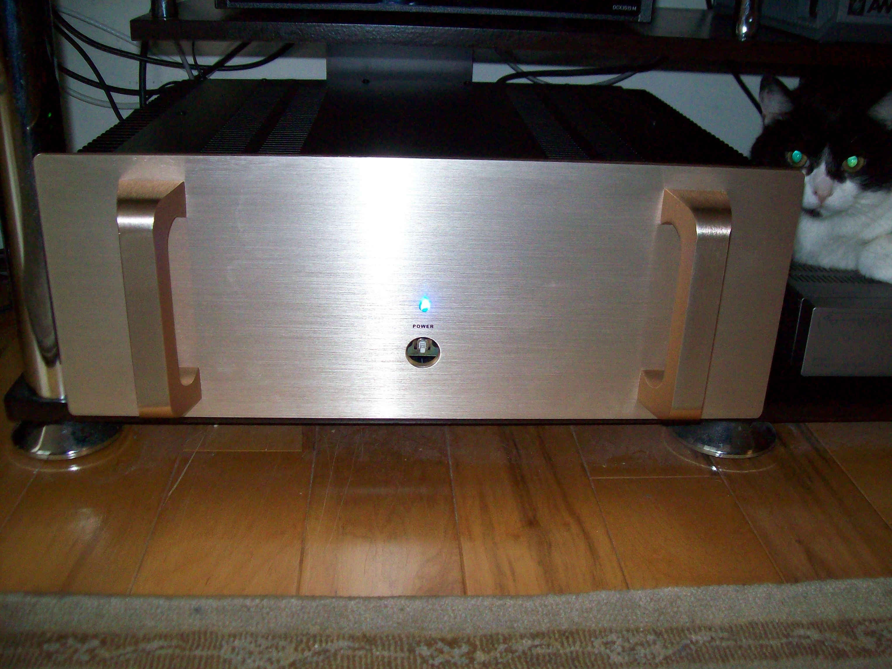

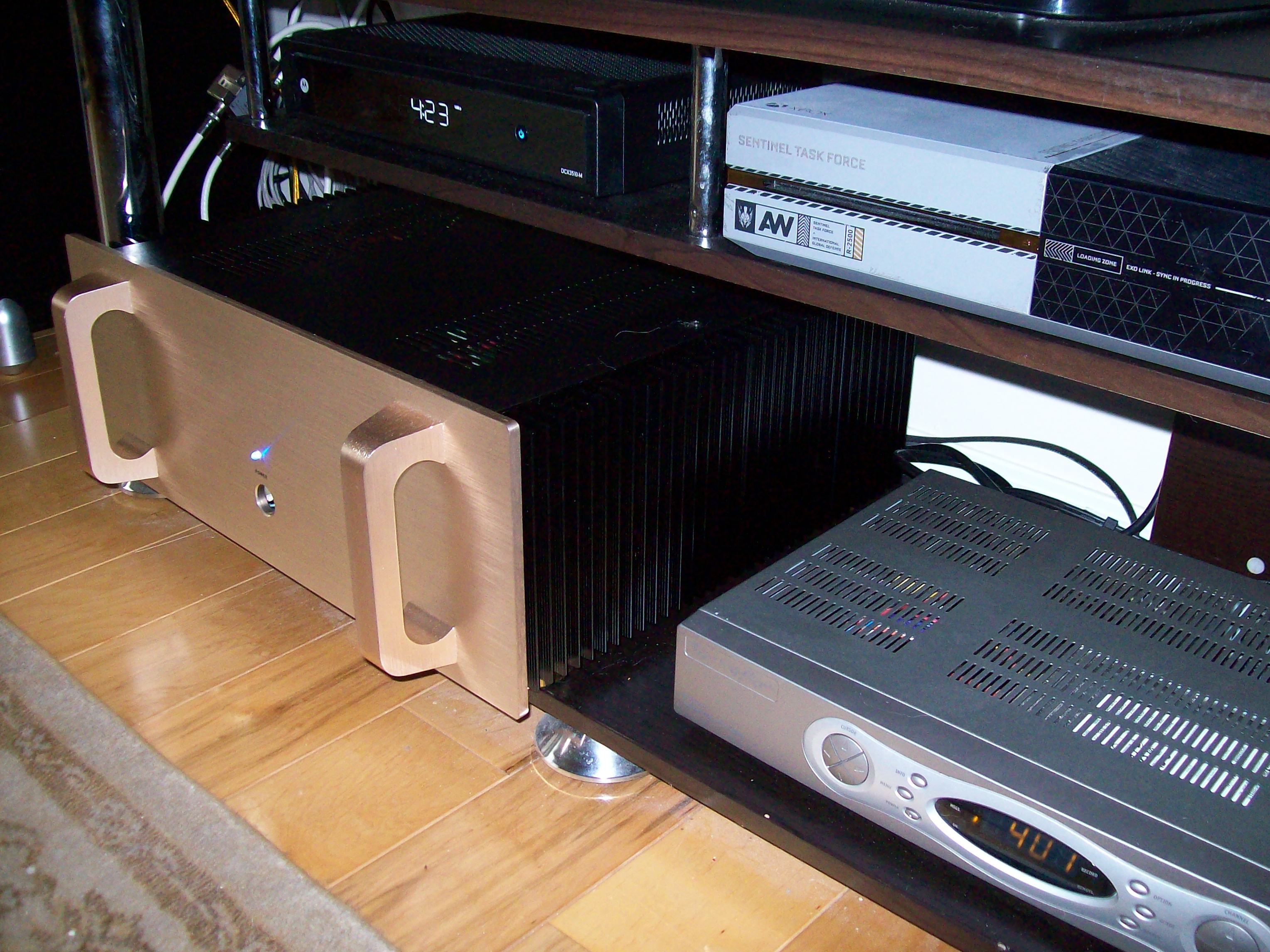

I used an AR998G chassis from DOUK store in ebay. It had a Dun Mei logo on it (which I removed). It was 108.00 US plus 78.00 US shipping. 4 heat sinks each 160x190x32mm.You have to drill and tap yourself. Use a drill press, I didn't and suffered thru it. The prices for this model vary with seller (there are a few). Amp runs at 53C with 400mv bias. I have included a couple pics (the cat likes the heat and won't move too far from it). I'm waiting for the pushbutton which was forgotten in the shipment. It actually came in a week, they said in their correspondence 3-4 weeks?
