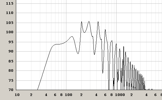

I'we previously given 15" TH's a try (THAM15), and 6,5" as well (THAM6), and it struck me that there's one pice missing, something in between the Large and Small so to speak, and here is my sugestion :
Now, remember, this is a work in progress...

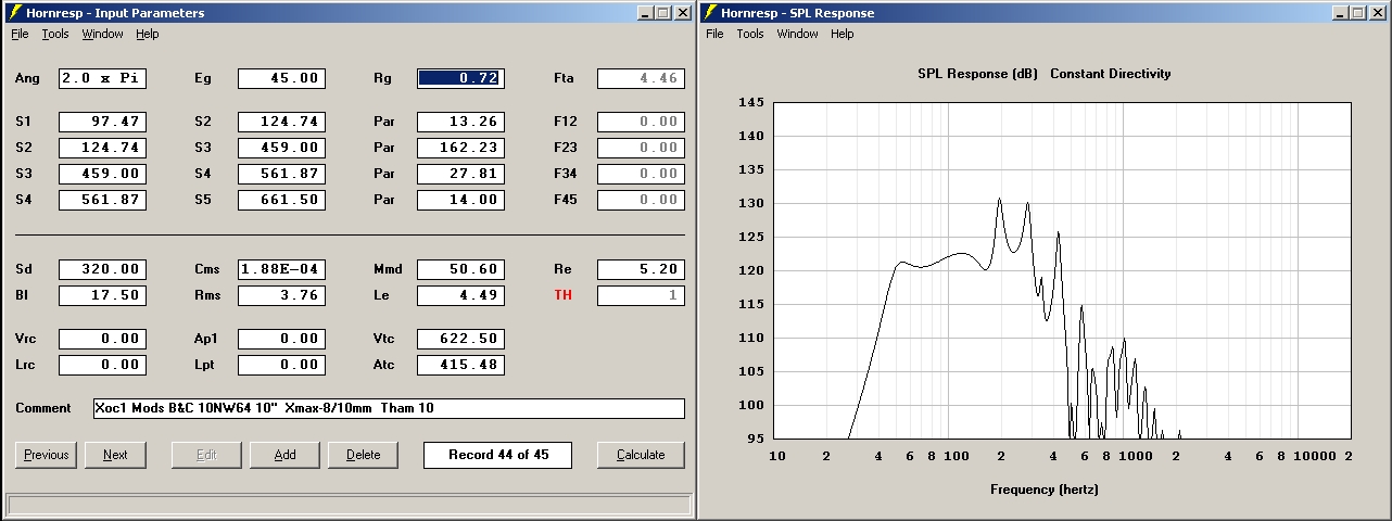

When loaded with the B&C 10NW64 the 2PI response at 1W looks like this :
The input window :
To show off, and really get the graph nerds going this is the response in 0.5PI 1W :
I want to post this in order get your take on it, remember it is still in development but i have reached a state where i feel it is prudent to go public with my findings in order to get some feedback.

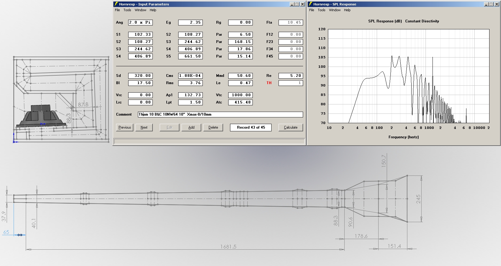

Here's the updated proposal, note the 45deg reflector leading inte to the front chamber, and also the 12mm distance plate at the driver.
My thinking is that maybe the reflector will help reduce turbulance noise, if any, and the distance plate with a circular cutout will reduce the risk of conedamage, and also (very perhaps) reduce compression effects.

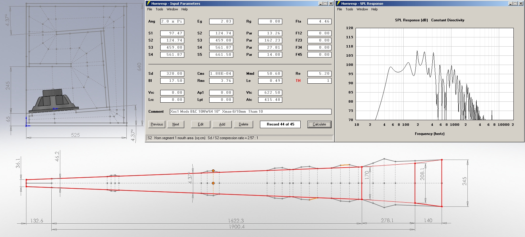

I get something more like this.
This was done in a hurry, so please check it all out yourselves. The 1000cc Vtc is just a place holder, as that would need to be adjusted for the driver. S4 would need the same adjustment offset.
Here is an HR FR pic, SketchUp file, and HR data file.

I'm not sure what to add.
The .txt file is about as close as HR is going to get to simulating that enclosure you posted. If you have problems with the mouth area then add the 31sq cm back in. It will not make a difference. It was there more as a reminder of the driver stuffed into the mouth of the horn. The Ap1/Lpt is the throat port you added, and the Vtc/Atc is the throat chamber you created behind it with the spacer, and the area in the cones dish space.
It is just a hurried run through to give you an idea of how to go about it. People can make what they will of it.
The .skp file is a Google SketchUp file. You would need the newest version of SketchUp to open it up.

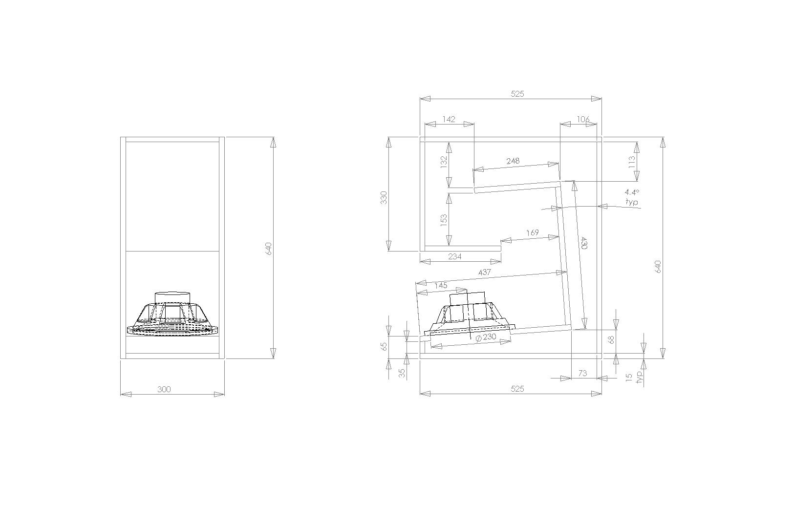

I have plotted out the unfolded horn dimensions for the Tham 10 as drawn.
Martinson, your hornresp sim is very optimistic the schematic volume of the simple 3 section sim is bigger than the external dimensions of the box!
The tapered section as drawn is very linear. The last bend is a slight pinch point but only by 2.3 mm.:D
Suggest you make your 92.5mm dimension on you drawing 90mm.;)
When I entered the parameters back into hornresp I got a plot very close to Soho54's post 7 plot. Unfortunately the efficiency looks quite poor - comparable with a reflex box of the same size. I tried to improve the cabinet but I think a radical rethink may be in order.:(

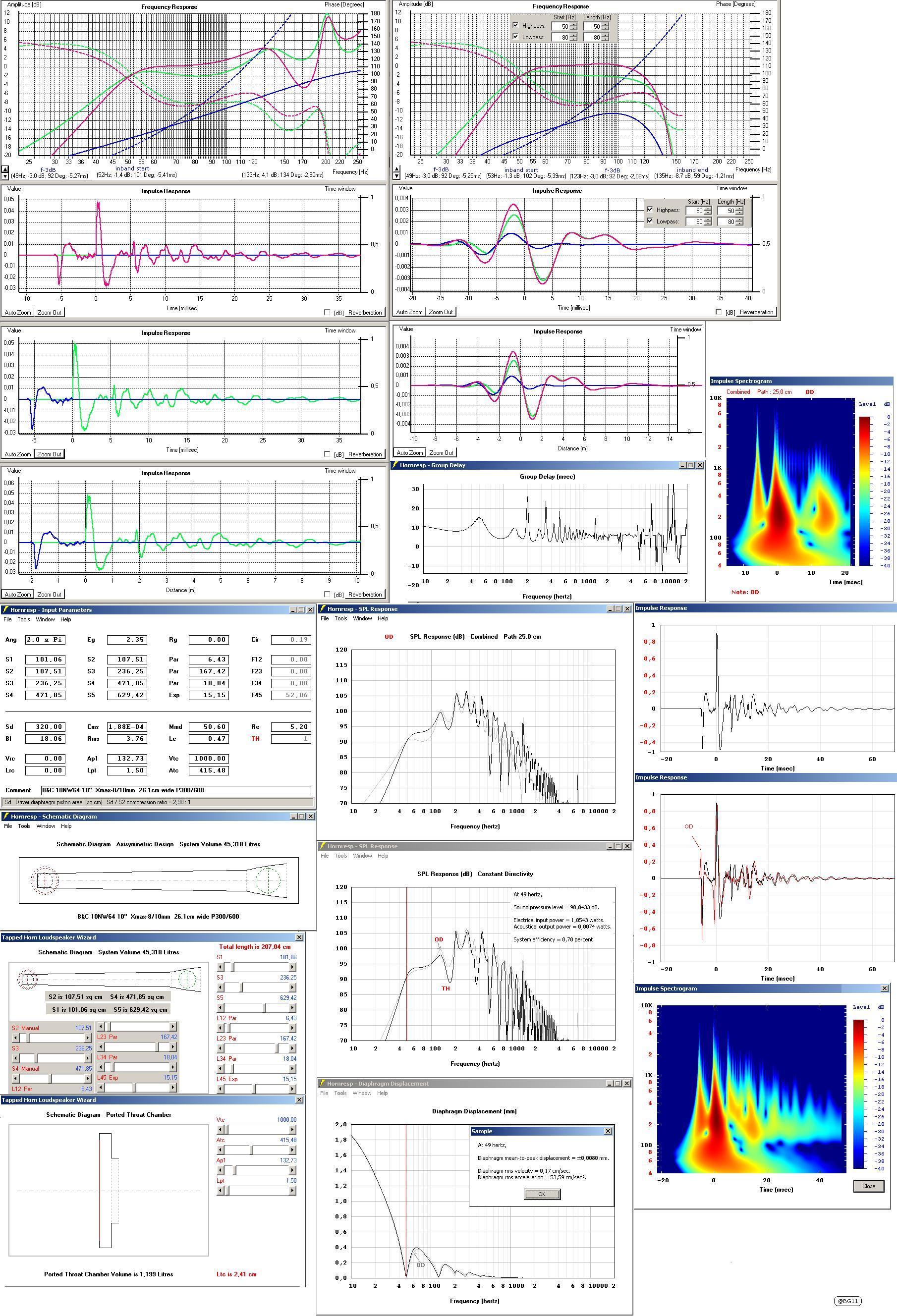

I found myself at a bit of a loose end today so I decided to develop the Tham 10 idea.:smash:
Firstly I took Martinsons orignal sim and folded that, regardless of the resultant size. So that the performance objectives are achieved.
I tidied the result up, and took out all the extras, simplifying the assembly.
Also attached a drawing showing sizes.
I then added a 4uH inductor to smooth the response. Sim at 45V 8mm Xmax
Hi pass would need to be around 45Hz:)

Thanks guys, this is exactly what i wanted to see, so back to the drawingboard it seems, i understand the differance better now, and i agree, it was a bit to good to be true.
There are no free lunches, if I'm to go compact i need to rethink my approach it seems.
Xoc1 : NICE ! although it is a bit bigger then i would have thought, what if we decrease the angle of expansion from 4.4deg to 3 or even 2 deg. ? i can not try this right now since i'm sitting in a hotell in mexico city.
