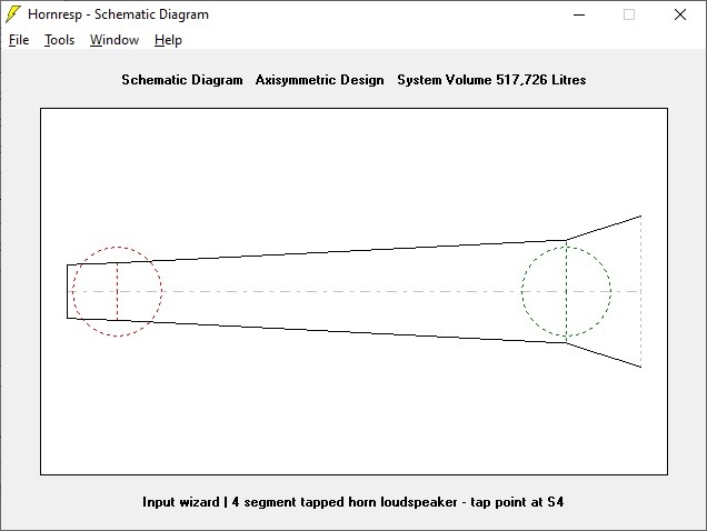

Been playing around with the filters in HR to get a flat response and high/low pass filters inserted. Looks like I need about 1.4kW to really push the driver to the limit in this enclosure. 2kW leaves a little headroom, about 1.5dB.

135dB in hornresp should result in very decent bass in a small room (full on vibrating things off walls feeling of pressurization etc.). I meant with multiple drivers that multiple drivers would share the same enclosure, not very money efficient but seems to be the way to get the most output from a given volume. For amplifier power its easier to think about it in terms of the voltage you need. We are using these amplifiers: https://www.gisenaudio.com/high-efficiency-power-amplifier-with-high-power current pricing is 660 Euro for the D421, you would need 230/240V power to make an amplifier in this kind of power class worthwhile, we fit them with 32A connectors.
