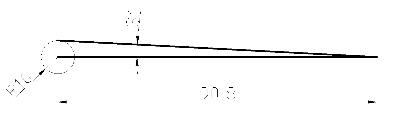

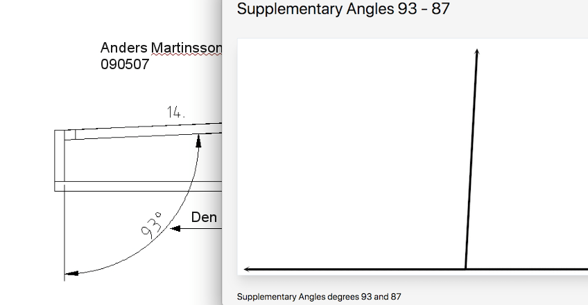

I am building 2 x Tham 15's I have ordered the Baltic Birch ply plus the cutting which will be ready the end of the week. The one cut they cant do is the 93 (or 3 degrees ) degree edge for the speaker panel. Can anyone advise on how I can cut an accurate 3 degree chamfer across this edge ?

The supplementary angle of 93 degrees is 87 degrees, which is 3 degrees less than a 90 degree angle.
An 87 degree angle can be cut with any adjustable angle saw.
I dindn´t even think about a 93°angel , I just cut it from the other side with the adjustable saw.

tangent of 3 degrees is .05
that's run/rise of 1 in 20.
use a shim to prop up the appropriate end of the workpiece at the appropriate distance and make your cut
using a hand-held circular saw you can tape the shim to the tool platen instead.
but all these power tools should be angle adjustable anyway...
using the same math, 3 degrees across an 18mm edge is less than 1mm
