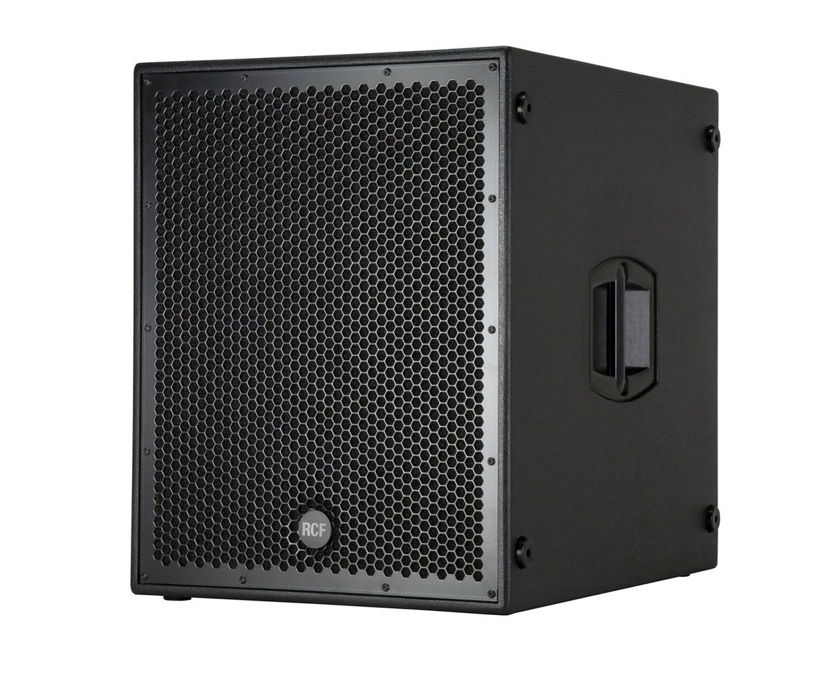

Where you can source the round perforated metal grilles , black powder coated preferred , so your cabinet will have a "pro" finish.
Qsc KS118 , Yorkville LS1208, RCF 8004
To name some finished cabs.
RCF 8004 have a frame screwed on top of the grill to hold it. And I guess a gasket strip is out before the grill then the metal frame screw on top of the grill.

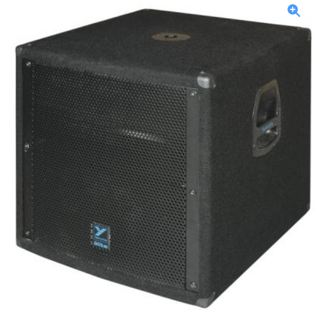

I found the same scheme on the Yorkville LS608's
But there was only 2 strips of metal on the sides holding the grill. No rattle at high volume cause the ruberish kind of strip that goes on the wood before the metal.

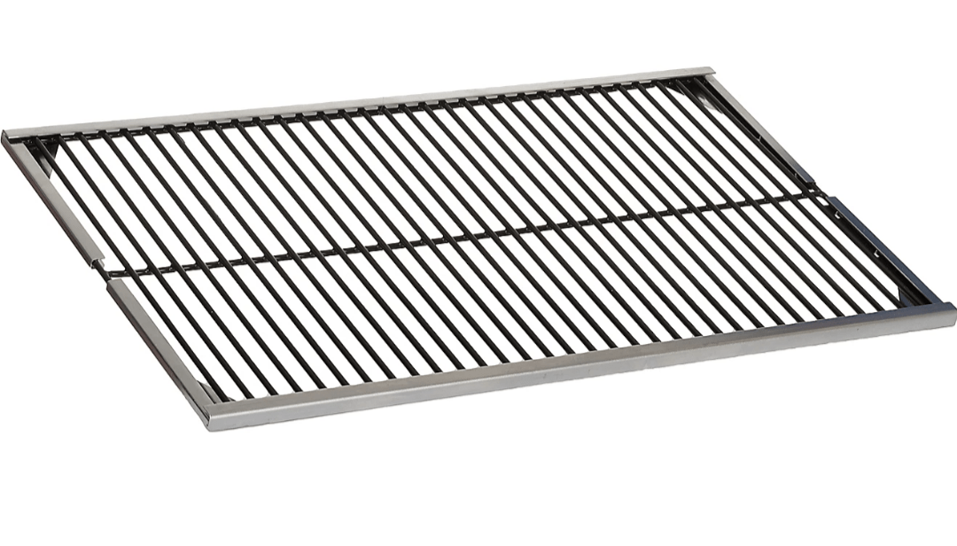

I don't really like what some people did installing BBQ style grills 😵💫😆

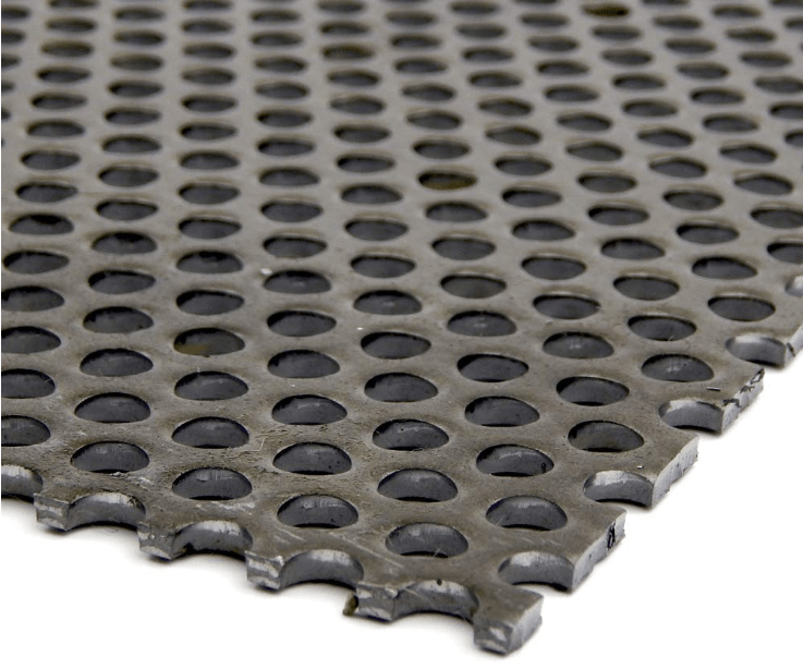

i found some on amazon 24" by 24" , since the mouth of the cabinet is around 19" by 20" that sheet will fit with some trimming
what gauge # will get closer to the commercial cabinets so to protect the driver inside

0.036" Thickness, 20 Gauge
0.06" Thickness, 16 Gauge
0.12" Thickness, 11 Gauge
0.12 thickness will protect the speakers from hard hits while still enough to flex a little under pressure without breaking, the other two are way too thin

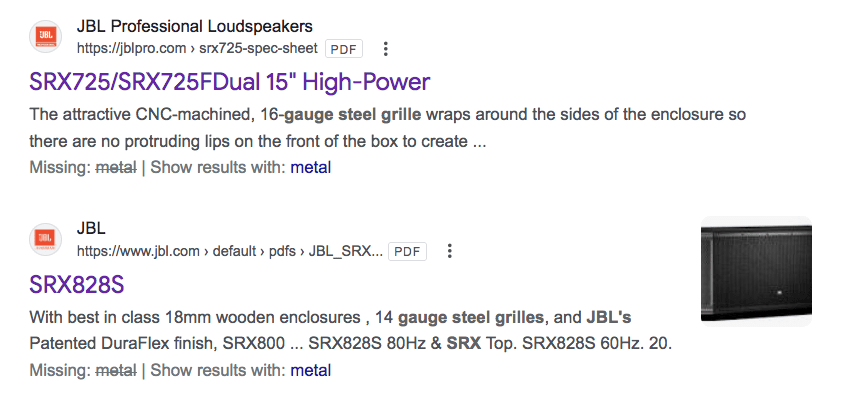

i guess i will use 16 as 14 is not available.11 gauge is over the top.
JBL uses 16 gauge grille on many of their 15" cabinets, 14 gauge on 18" cabinets.
