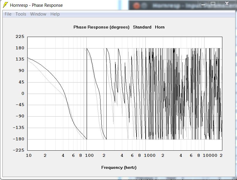

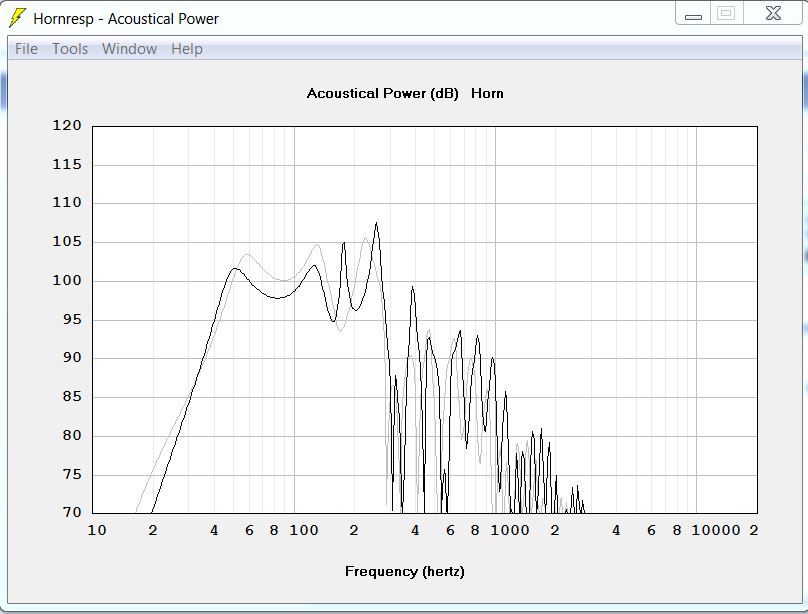

Here is the simulated phase and spl response of the THAM15 with a B&C 15TBX100 (black) and THAM18 with a RCF LF18X401 (grey).
Driver selections is because I used simulations I already had in Hornresp.
I would not hesitate to use THAM15 and THAM18 side by side if I already had them. I would prefer to use only stacks of 4 THAM18, since this is the intended usage for them.
