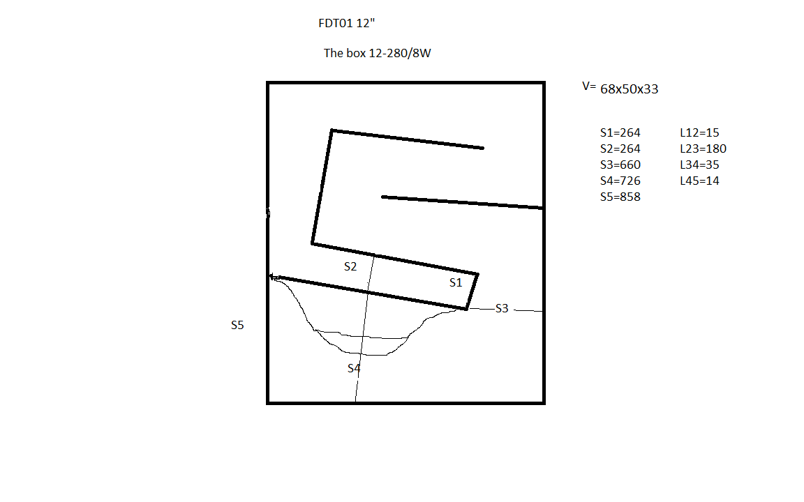

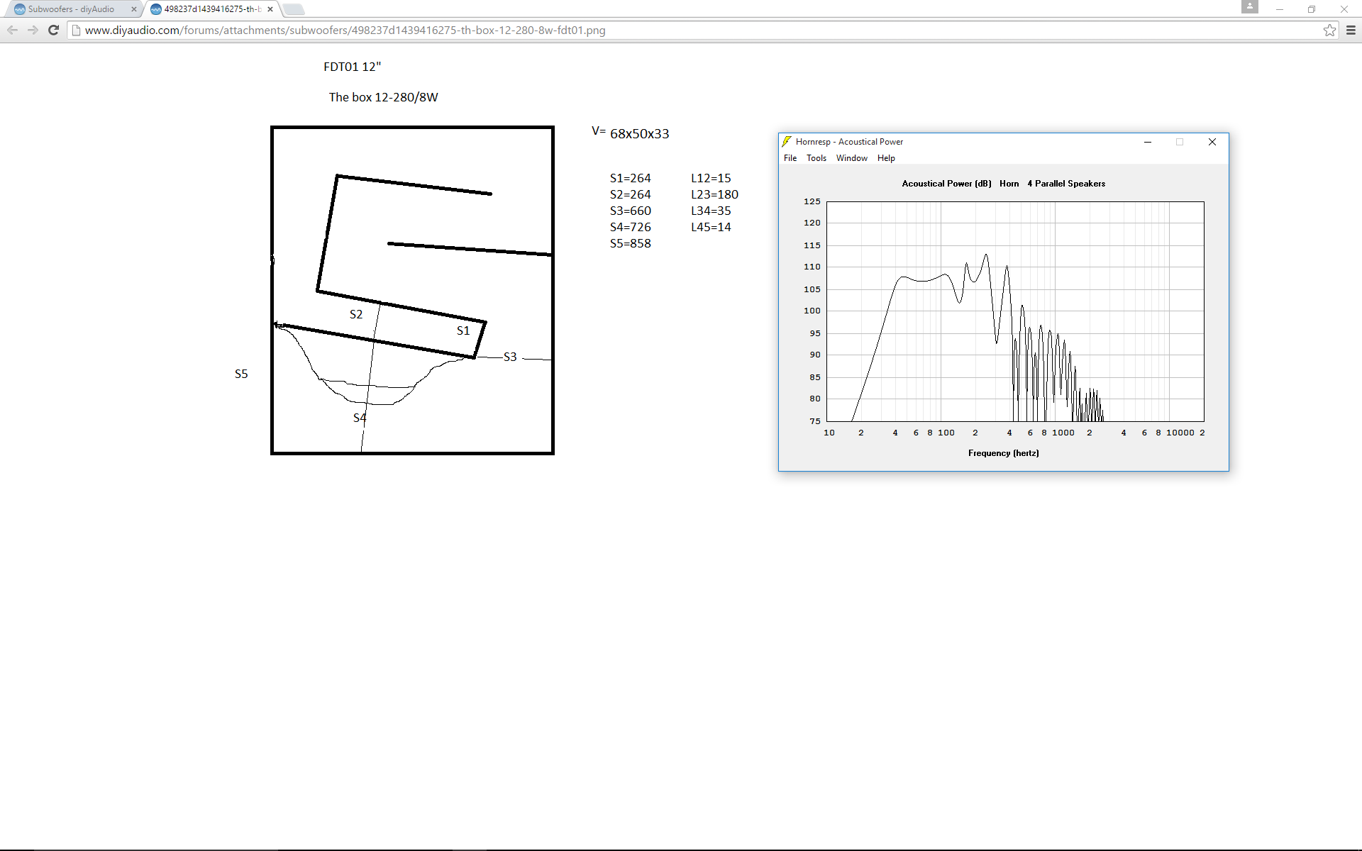

fdt01.png UOTE=tetrapol;4418679]TAPPED HORN AVEC LE THE BOX 12-280/8W[/QUOTE]
bad design , with the trapezoidal output does is correct a curve with a depth of nearly -6db in 60 hz .
with a more appropriate design and less liters you have an answer as well or better . For example the 18 xoc1 , danley 18 th or you want a similar design danley th412
WELL YOU VIEW ? NOTES RESPONSE HORN . THIS TEXT IS A COPY AND PASTE ON MY OPINION OF KEYSTONE PROJECT . THIS POST IS ON FDT01 12 " . IF YOU HAVE ANY TECHNICAL CONTRIBUTION BUT write it forever hold your peace .

I have only found two projects with this driver . MTH 30 and JM212 . ( bass reflex )
This driver has a FS = 37 Hz
Xmax . = 9.5 mm BL = 21 . It is suitable for tapped horn and bass reflex 40Hz .
Xmax = +/- 6 mm
