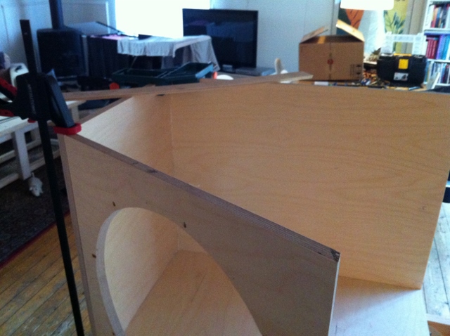

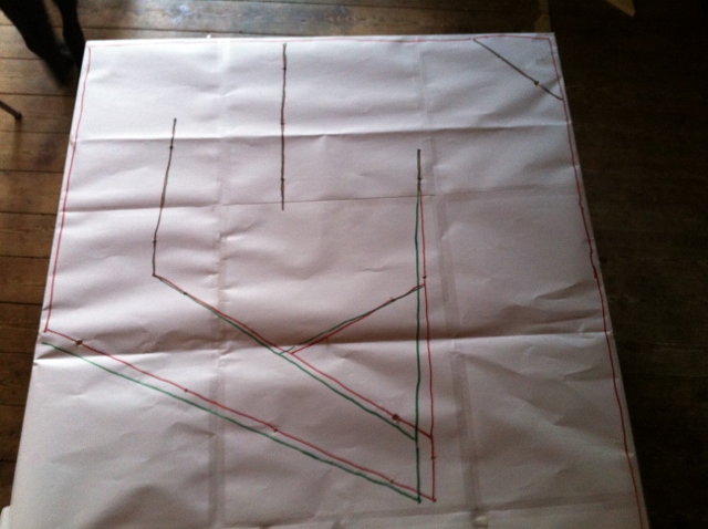

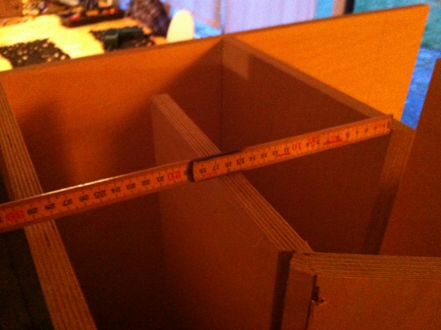

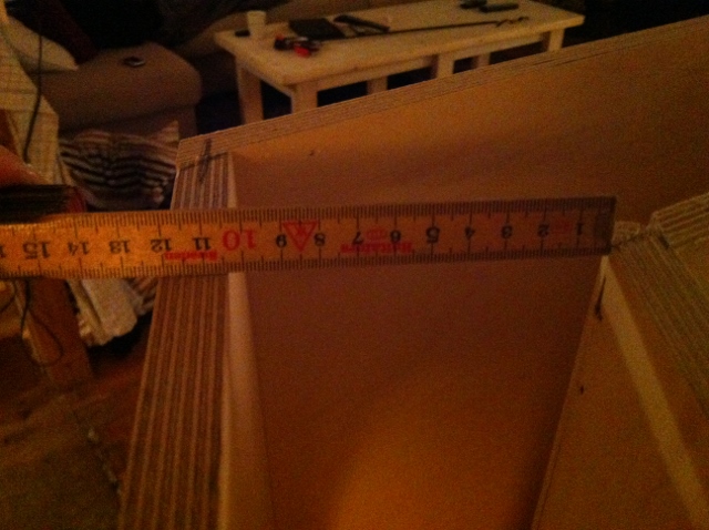

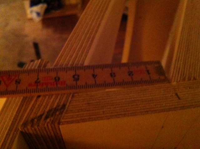

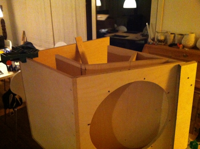

Another build of these cabs only just done in Denmark.
I am doing 2 pairs of the version 1 with cone correction from CRESCENDO.
I am using b&c18sw100-8.
Unforfortunately in the first build I wasn't paying attention and put the baffle wrong. I am using Baltic plywood so a rather expensive mistake 😱
I think I managed to keep the S1 and S2 fairly within the measurments, but I would really like to know if someone could help me find out how far off the performance will be approximately since the horn path is not exactly as per the original design. It doesn't have to be exact just a hint on whether I should trash it or if you think the performance is going to be ok.
I don't know if you can make out the mistake from the rather bad pictures:
And this last one only gives an impression of the differences btw. the first and second build, the second build being the blue.
I have more pictures of the builds if you like.
I have not yet done any serious testing, but first impression with this first build comparing with a 200 litre reflext cab with b&c18ps100 is that it goes noticeable louder and has more kick in the 80-120 hz region, but I am missing the low end <60HZ. I am hoping that it will change when the driver is broke in.
I will put a driver in my second build this weekend and check by ear if there is a big difference.

Build tips:
Make sure to use pl premium type glue, not normal wood glue, as it will cover up a lot of your mistakes. With a cabinet this big, don't expect your cuts to be perfect, or perfectly right angles, or the boards to be flat. Triple check all of the angle cuts to make sure that you are cutting the right corners, I messed this up a few times and had some waste. I would suggest that you use the nice wood, not MDF. I don't think MDF would be very stable in something this large, and it would be impossible to move.
Make a cut list before you start cutting, and use it. Get all of the weird cuts done first, and then set the gate to the width of the cabinet and cut out enough long strips of wood from your 4x8s to form all of the inside parts. This will ensure that they are all the same width, which is a very hard thing to fix after the fact. Just double check it every once in a while to make sure it isn't drifting off the target. This happened to me, and I had to spend a ton of time using an electric sander making the edges level enough to let the side piece sit flat.
Save the driver cut out and screw it just in front of the woofer in the high compression part of the horn - this is a rough but easy and not too terrible driver volume compensation. There is a lot of debate as to whether or not this kind of compensation helps, so I figured what the heck how bad could it be...
If you have the patience, paint the thing before you put any hardware on the thing - I was impatient and just finished them off before painting and I ended up wasting a few hours masking everything.
If you don't have a good pneumatic nail gun, now is the time to invest in one. It will make your life infinitely better, and you will be able to use it for many projects down the road. Also a good jigsaw is a must have.
One good trick is to sketch out the design on one of the sides, and then build it on top of those lines. Once it is all done and you are ready to attach the other side, grab a large piece of butcher paper and trace all of the exposed edges that need to be glued/nailed to the top. Once they are traced, remove the paper, apply glue to all of these edges, and put the piece of wood flat on the glue roughly in place. Make any small adjustments to the side while you can still slide it around on the glue, and nail in two of the corners. Put the paper back on top, being sure to line it up correctly with the corners, and tape it down. Now you can see all of your trace marks that show where the wood is underneath, and you just have to go around it with a nail gun. You can generally feel when it misses because it makes a different sound, if that happens, just adjust a little bit and shoot it again. If this doesn't make sense, just watch the video carefully and you can see me do this.
If you are confused on any bits, I would recommend watching my timelapse a few times. I think that it was my third one, so by the time I recorded it I had already learned from my early mistakes and had a pretty good system down.
Oh and I of course recommend blasting some good EDM (Chase and Status is a good starting point) while you are working to get into the mood
If anyone has specific questions feel free to ask!
*Edit* Sorry if there is any fail grammar... it's 2:30am here...
