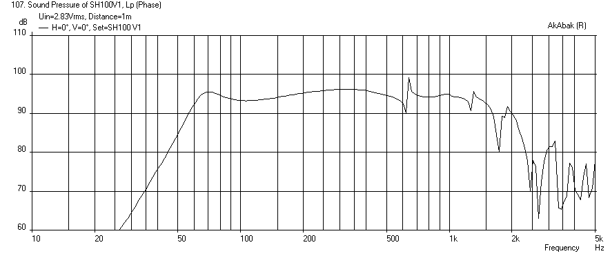

It's getting OT here so maybe I need to start a new thread for the SH100-inspired speaker in the Multiway forum. Here are some preliminary results with the Eminence Beta 8CX though. The box is 20.7 in (W) x 20.7 in (H) x 9.0 in (D) with qnty 4 x 2.0 in dia x 4.0 in long ports. Use 18 mm thick plywood and adjust the internal volume to 1.14 ft3. Line with walls with fiberglass. Make the horn from 4 panels starting at 7.13 in wide at the throat where the driver is backside mounted and 14.0 in at where the horn mouth exits the box. The axial depth of the 4-panel horn is 2.41 inches (you will have to figure out the cut outline using cardboard prototypes). This gives a 110 deg coverage per the specs of the SH100. The Eminence Beta 8CX is a nominal 93 dB sensitive driver and this will achieve +/-3 dB from 70 Hz to 2500 Hz in this ported config. Couple this with an appropriate crossover like the PBX2:2k5CX and a compression driver like the ASD1000. You will have to pad the CD to match the 93 dB output of the main driver. The main driver's mids are enhanced by the horn mouth and may need a 6 ohm resistor strapped in parallel with the 2 mH coil on the crossover to flatten the rising response.

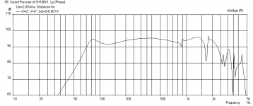

Here is the freq response of the bass driver far from walls and at a height of 30 in above the floor.

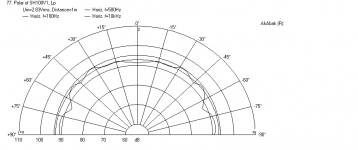

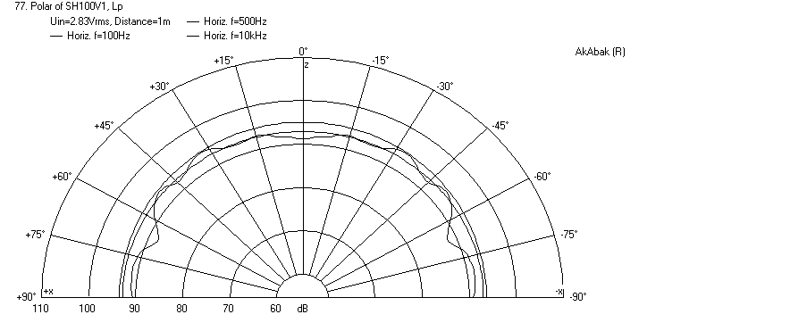

Here is the polar response if we put a typical CD into the main unit. I modeled the horn using the dimensions of the Beta CX internal horn and paper cone as a secondary horn leading to the final 110 deg 4-panel horn.
It looks like it has very uniform dispersion from 100 Hz to 10 kHz. Appears to be a relatively easy box to make once you figure out the horn panel cuts. Good luck.

Very cool I have seen the 10" CX is the best of the lot between the 8" 10" and 12" drivers . how different would the box be for the 10" cx driver?
For the beta 10CX, if you scale the box to 26 in x 26 in x 12 in deep, use qnty 4 x 3.0 in dia x 6.0 in long vents, make the 4 panel horn go from 9.2 in at the driver surround to 17.5 in on an edge at the mouth exit over an axial distance of 3.0 in you get this for the freq response. It is now 95 dB efficient and the bass extension goes to -3dB at 60 Hz. Any more discussion and I will post a new thread.
