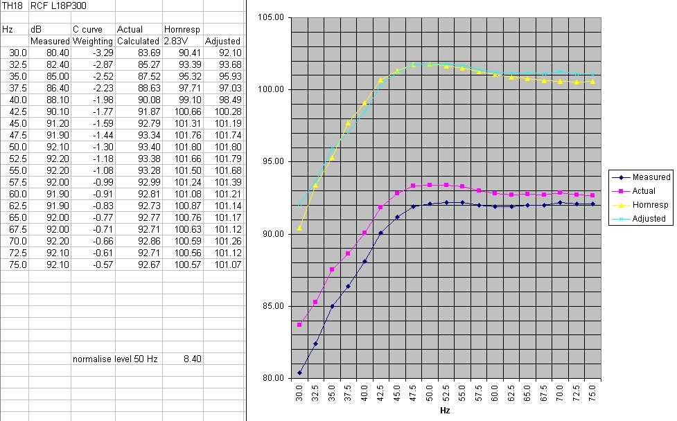

I did manual spl measurements with REW using the generator to generate a series of frequencies and wrote down the spl meter reading
results are much more realistic and inline with previous measurements of others.

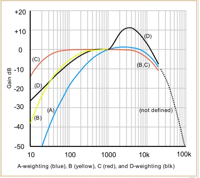

"C" weighting rolls off a bit of the low frequency.

I have done some more analysis on Ljk11,s excelent measurement data.🙂
I used this web based calculator to compensate for the C weighting at the measurement frequencies.
dBA - Calculating weighting filter frequency to dBA and dBC DIN IEC 651 calculator equal-loudness contours - sengpielaudio Sengpiel Berlin
and added the values to the spreadsheet.
I then added the values for the response as simmed in Hornresp@ 2.83V
Finally I added an offset to the response curve to normalise the response to the hornresp values at 50Hz
The Measured values are surprisingly close to the Hornresp Sim!
Unfortunately the RCF L18P300 is not really ideal in the TH18.

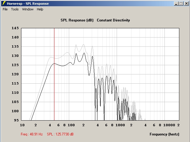

Not accounting for any compression losses,
X max 7.8mm is reached at approx 250W (44.72V)
PD1850 11.25 mm X max is reached at approx 800W (80V)
The difference when both are driven to Xmax is charted in the Hornresp screengrab, RCF is Black PD1850 is grey......😉
Regards Martin (Xoc1)

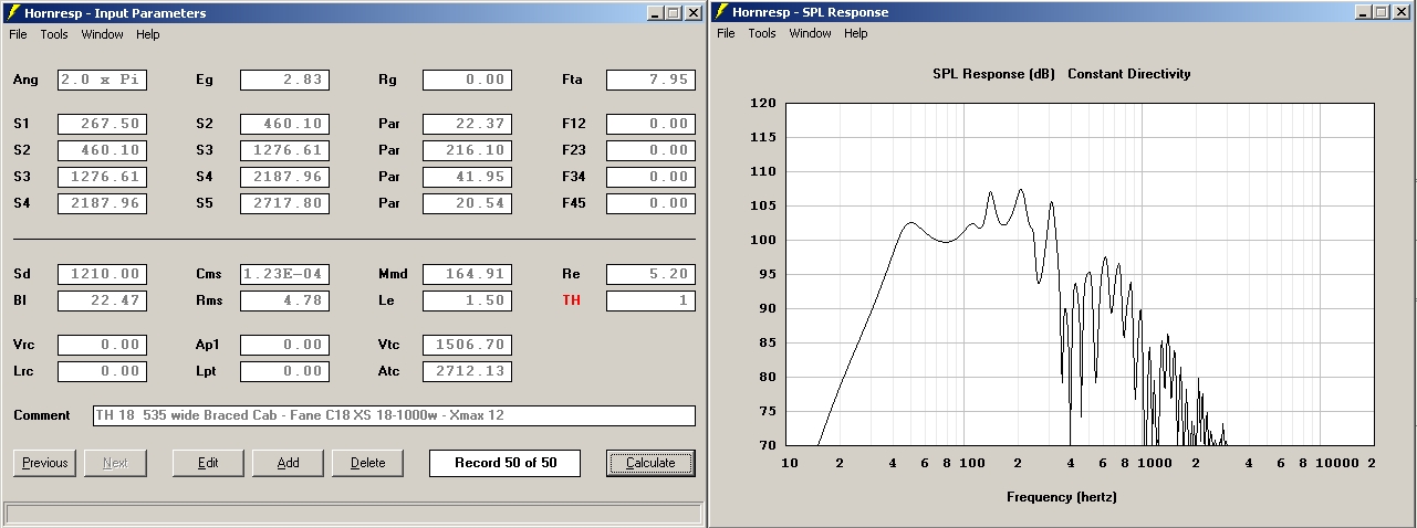

I am looking to build 4 of these I have heard the TH18 of Danley at Orlando InfoComm past June is sound great tones are detailed. I cant explain it it just different from what I am used too with folded horn cabinets CV L36 I've used for a long time for mobile. these TH sounds smoother although requires more amp power and Xmax. Would the new Fane 18XS be good for this cab X 4??? Thanks!
The DSL TH-118 sounds smoother because it is smoother and goes lower than the CV L36. It is also louder with less power, though can take far more power with far less thermal compression.
If you like the way DSL-118 sounds, use the speaker DSL uses, the BCSW115-4.
