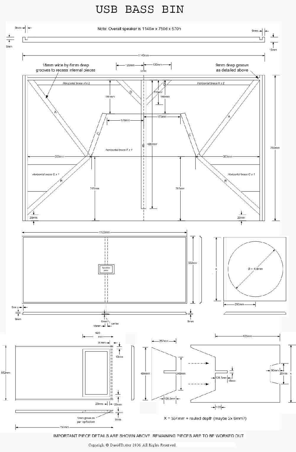

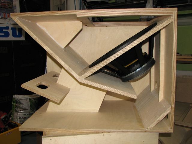

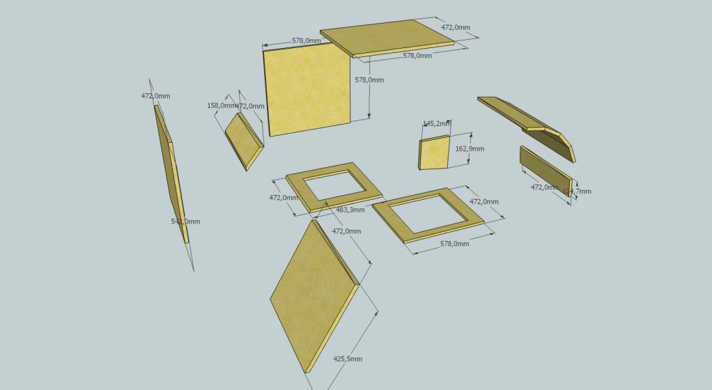

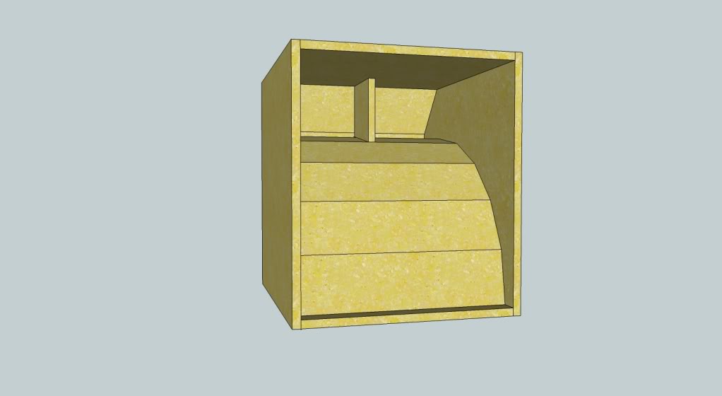

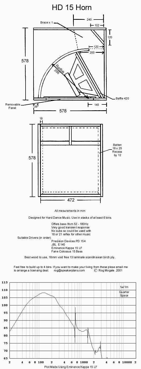

hi all also can i use dual hd15 horn or dual usb horn as midbass to accompany the xoc th bass ???

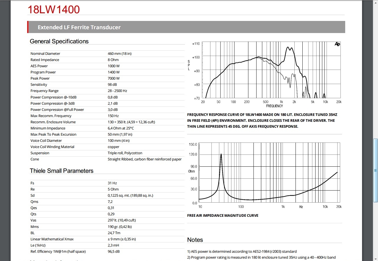

For this speaker fs: 31 Hz. Is it okay if we make a pass at this frekans 31hz Need something else? RCF 705 datasheet te 100-105-140Hz, for example, if we have this pedestrian with 31hz we can run this speaker? My aim is to keep the EAW SB1000- SB850 speakers

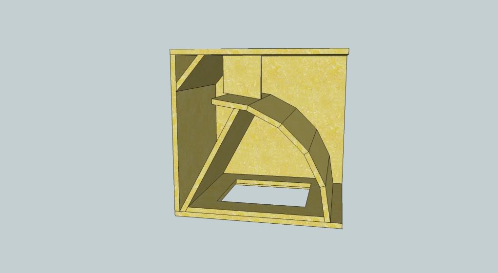

No I have never up-scaled a TH18 to fit a 21" speaker. Its difficult enough getting the 18" to fit. Increasing the baffle size would change the geometry and then it would probably take ages to get everything optimised. There is an up-scaled version of this TH fold in the Flat to 30 thread. Still a 18" driver but shows that an increased size is possible

Hi Martin have you ever considered doing a 21" version of your TH18? excuse my ignorance as ive only just started learning hornresp but how would you go about scaling up the TH18 to accommodate a 21" driver like the BC21SW152
If anyone else would like to shed some light on this please fire away.

Adam,
As mentioned by the designer, tough.
Josh Ricci's Othhorn is a really good TH for using the B&C21SW152.
If you wanted to build a TH using the B&C21SW152 with a similar response to the XOC1TH-18, you could use the Keystone design pretty much "as is". The depth of the 21" driver might require it being flush mounted to the throat and a bit of recess at the mouth to fit.
Increasing the 26.5" Keystone cabinet width would increase sensitivity, but experimentation with the exit shape and size would be required for optimization.
Increasing the Keystone cabinet height from 45" to 50" ( the "B-Low" version, still not completed) puts the low corner at around 30 Hz (29 Fb, so solid response to the upper 20 Hz range) response compared to 37 Hz, takes a sensitivity loss, but is quite a bit smaller than the Othorn, and way easier to build.

Thanks Art i will have a look at that. Ive been looking at both the TH18 and the othorn but cannot decide on what to go for. My last build was off 18sounds websites (dual 18" reflex cab) but i want more punch but with good extension and better throw... decisions decisions

There are a few good TH's on this forum which will yield about +6 dB from each driver compared to the equivalent BR cab of half the volume with the same driver.
Whats important to know is what tops you have to meet the sub, and what music you play(how deep you need to reach) to give you any advice :)
Also, one can adapt the Othorn geometry to be 40*40*24 with something like the Tham folding scheme and could use the 21SW152 with good results getting the same sensitivity as Xoc1 th18 but with a low corner of 27 hz so it could yield 2-3 dB over Othorn. Also if you would like to build at least 4 you could go a bit bigger to 45*45*28 same as 12Pi with single 21 or dual 15
