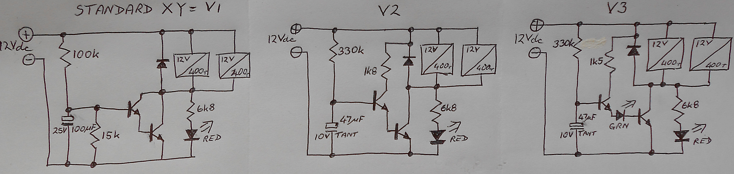

XY speaker delay circuit
Here is the standard and two modified versions of the XY PCB and kit.
V2 has omitted one 15k. This 15k in V1 increases the delay period. So much so that it can prevent triggering. Check the current through the 100k and then the current through the 15k. A big leakage in the 100uF will prevent any current entering the transistor base. A larger value, 20k to 100k, could be used to adjust the delay period.
In V2 and V3 the delay adjusting resistor can be put back in too. I'd suggest >>30k for periods longer than ~3seconds.
The dual EF ensures the switching transistor is saturated (hFE~10) and drops <0.1V when ON.
The Green LED gives a visual indication of base current into that transistor and raises the voltage on the timing cap by about 1.9V

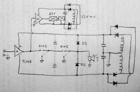

I've never used electro-mechanical relay based dc protection before. So recently, I was curious. And I wanted a small pcb to finish off the TGM7 project with minimal fuss. I also thought it would be a good opportunity to take a serious look at the challenges of an electro-mechanical relay based system as I've always shunned them before.
So here we are today, looking at electro-mechanical relays. They are an old technology, well mature and highly engineered. Can we get them to work for us ?
Ignoring concerns about their affect on small signal quality, as far as I can understand it, the real issue is not the relay at all. The issue is the inductive load of the speaker. When the current to the speaker is interrupted the magnetic energy stored in the speaker coil collapses and appears as back emf. This back emf can be very high and it appears across the gap of the relay contacts as they open. This back emf causes breakdown ionization of the air in the gap and allows current flow. The ensuing arc, if high enough current flows, potentially damages the speaker and relay contacts.
The relay coil is another inductive load and we are all familiar with the flyback diode used to protect the semiconductors that are switching the current to the coil. 4QD-TEC Electronics Archive
So why not add catch / flyback diodes to the speaker load too, near the relay contacts, to provide a shunt path for the back emf - thus preventing the arc from striking in the first place ? - see my rough sketch (attached) - I'm talking about D1 and D2.
The catch diodes will certainly limit the back emf.
That's why we use them on the output of our power amplifier.
Using them on the other side of the relays may well help. They are often fitted inside the SS relay and inside the mosFET we use for our DIY relay.
Is that enough?
Is that enough?
The best approach is to test it. I should have ordered an additional board for what is potentially destructive testing. But it does seem on paper to be a workable solution. I even wonder now about adding such catch diodes to the output relays on my commercial home theatre receiver...
