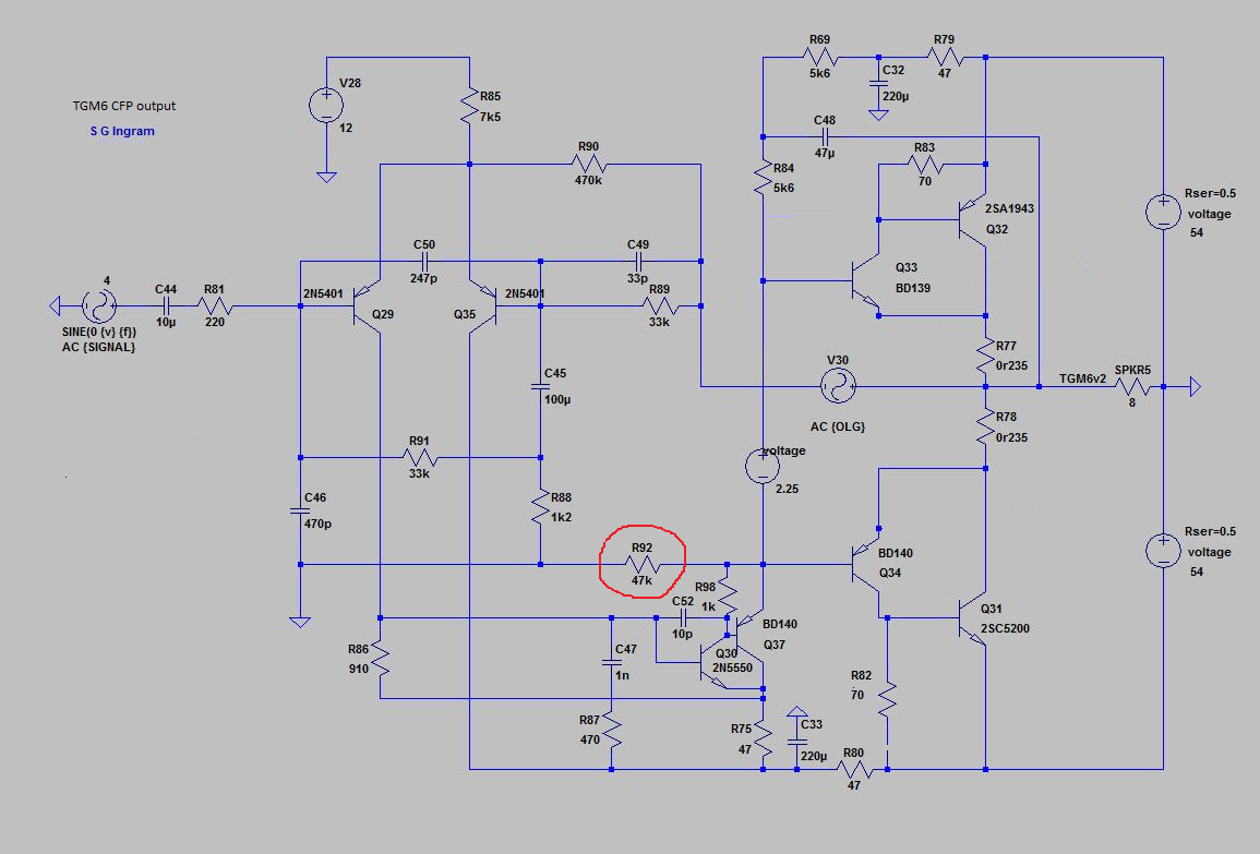

As I have some of these Sanken Darlingtons, the type used in the Pioneer amplifier, it would be really handy if we had a proper Spice model ?
I've resorted to a discrete Darlington for my spice modelling of this circuit. I've attached the file.

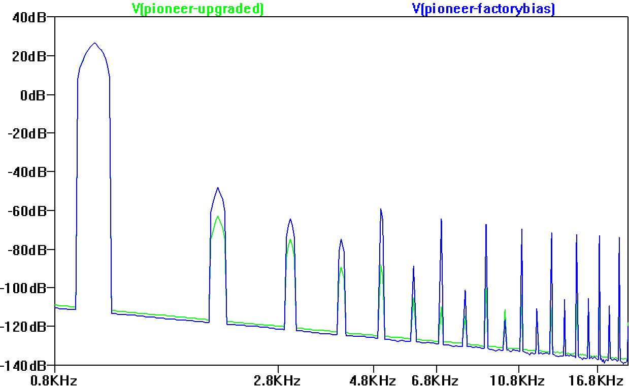

Also posted up is the FFT profile showing the 'before' and 'after' of my upgrade. The THD drops from a low number to a lower number - mostly besides the point, what I like is the drop in higher order harmonics (the 5th is already 100dB below the signal). But without proper device models it's a bit iffy.

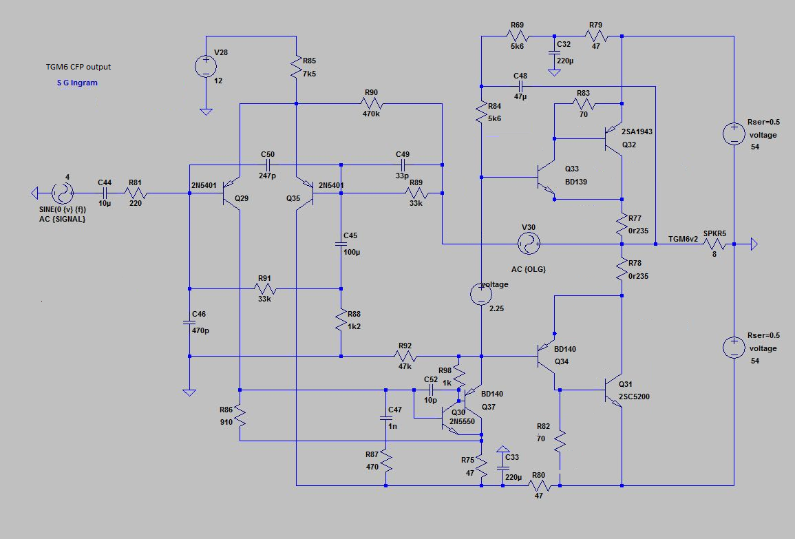

Interesting, a kind of P3A with CFP VAS. I think it will sound differently to the TGM8 but not sure if it will be better. Do you have plans to prototype this ?
Bigun
If there is a buffer in the VAS, the resistive load added to the collector VAS (47k), is needed.
VAS+buffer = 47K?.You could eliminate 47k?
Joined 2009
That 47k, if I remember, was there to bootstrap the LTP collector load, increasing it's linearity and the open loop gain of the amplifier. This is something you could eliminate so that it's more in line with the lower open loop gain of the P3A.
Joined 2009
ah, got it. That was a Pioneer feature. It likely was part of their overall NFB stability compensation scheme. I can't advise whether this is something you want or not. In my own designs (rather than Pioneer) I don't use this approach and don't recommend it in general.
The 47k loads up the VAS, at the buffer of the EF, but unless it's at the VAS collector, it won't much reduce the loop gain. The EF has a Zout of around 6R, so 47k is merely bagatelle, particularly as the bootstrap is very high impedance, an easy drive. Hmmm....😕
