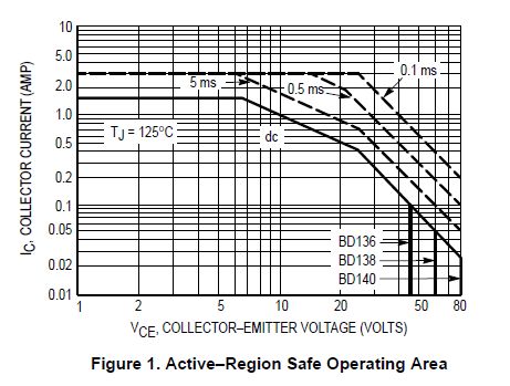

I'm still looking for opinions on how hard to push the Vceo for a BD140 ?
it's rated at 80Vce0.
I cannot recall seeing data for SOA de-rating for the higher voltages (>=20Vce) nor for the shorter transients (<=100ms).

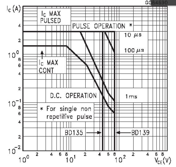

The datasheets for both the BD139 (first graph) and BD140 (2nd graph) don't indicate any de-rating required for Vceo at the current levels I'm contemplating using it at. What I don't have any experience of is whether I'm courting trouble stressing it during clipping at max Vceo, or whether the manufacturers tend to be conservative with their ratings in this regard. For normal listening levels the device will see much less than the max rating and I don't plan to use it as a guitar amp with lots of clipping going on.

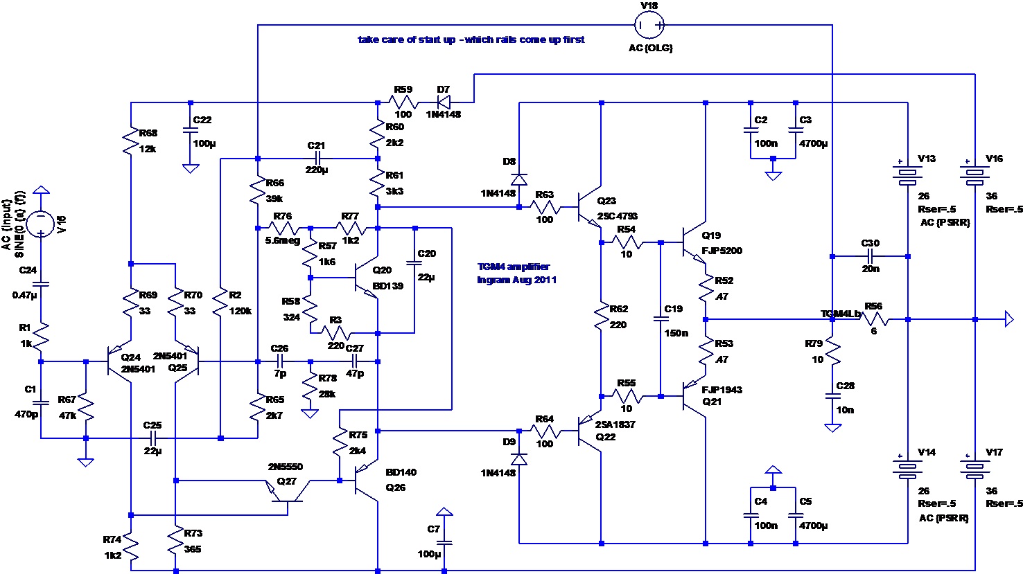

Any good reason I shouldn't build the circuit upside down, npn for LTP ???
Npn LTP is good as well....🙂
Joined 2009
My thought with the upside down circuit was to allow future experiments with a triode LTP (see attached). The trouble is, it's getting bit tight for space in the chasis for tubes and heater supplies.
The 2nd attachments shows the more-or-less final schematic in a conventional arrangement. Compared with what's indicated here, I will use lower Cob devices for the VAS since this is a known opportunity for improved sound, and also a higher hfe device for the Vbe multiplier, for a marginal improvement in bias accuracy.
I'm considering using two output pairs for better linearity into more difficult loads and some small adjustments to the output topology may be explored before finalizing.
Should I be worried about noise in the high valued feedback resistor from the VAS ? I've shown a fairly high value of 5.6M but this will likely be reduced to the range 1M to 2M if listening tests confirm a benefit.
Note the additional resistor, R2, in the feedback network. Hugh tells me that it has beneficial effects on the sound (I believe this topology was blabbed in the 'baby aksa' thread) so I will include it here. A side benefit according to Rod Elliot maybe improved transient recovery [Power Amplifier Clipping ] . I may implement a larger feedback cap.
