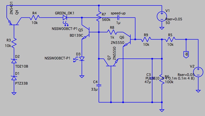

You need some circuit, that rapidly (in less than 10ms) switches MOSFET on when voltage cross over ~6V, and turn off when falls below ~5V. Shmitt trigger is one of possible solutions.
OK, I have simulated a speed-up option on my circuit. The simple addition of a capacitor and some different values for existing parts. There is a tradeoff with the slow-turn-on time, to avoid hearing power-on noises but it looks feasible to improve the turn-off time quite a lot. I think it can achieve 3ms to 5ms.
This capacitor is a kind of Schmitt trigger, i.e. positive feedback.
