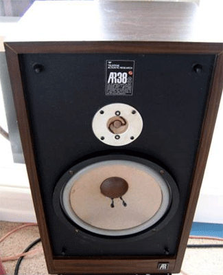

I will disclose that my current employer made the items shown in the attached photos (I used to own a set of those AR38's until the foam rotted out)
