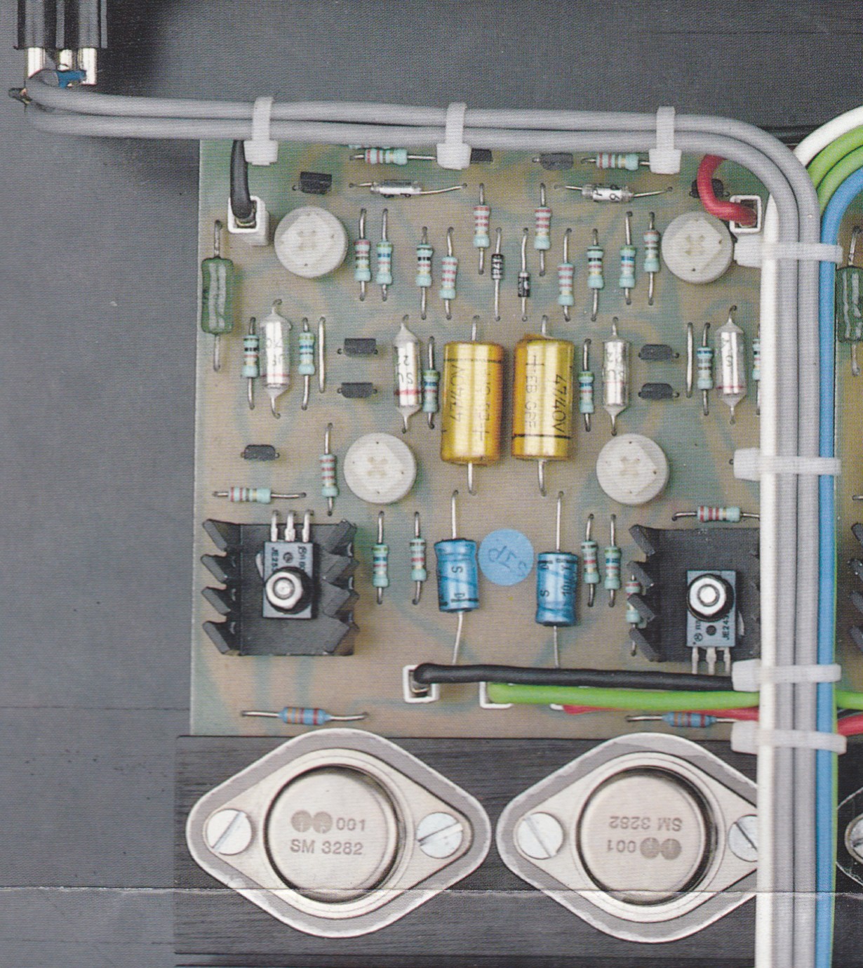

Exept of the input transistors (BC239 selected, usually marked) all other small signal transistors are e-line
the photo I have of a NAP 110 shows a mix of E-line and TO-92.
The power transistors are custom made for Naim … Julian Vereker said he wanted a fast, but not necessary super linear transistor

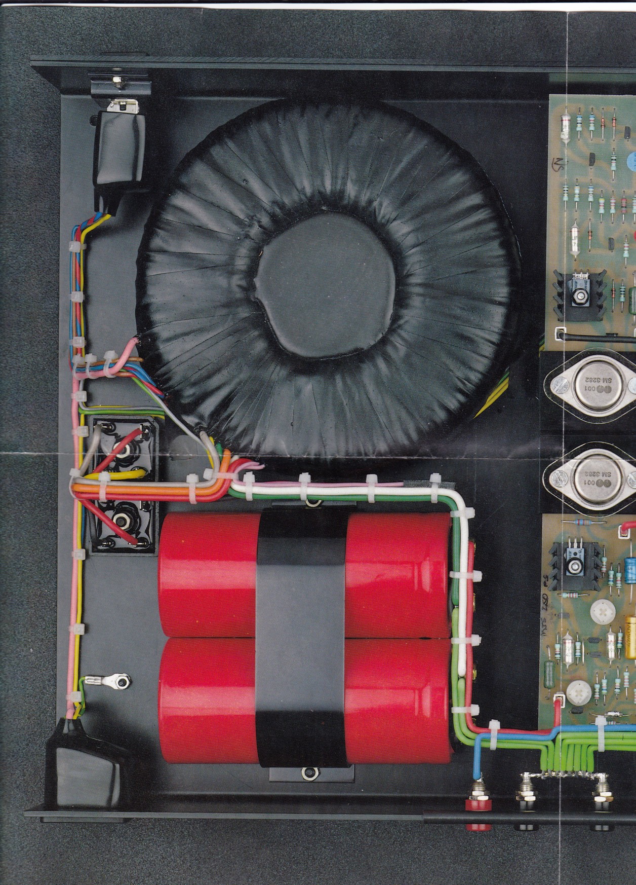

A few more details, which I have not mentioned yet:
Behind the supply wires there is the zobel cap hidden (100nF, MKP) and the second ground wire for the zobel (green). The red one is the obvious positive supply wire and the black negative one is barely visible. Also hidden behind those wires there are two diodes, parallel and close to the output transistors in inverse polarity. Naim used FR105 diodes here, as far as I can remember, fast diodes as safety for the fast transistors and to suppress the switching spikes to reduce output distortion, I assume.
One of the things people seem to hate with these amps are the tantalum caps in the signal and feedback path. Many people, professional designers as well as diyers seem to avoid that like the devil shyes holy water. But strangely again: the amps sounded good - nevertheless.
Interestinglythere were no stabilizing caps on the power amp board, not even the minimum foil-caps. The only caps on the regulated rails are a Philips BC elcap with 10uF/63V on every power supply output, situateted on the power supply boards.
The star ground for the whole amplifier is at/between the minus output sockets.

What's interesting is that the photo in post #3 of a NAP 110 shows a TO-92 device in place for the VAS ?

Please note that most of the Naim amps used full-wave rectification, the 500VA transformer has two centertapped windings and the two bridges use only two diodes per voltage side.
I remember haven compared that layout (together with some friends way back in the eighties) to a full- bridge rectification, but we all liked the full-wave setting much better. Maybe less diode/switching noise?
Indeed! Quite possibly the part used there is BC640 which has a very high Early voltage factor (VAF =144) and high current gain (BF=185)as seen in the Siemens SPICE file.

Early effect is a phenomenon where the width of the base is affected by the voltage by the voltage applied to the collector in a common emitter amplifier - a common description is base width modulation. It is more of an annoyance if anything but you would minimise the impact if you can.
"Quite possibly" - are you making a hint because you have seen this part or is this a wild guess ? 😀

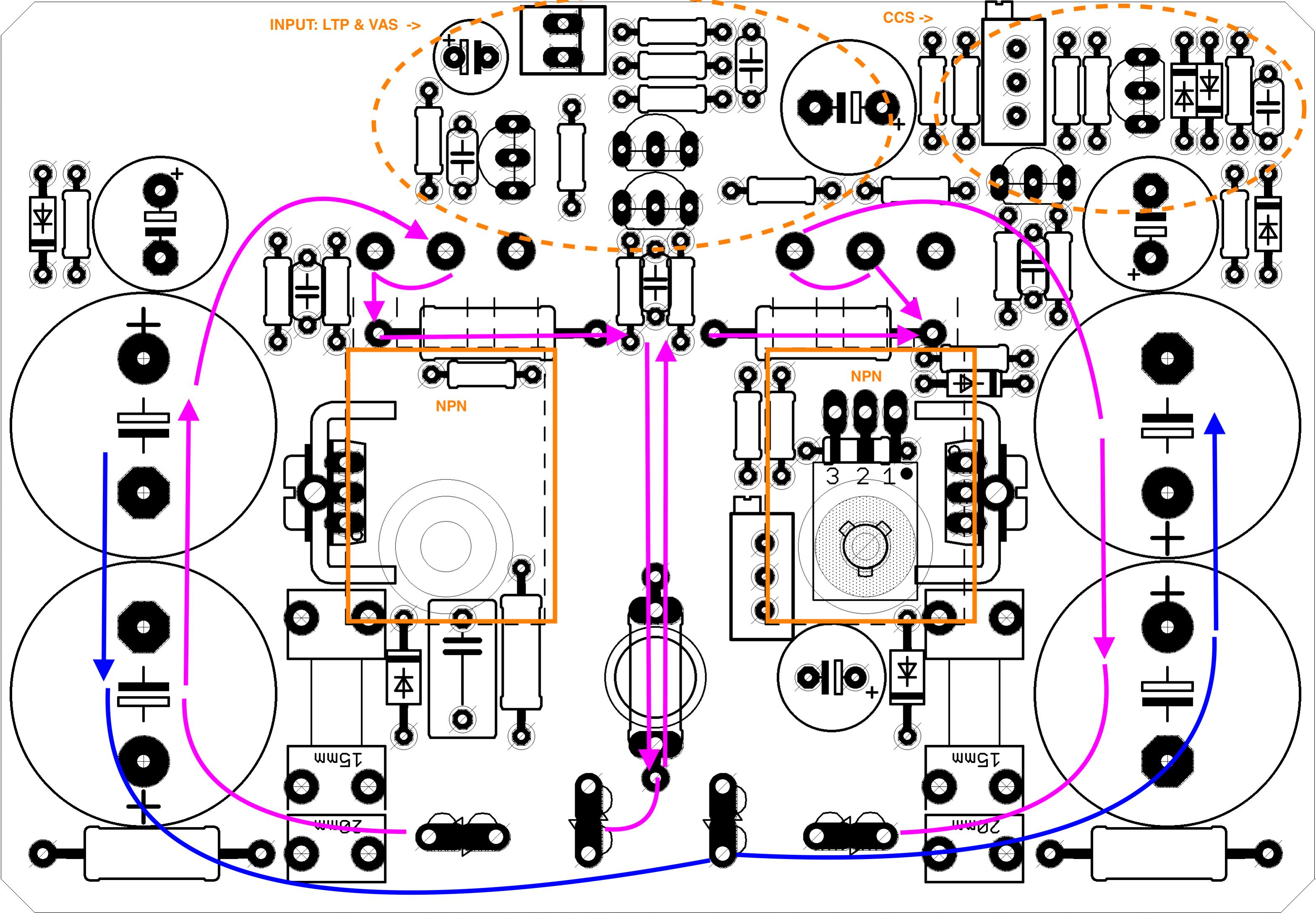

PCB
I've imposed a few constraints on the pcb layout which will likely displease many of you 😡
I have some boxes to use for this amplifier with heatsinks drilled and tapped. The power devices need to go where the tapped holes are and the pcb has to fit over the top of them. The good news is that I've already built 3 different amplifiers with these constraints and they all turned out just fine.

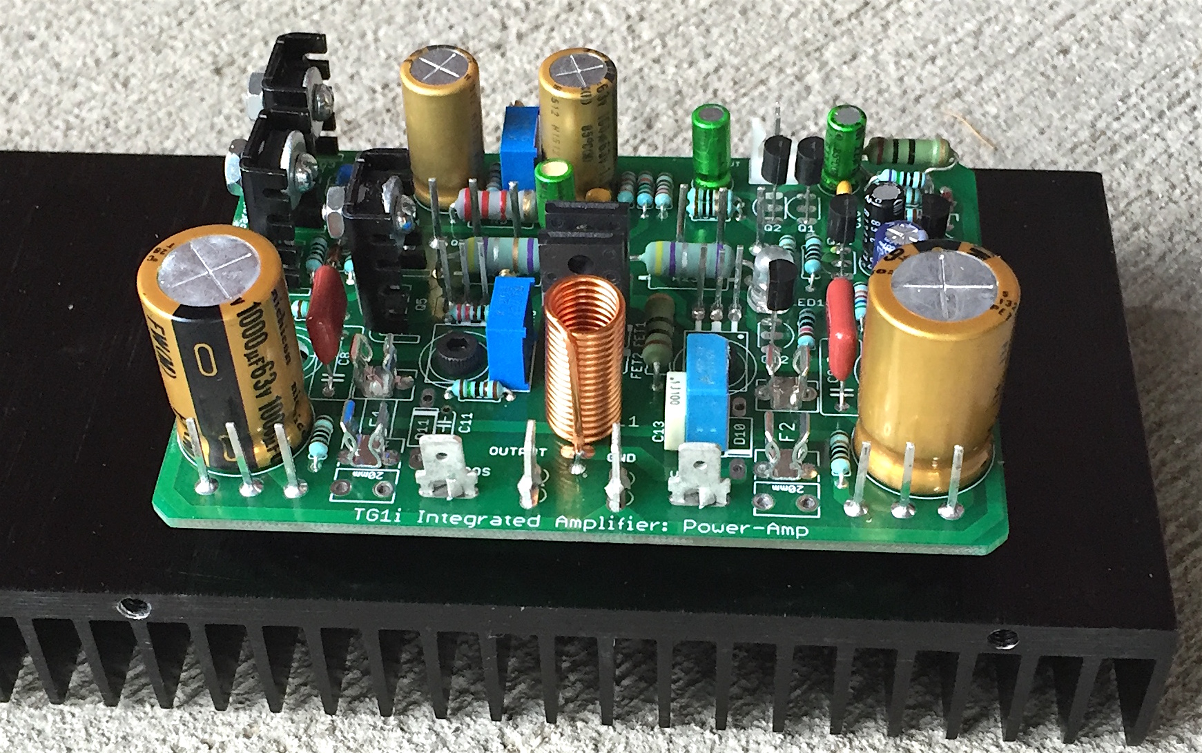

Photo is of my last project, TGM1i, essentially the AKSA 100 power amp. I'm going to use the same size pcb so this photo gives a good indication of what I have in mind.
The sketch up I've attached shows where the major items are for my Naim clone layout. Rail caps on each side. Power devices underneath. The drivers with their own heatsinks are placed close to the output power devices. The output inductor and zobel near the centre at the lower edge and the sensitive input circuity at the top edge.
