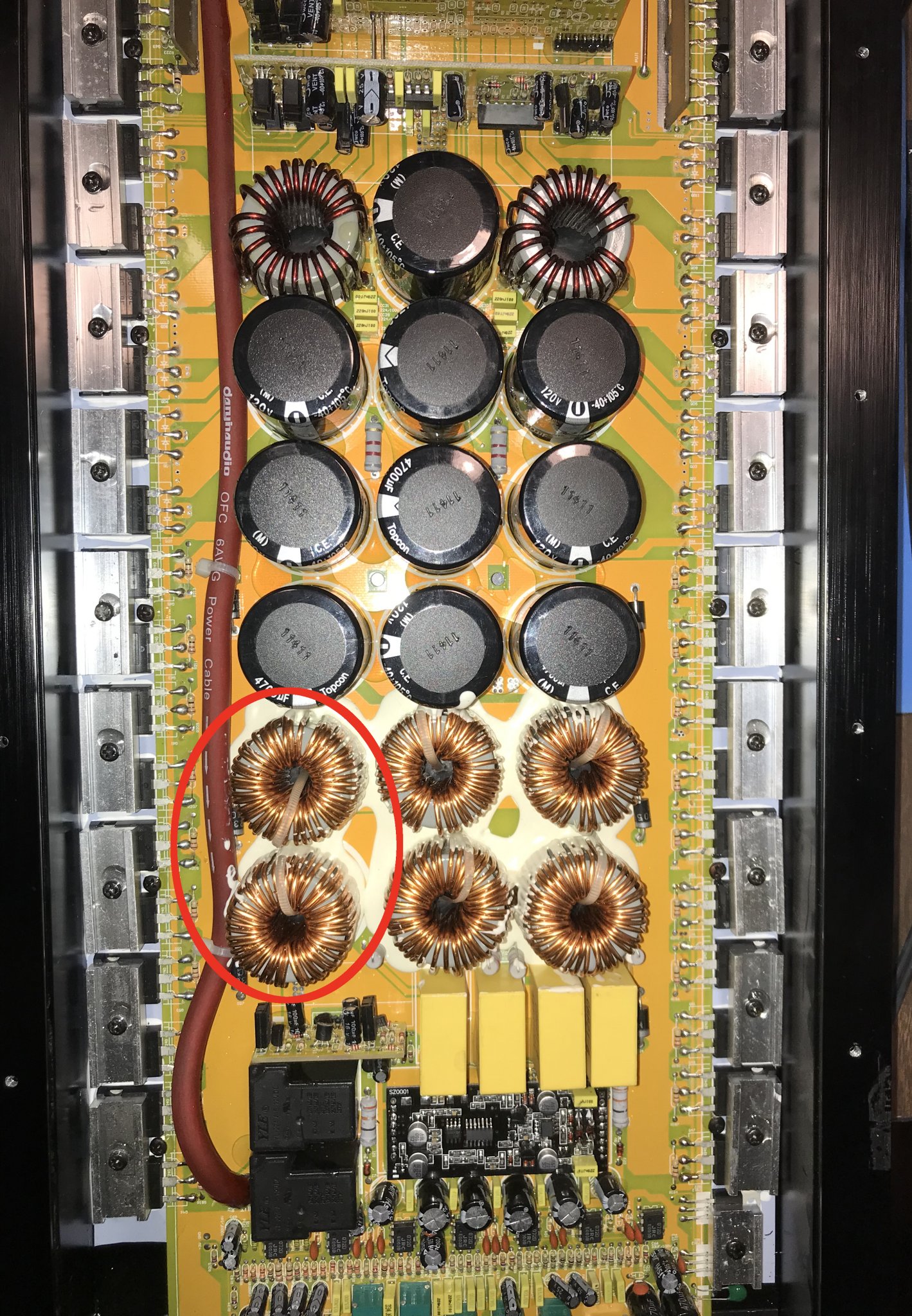

Hi Perry, I did the pull/push/tap test and the amp kept running, BUT I noticed something.
Two of the output inductors are not carrying switching current. While the four that are not circled get warm the other two stay absolutely stone cold. I could also verify no current by sticking my probe into the center of the other four that there is current, incuding the carrier, but the lower two has nothing.
Thoughts? I would really prefer not to pull the amp out of the heatsink in order to trace their connections. They seem solidly connected while pulling/pushing them.
Can you drill down through the insulation with your scope probe (or scratch it slightly) on the windings to see if there is any oscillation?
Do this (if possible) on the 2 terminal windings on each of the cold inductors.
There is no oscillation on those two. I will have to pull the amp apart to look at the bottome side what is going on.

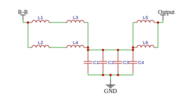

Here is a representation of the circuit. The filter formed by L1-L4 and C1-C4 works really well, with only a low amplitude triangle wave remaining from the R-R Oscillation, as expected. If I had adjusted my vertiacal scale correctly, I would have seen the triangle wave on the input side of L5-L6.
In summary, there is no fault in the filter section of this amplifier.
