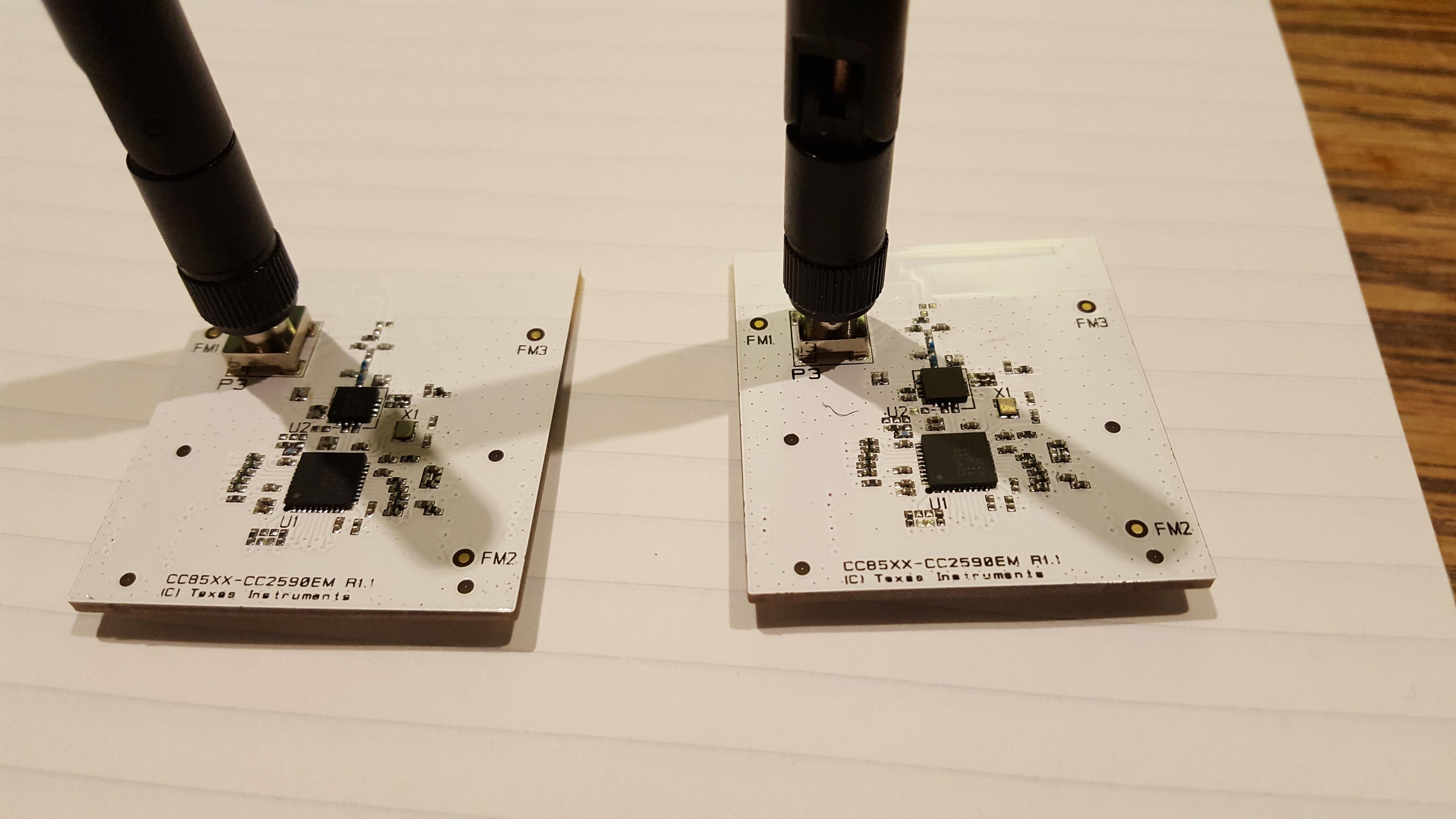

OK, one small step...
Tadaa! Two working boards, based on the tried-and-tested toaster oven method.
Well, working...: I managed to program them using CC debugger.
First board I completely blew (delaminated while trying to fix a solder bridge; not posted here as not good sight for the faint-of-heart); second attempt I put a 1cm thick ceramic tile under the board to better distribute the heat which seemed to do the trick.
So these two seem to work nicely; see pic attached. But boy, is 0402 small indeed. Now onto my second board I can populate one in under an hour I think.
So next is to put one in my subwoofer, probably going to use a TDA1543 for D/A conversion initially (to make life easy). Making my subwoofer (P68 ESP based, 64-liter sealed cabinet) 'mobile' with just the power chord attached to it has been my main aim with this purepath attempt.
The feed/master could have been USB-based, but unfortunately had no CC8530 lying around from when the TI Samples program was still (overly) generous.
So now going for S/PDIF. Should be ok.
Will keep you posted!

Had some range issues on the first pair, would only cover 2 meters line of sight.
Now am at 10 meters, no line of sight.
Have 5 boards ready: 1 master, 1 master pair speakers, 1 smaller pair speakers and two... well. We'll see.
Thinking about swapping the CC2590 range extender with a CC2591 which should give another 8 dBm of oomph. Will post back once tested.
But, for now, you are reading a happy camper's post 🙂

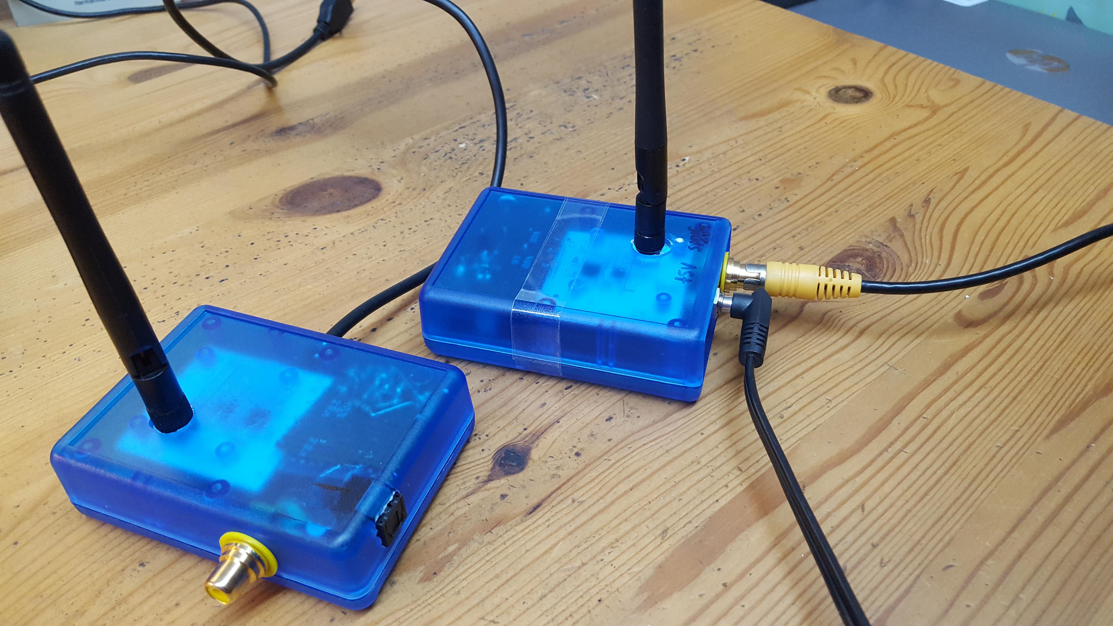

Quick update
Hi, have advanced bit more and are now reaching up to 15 meter, through interior walls.
Have to admit I swapped the CC2590 for the more powerful CC2591, and that made all the difference.
See picture, have now a set in use: master takes S/PDIF from television, slave sends S/PDIF to DAC.
Stereo only (I do not have a surround setup).
Only challenge now is: I need to have a second slave to go to my subwoofer, but how do I keep the volume levels in sync... thinking about a relay-powered stepped attenuator controlled by ESP8266 over wifi... Need to think about this a bit more.
