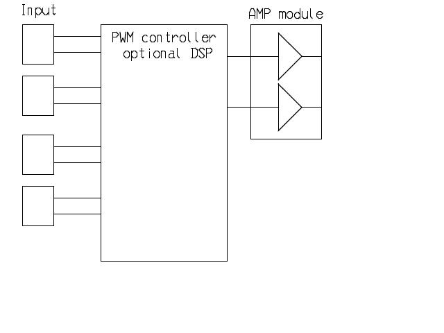

Hello Sproggit,
You're right it will be a standalone concept. Based on TAS5518 and TS5261. The inputs of the system will be modulair boards (analog or digital inputs).
All the sub systems are already tested all I need to do know is to redesign it into good workable modules. See it as a base board with the amp modules plugged onto it. The input modules are changeable so you could decide for yourself what type of input you like.

We all here have the good TAS5261 board designed and produced by Brian (member BRWX) in a small group buy.
I think we all are interested to TAS5518, as the pcb mentioned has connectors for an external module like this.
Why not then only a TAS5518 module?
DSP for digital 2-3 ways crossover would have a larger audience, and would alone rise interest for a pure digital source.
Take a look to this thread. A guy here completed a whole digital chain, but with analogue XO.

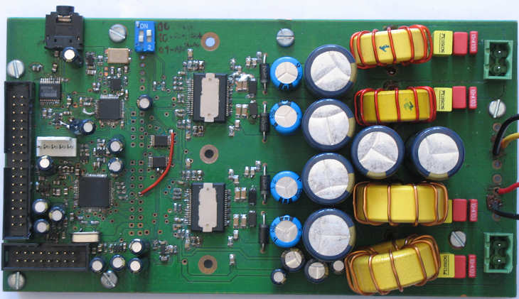

my project
after seven months, here is my TAS5261 stereo amplifier.
I made the pcboard in protel.
It has an analog input with PCM1802 converter and TAS5010 PCM/PWM converter. It has also the original tas5518 design from TAS5518-5261K2EVM. And a direct PWM.
With analog input it works fine, but the channel with bigger coils does have very big attenuation on the signal. One day I'll replace the coils.
On the "good" channel, the second order THD is about 69dB... not bad.. I think.
Hope you like it 😛

Wow 😎 😎
Do you mean there is TAS5518 on-board and 4 pair of digital I2S inputs?
Congratulations!
Can you post a higher resolution picture?
Congratulations!
yes, but i did not test them. this board is a 1/3 part of a final course work. i did not needed the S/PDIF input, so i did not test them and did not had the time for it, but my teatcher wanted the S/PDIF too.
I can't post a better pict because the maximum file size is 100k. Sorry.
But if you want, i can send for you email 🙂

The PS is just a laboratory PS 🙁... did not had the time.
I'm programming the FPGA... this is the part 2. The part 1 was the DSP that i think is done.
