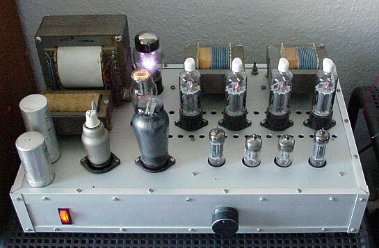

I am quite a tetrode lover. Which always means - beam power tetrodes. "Classic" tetrodes aren't being used anymore since many years. Even the first types quickly were built as "tetrodes with critical electron distance" - which just meant that there was enough space between screen grid and plate to push all secondary electrons back to the plate by collision with primary electrons - and thus preventing the absorbtion of the secondary electrons by the screen which caused the instabilities of "classic" tetrodes. Supressor grid was replaced by a space charge between screen grid and plate. Beam-forming electrode in BPTs simply contributes to this effect by focusing the primary electrons and thus increasing space charge.
Many of the non-linearities of earlier beam-power tetrodes (and pentodes, too) could be removed by reducing the screen grid current as far as possible - by placing the screen grid in the "shadow" of the first grid. So the screen grid wires were touched only marginally by the electron beams passing through the first grid. Additionally, a low screen voltage does contribute to this effect.
So today, if you compare curves and screen current, you'll almost always see that the most linear types are those with the lowest screen current, too - usually much less than 1/10 of the plate current. And I found that this contributes very much to sound quality - tetrodes and pentodes with "non-shadowed" screen (as EL34, 6L6 ....) need to be run in triode or ultralinear mode to sound really well - the "shadowed" types (all sweep tubes) even sound well in classic tetrode/pentode mode.
And if such a tube is fed with a stabilised screen voltage with its AC potential equal to the cathode, then you'll get a very good sounding and very effective amp. I did it this way with my EL36-amp. I tried EL34, then 6L6 (both did sound quite rough. 6L6 even worse than the EL34), then I took 7027A, which was wonderful. Seemd to me to be a "shadowed" version of the 6L6 when looking at its construction. When one tube failed (they were hard to get that time in Germany), I replaced them by the EL36.
Greetings
Uli

Btw - the AL 4 I use in my EL 36 amp is also built as a true tetrode - with critical electron distance.... It is the black "coke bottle" on the left side used for screen and pre-stage supply stabilization.

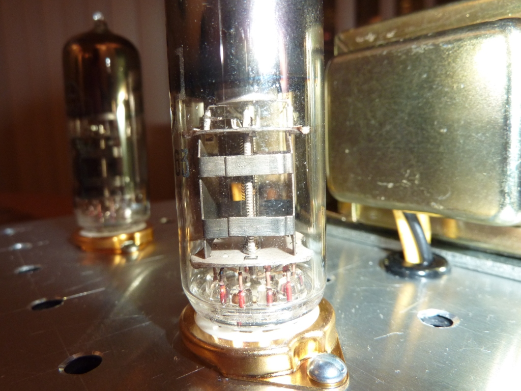

There is a wierd russian tube called 6E5P. It is a pure tetrode. What strikes me is the huge distance between g2 and anode. I guess this is done to reduce a kink.
I used this tube in my headphone amp (triode mode). Works well so far. Have not tried as an output tube yet, but there are some projects around on internet using 6E5P as an output device.
I think the orientation of the 'suppressor' plates in a 6BZ6 is less important than their size and position - just on the edge of the electron stream. They will tend to concentrate the stream, yet will have little direct suppressor effect in the centre of the electron stream. I agree that the wide spacing to the anode reduces the need for secondary suppression.
The 'opening' in a conventional beam former is the gap between them.
